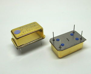

Ditch the 2-pin crystal for an oscillator module. 1 can + power.
