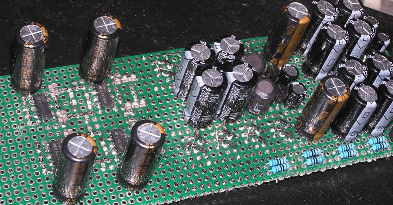

<edit> Attached a pic of my most recent AXO build - this is a stereo, balanced 3rd order using TL084s (totally 16opamps). The largest NP0 caps are 10nF (in this case made of two paralleled 4n7s). The discrete output buffers are using SOT-23 transistors in the central part of the PCB.
I'd suggest not driving the outputs direct from the opamps rather use some discrete transistor classA buffers - also easy and very cheap.

Thanks for your interest in my build - incidentally its using TL431s to power the opamps and the output buffers.
