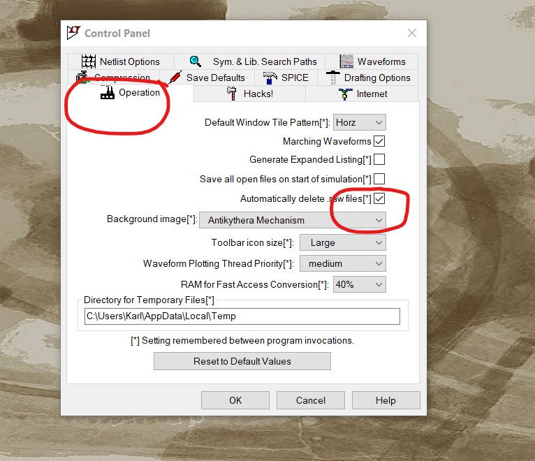

There shouldn't be any rogue files if you have ticked the option to delete them

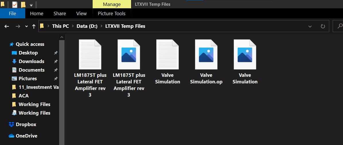

Do you not find any files left over like that delete automatically once you run any simulation again...

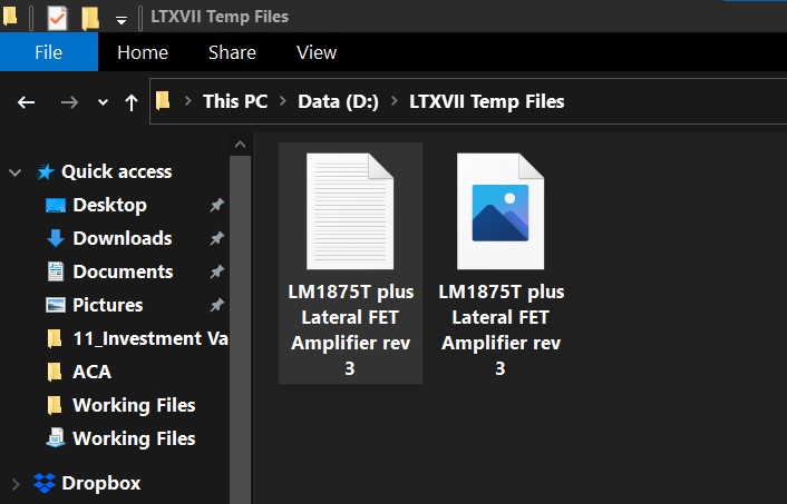

Just trying it now for curiosity... closed LT before sim had run and I can see two leftover files. When a sim completes there are normally three plus one text file in the original sim folder.
Running a different sim now and I see the expected temp files.
Now closing the sim... and the original two are still there. Hmmm 🙂
Lets run the original sim now and see if they recreate and delete... and they do.
Interesting. So it seems you have to rerun the original sim to get them to delete on there own.
