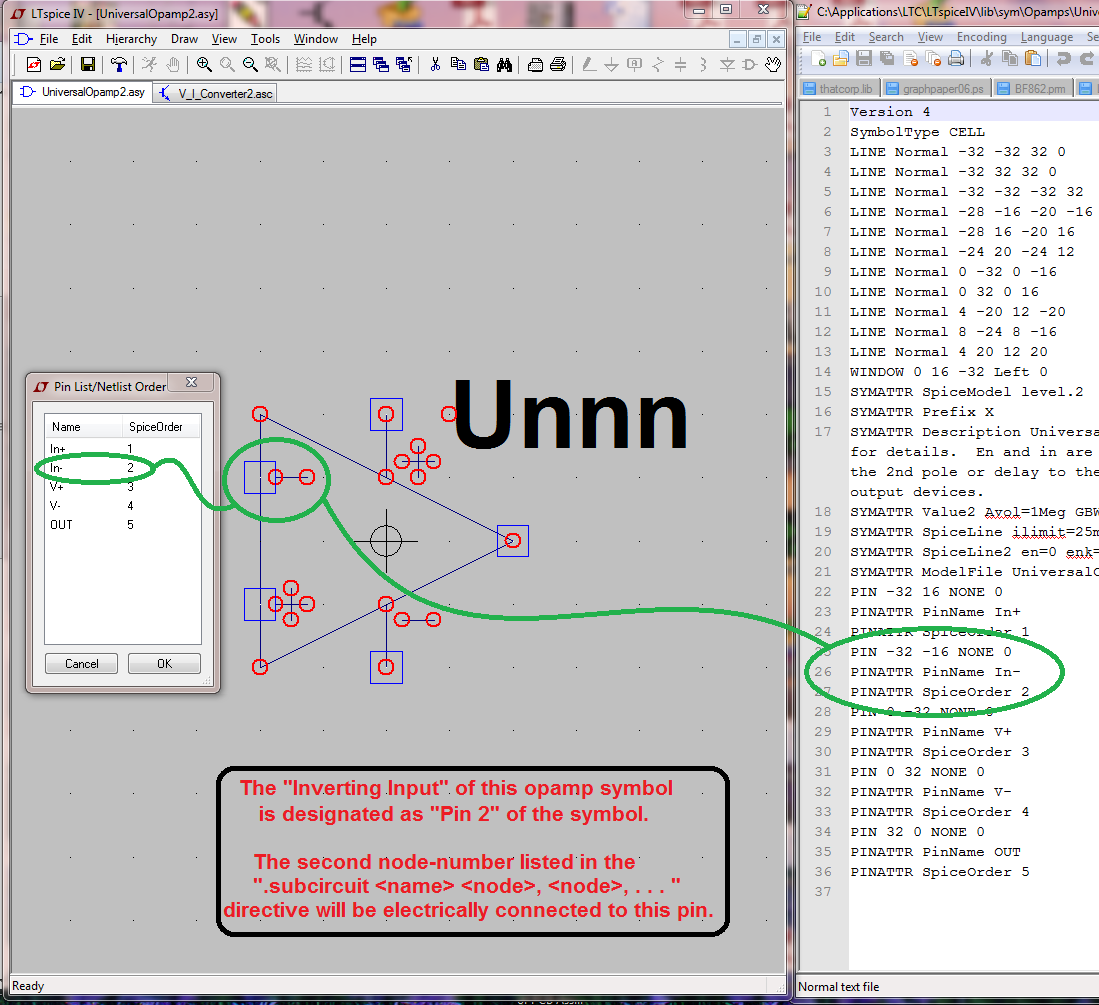

Are you familiar with the programming concept of "variable scope"? There's a similar idea at work here: the NODE NUMBERS used in a subcircuit model have meaning ONLY within that subcircuit. (Except for node "0" (zero), the global "ground node".)
And then there are three different abstractions related to the component, correlated to each other, but not necessarily in a straightforward manner. These are:
The first line of the subcircuit definition specifies the pin mapping. After the SPICE directive (".SUBCIRCUIT") comes the subcircuit's name. In your example the name is "AD797S". Then comes a list of node numbers that apply ONLY within the .SUBCIRCUIT definition. The simulator assumes the SCHEMATIC SYMBOL's pin number "1" is connected to the first node number in the list (in your case, node "1"). In your example, schematic symbol pin 2 is connected to subcircuit node 2 . . . but schematic symbol pin 3 connects to subcircuit node "99"!
You can verify the SCHEMATIC SYMBOL pin designations by opening the symbol's "*.asy" file. You'll find most of the symbols in the " ..\LTspiceIV\lib\sym\ " directory. If you open the *.asy file in LTSpice itself, go to the "View" drop-down menu and select "Pin Table". There you'll see the pin designations for the schematic symbol. You can also open the *.asy file in any basic text editor. Each pin has an associated "SpiceOrder" attribute, which tells you the pin's designation in the schematic symbol. See atch screen captures.
The standard LTSpice "Universal Opamp" schematic symbol has 5 connection pins. Your subcircuit model for an AD797 lists 6 node numbers. The first 5 node numbers in the subcircuit model agree with the pin order used in the schematic symbol, but you will have to come up with a symbol that has 6 connection pins.
- The PHYSICAL PART, whose package may have connection pin numbers assigned in a standardized way.
- The SCHEMATIC SYMBOL which implicitly or explicitly identifies connection pins by their function ("inverting input", "ground", etc). In LTSpice, the physical part's package pin numbers almost never appear on the schematic symbol. (You can certainly add package pin numbers to a schematic symbol if you are so inclined, but these numbers placed on the symbol graphic have no relation to the subcircuit nodes.)
- The SUBCIRCUIT MODEL used for simulation, whose node numbers have meaning only during the simulation.
Dale
