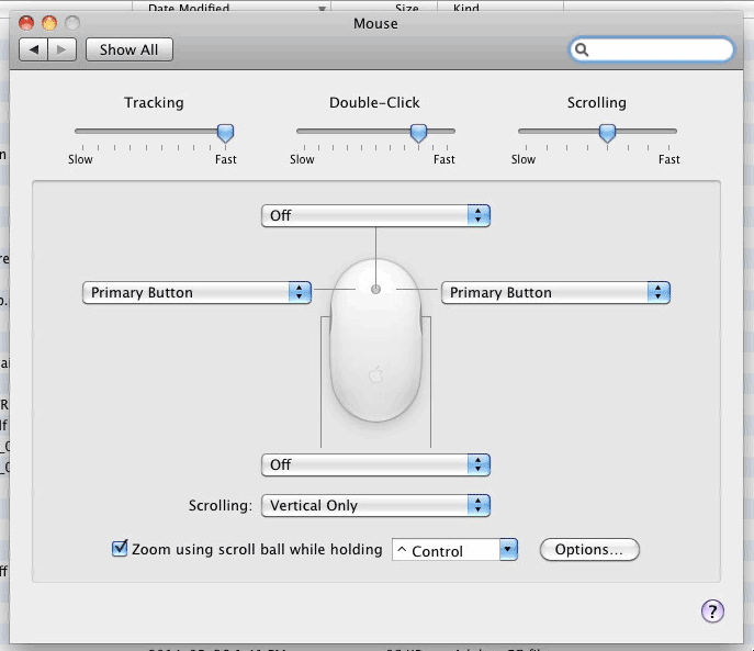

This is from my last generation wired mouse.
attachment.php
Can be set up with up to 4 buttons.
dave
