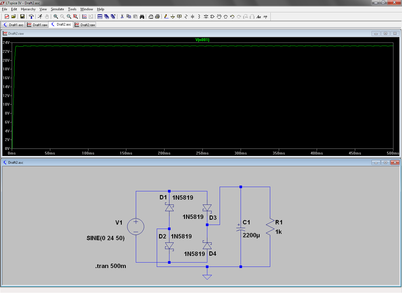

This is a simple question, but at this hour I can't figure out what I'm doing wrong.
I'm using LTspice to simulate a simple rectifier circuit using a sine wave generator (24 V, 50 Hz), a full wave diode bridge, a reservoir capacitor (2200 µF) and a load resistor (1k).
I was expecting to see approximately 24 * sqrt(2) - 2 * 0.65 (diode drop) = 32.5 V, across the load resistor (plus some ripple).
Instead, I'm seeing 23.3 V.
What am I doing/thinking wrong?
Screenshot attached.

24 V is the amplitude of the sine source - ie the peak values are +/-24 V
you have to multiply your argument in the sine source parameter list by sqrt(2) if you want "rms"
Yoiu should enter the PEAK value for the sine's AMPLITUDE field, in the AC voltage source, not the RMS value.
Yes. The entered value shows 24V which is the peak value. For 24VRMS he should enter about 34V peak (or 24V RMS; not sure you can spec RMS in LTspice).

Well, of course. Thank you! 🙂

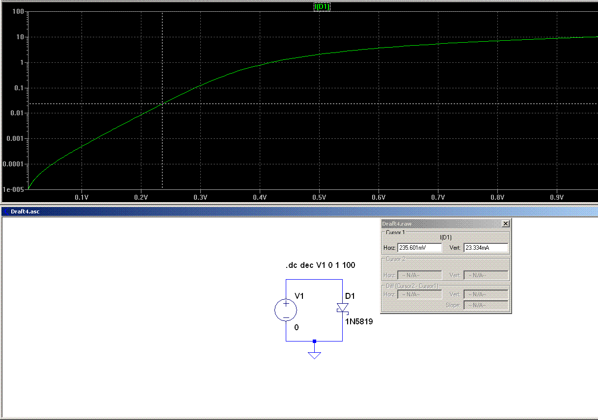

Probably because those are Schottky diodes, and because the current is quite low. Forward voltage drop is a function of the forward current.Why is LTspice reporting one diode Vdrop?
24Vpk and 23.3Vdc equates to a 700mV Vdrop?
I'm sure Spice aficionados can chime in here, but I'd prefer to say that "the model used for the diodes result in a 350mV drop at 23.3mA". LTSpice isn't really reporting the voltage drop across the diodes. It uses whatever the model tells it to.
yes, we agree.I'm sure Spice aficionados can chime in here, but I'd prefer to say that "the model used for the diodes result in a 350mV drop at 23.3mA". LTSpice isn't really reporting the voltage drop across the diodes. It uses whatever the model tells it to.

You can easily plot the characteristic of any component in the library:so that means the simulator is reporting 350mVdrop for each diode passing 23.3mA.
Correct?
