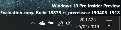

I think its going to be a Linux thing by the sound of it. The 'restore down' button appears on pretty any Windows program/screen/application.
I'm running XVIIx64 under 'Skippy' which is the latest W10 development build from the skip ahead preview ring.

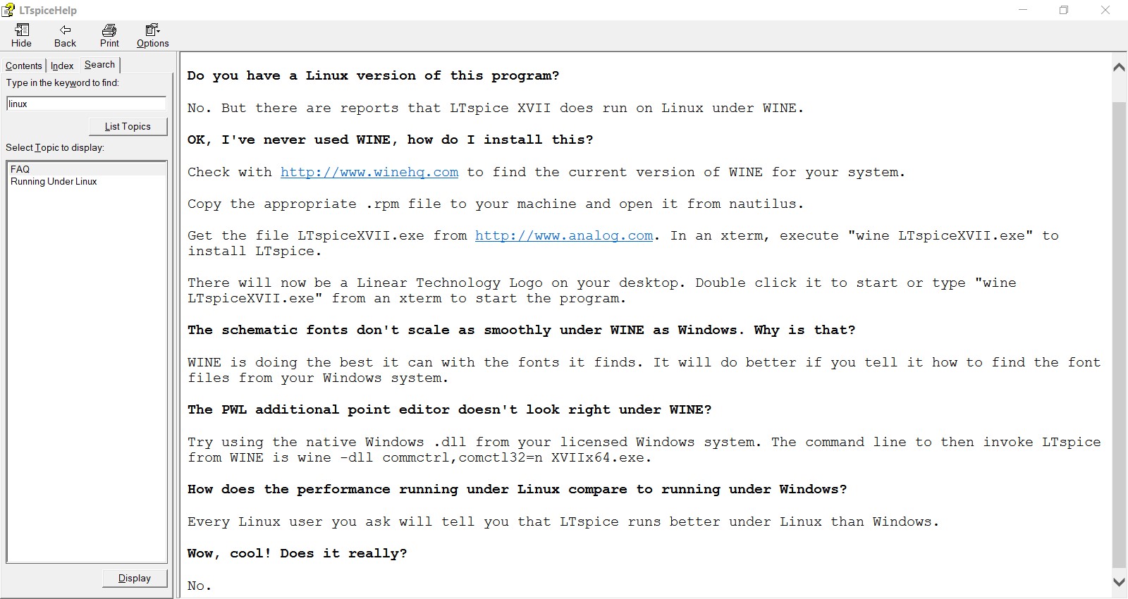

This is from the help files built into LTspice.
