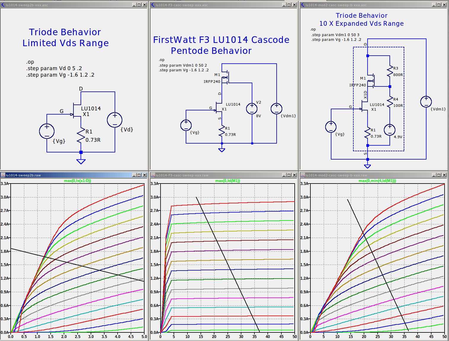

I have been looking at the LU1014D cascode behavior and found an interesting "modulated cascode" circuit that preserves triode behavior and expands the Vds (and power) range of the composite SIT-like device.
The LU1014D has triode-like (SIT) behavior but suffers from a 24V source-to-drain voltage range and limited power dissipation capability. These limitations can be overcome by cascoding the device as in the FirstWatt F3 and more recently the LuDEF (https://www.diyaudio.com/community/threads/ludef.369990/post-6588632) and the LuFo Amp (https://www.diyaudio.com/community/threads/lufo-amp-39w-se-class-a-from-28v-rail.372679/post-6665040). However, all of those cascode circuits result in pentode behavior of the resulting circuit.
The three columns of the image below show:
- The LU1014 degenerated by 0.73 ohms source resistor, showing triode behavior.
- The LU1014 cascode of the FirstWatt F3, showing pentode behavior because of the constant voltage cascode.
- The LU1014 with a "modulated cascode", showing triode behavior almost identical to the degenerated LU1014, but over a 10X expanded Vds range.

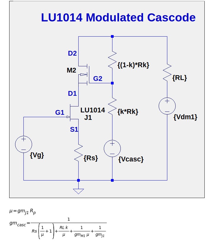

The small-signal behavior of a SIT can be expressed as:
ΔId=gm*ΔVgs+ΔVds/Rd, where Rd is the drain resistance (counterpart to triode plate resistance).
1/Rd can be thought of as a transconductance relative to the drain to source voltage.

Here is a way to compute the "extended-triode" transconductance:
https://www.diyaudio.com/community/threads/ld1014-spice-models.70008/post-867655Would you mind sharing the lu1014 model that you're using? I've seen a few models out there, but I'm not sure how reliable they are. Many thanks.

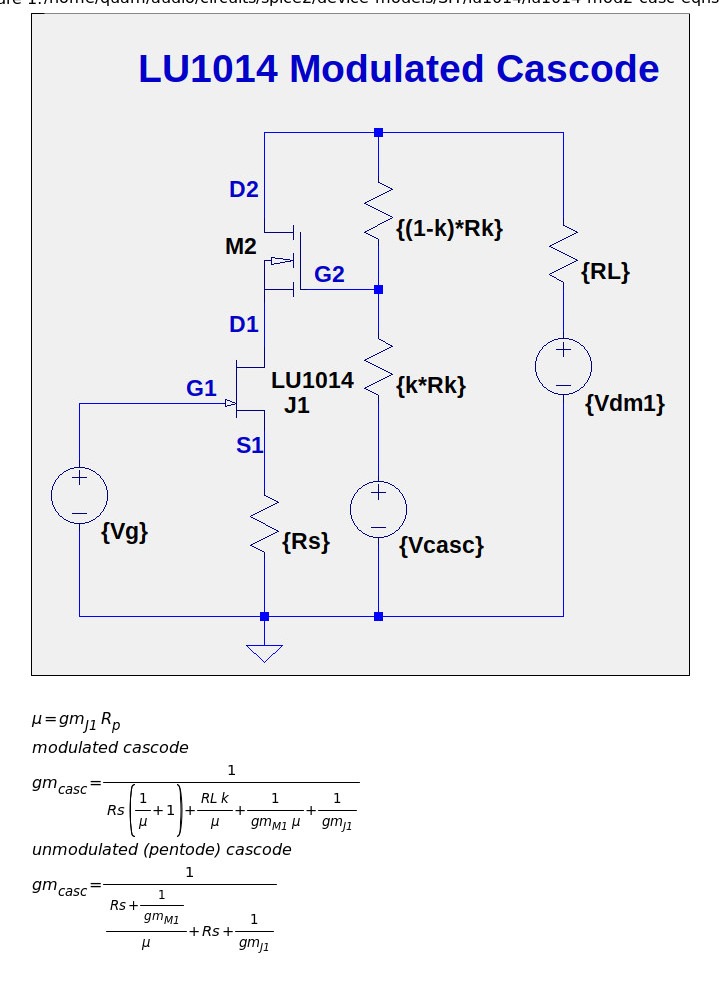

In my previous post showing the "extended-triode" transconductance, I forgot to include the equation for unmodulated (pentode) mode:
I do not know if there is any gain. I thought it was an interesting way to extend the Vds range of the LU1014D while maintaining the triode behavior.
The "normal" cascode with pentode behavior has an interesting property I had not considered; it presents a (nearly) 0 ohm load line to the LU thus making the LU insensitive to the load impedance seen by the cascode.

What are the gate-voltage steps in these curve sets? It's probably in the SPICE diagrams, but I don't speak SPICE...The three columns of the image below show:
The black lines show 8 ohm load lines.
- LU1014D Modulated Cascode
