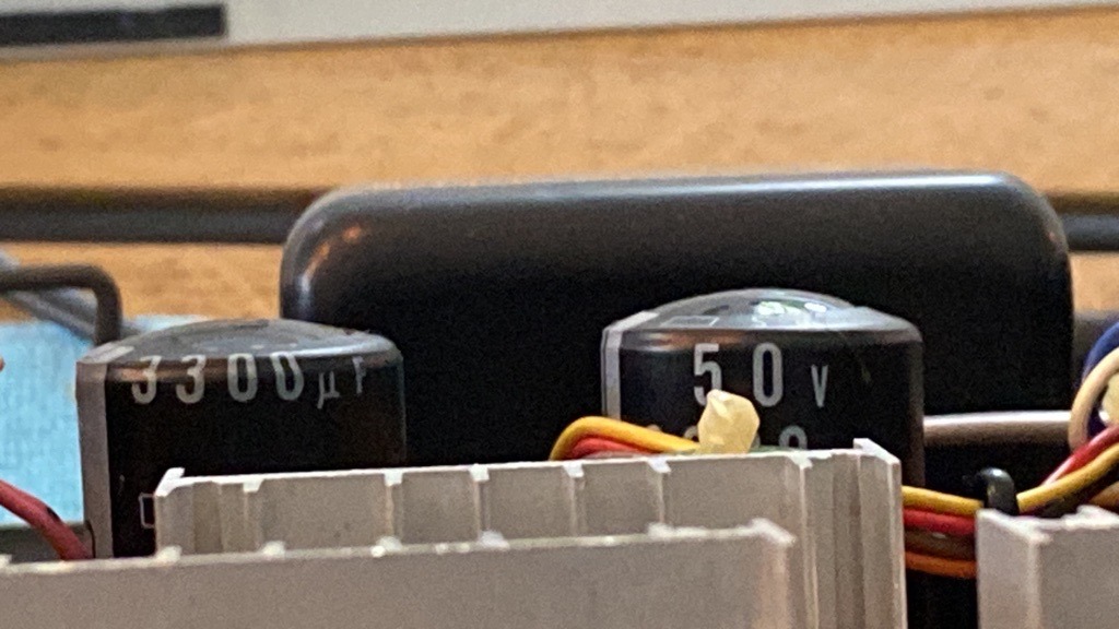

Maybe there is nothing wrong with the power supply capacitors.Hi y'all.

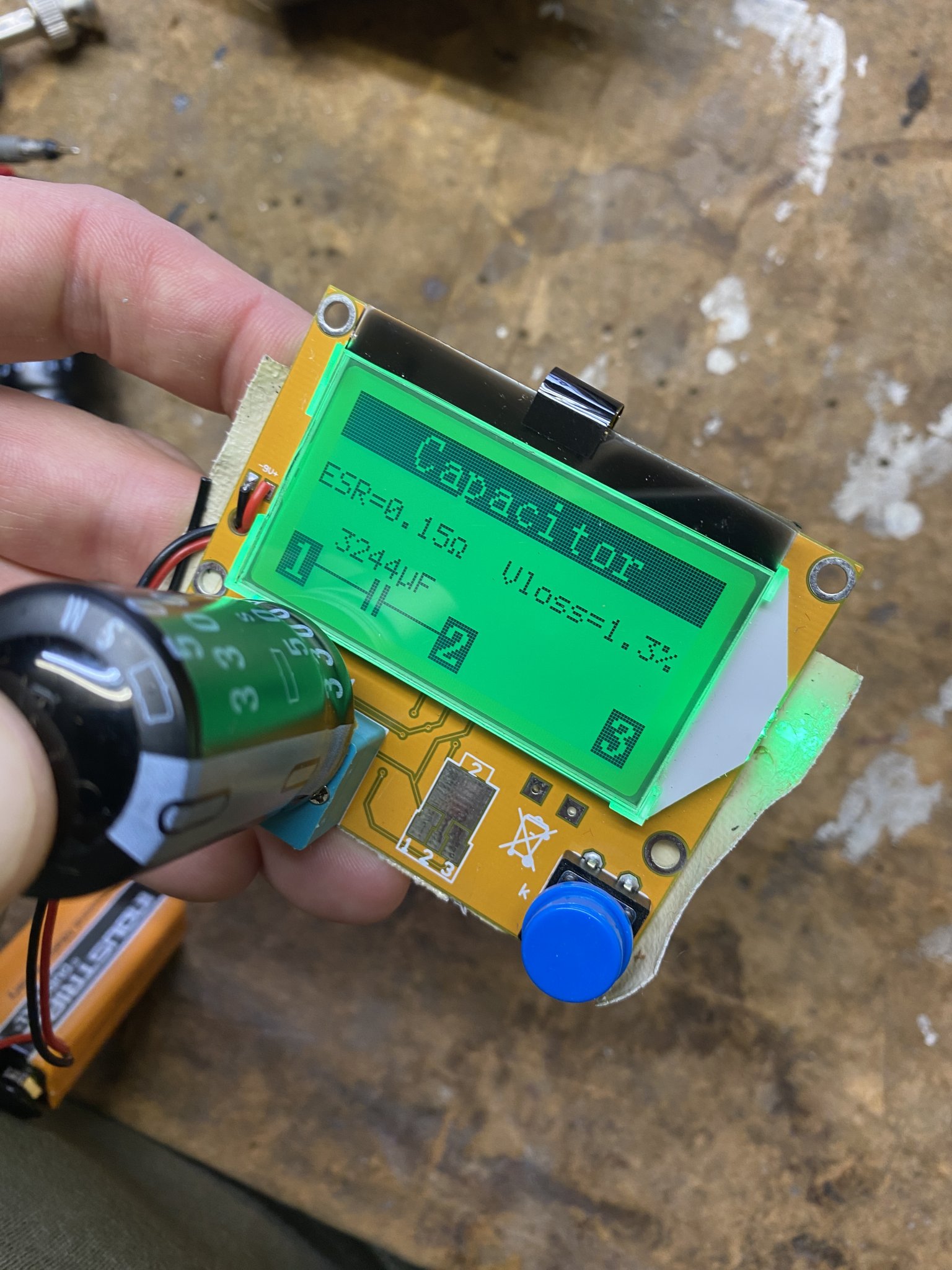

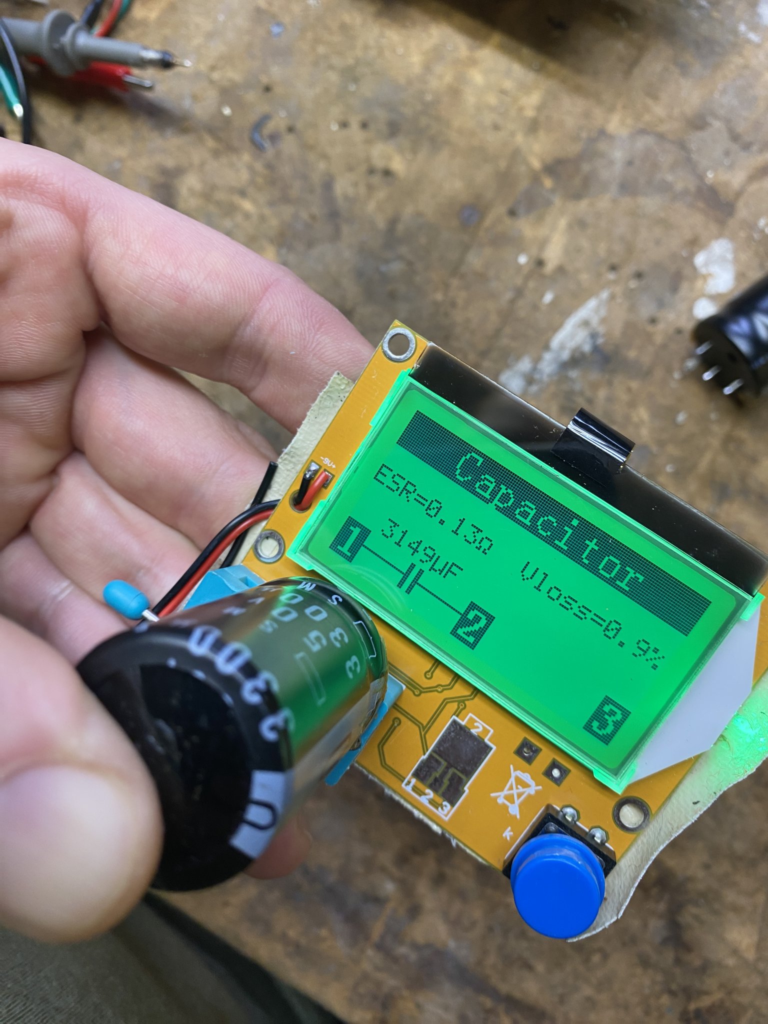

They look like they are bulging, could be only the plastic top cover that is deformed, as mostly is the case.
Before replacing these I would check them with a good capacitor meter.
Will check later on! But is this relevant? As I’ve only replaced these power supply capacitors?I am going to answer you because you have shown perseverance with your PMA 2000.

Could really be true! Check these measurings… but why are they bulging then.. might be a last warning? …Maybe there is nothing wrong with the power supply capacitors.
Aside the originals being good/not good. Are the replacements any good?
I have seen the bulging of the plastic top plate of these capacitors many times, the capacitor itself being perfectly flat.
I think it is caused by the higher temperature inside the amplifier.
I do not think it damages the capacitor.
Recapping sometimes can change the sound of the amplifier.
I only replace electrolytic capacitors if they are really defective.
I have tested 40 year old ones that measured better than new ones!

I would rather expect 0.05Ω ESR from an old but good enough 3300uF/50V. This type of component tester isn't as precise for ESR as dedicated 100kHz meters nonetheless. For example on one same tester I just tried a 1000uF/25V Nippon Chemi SL pulled from an Akai tuner made in 1979. Reads 986.1μF 0.00Ω ESR and 0.8% Vloss. This capacitor returns a more realistic 0.045Ω with a Bob Parker's Blue2 ESR meter.
As a conclusion do compare alike known good caps on this component tester finding what to expect as passable for the questionable caps ESR readings.
