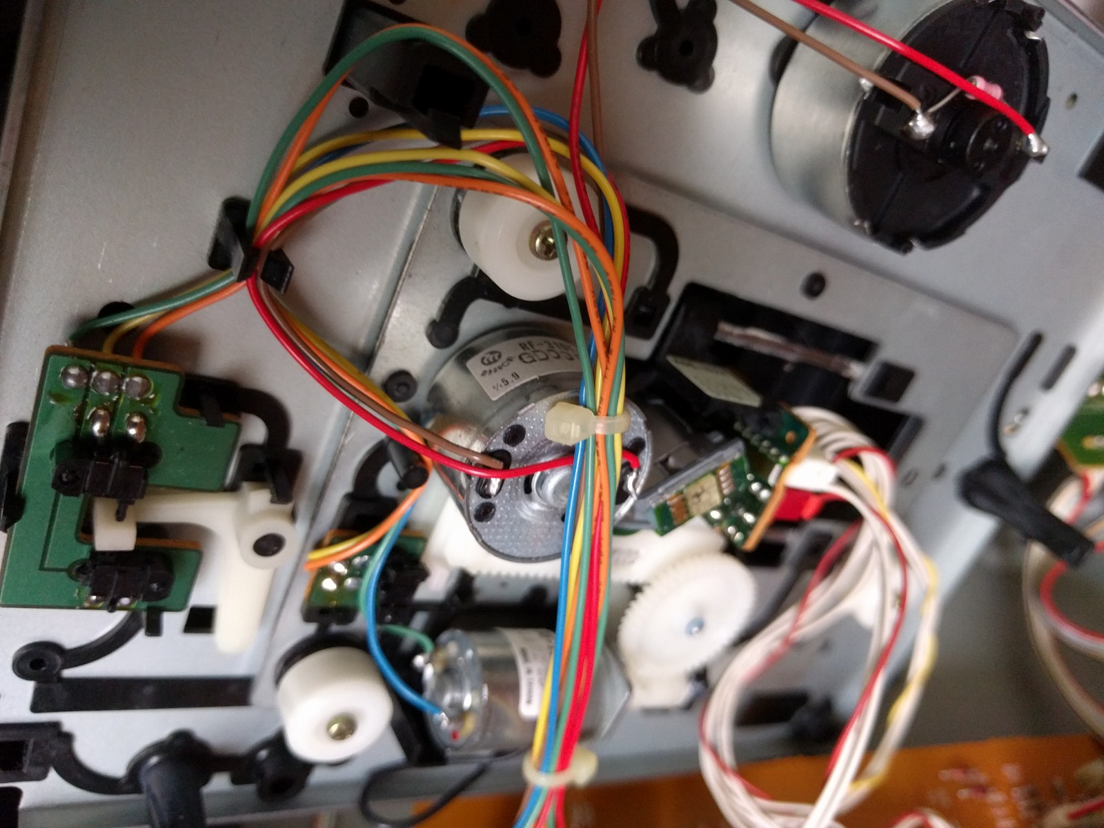

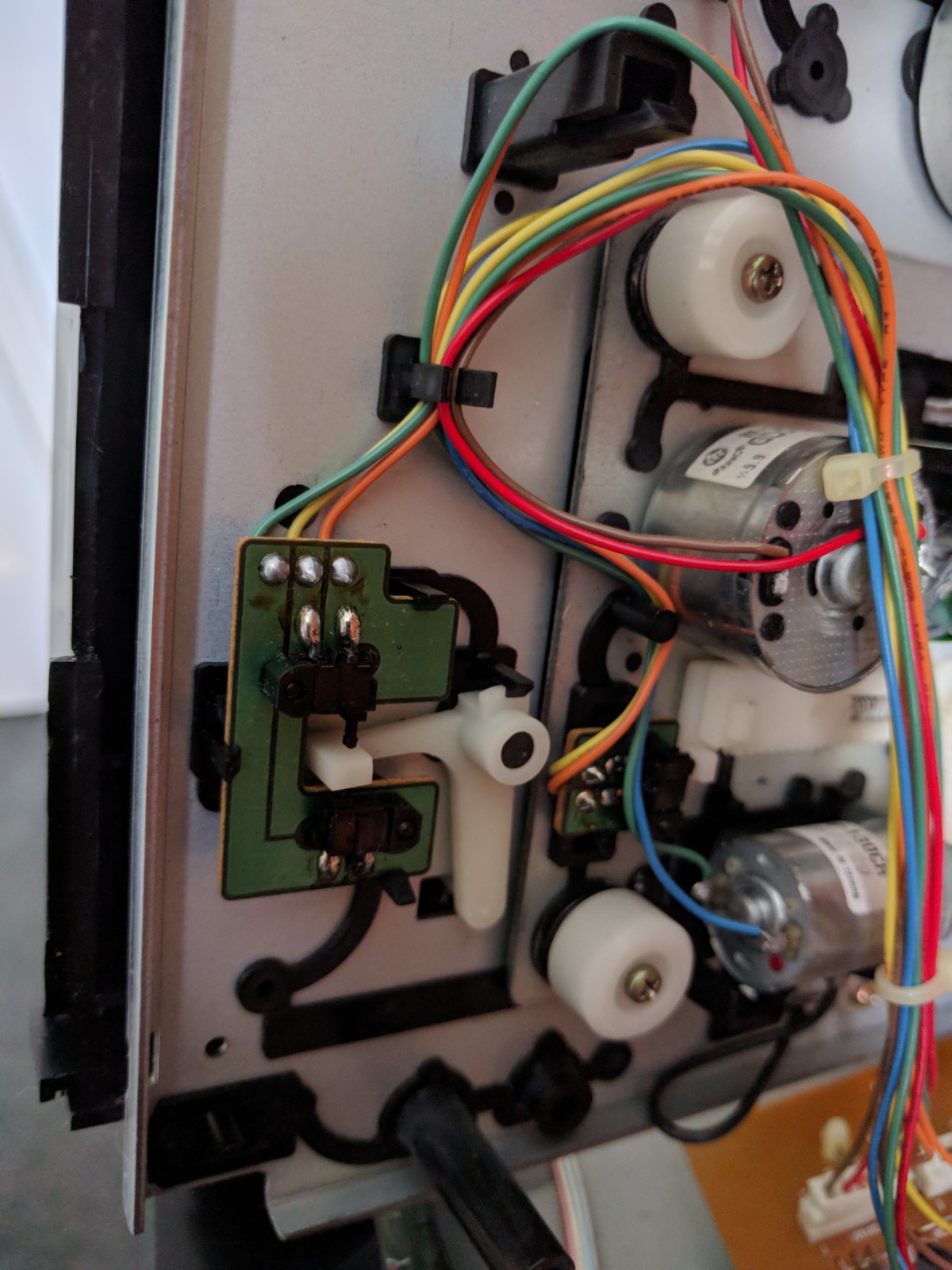

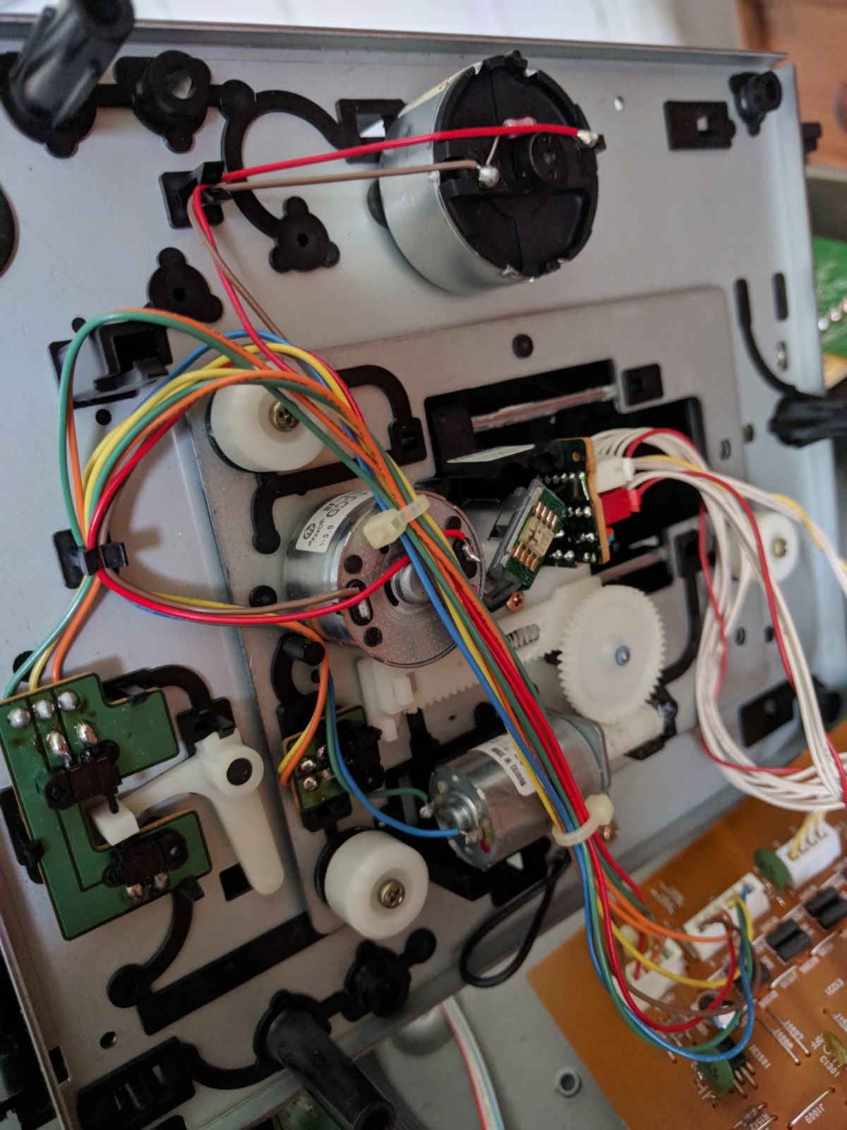

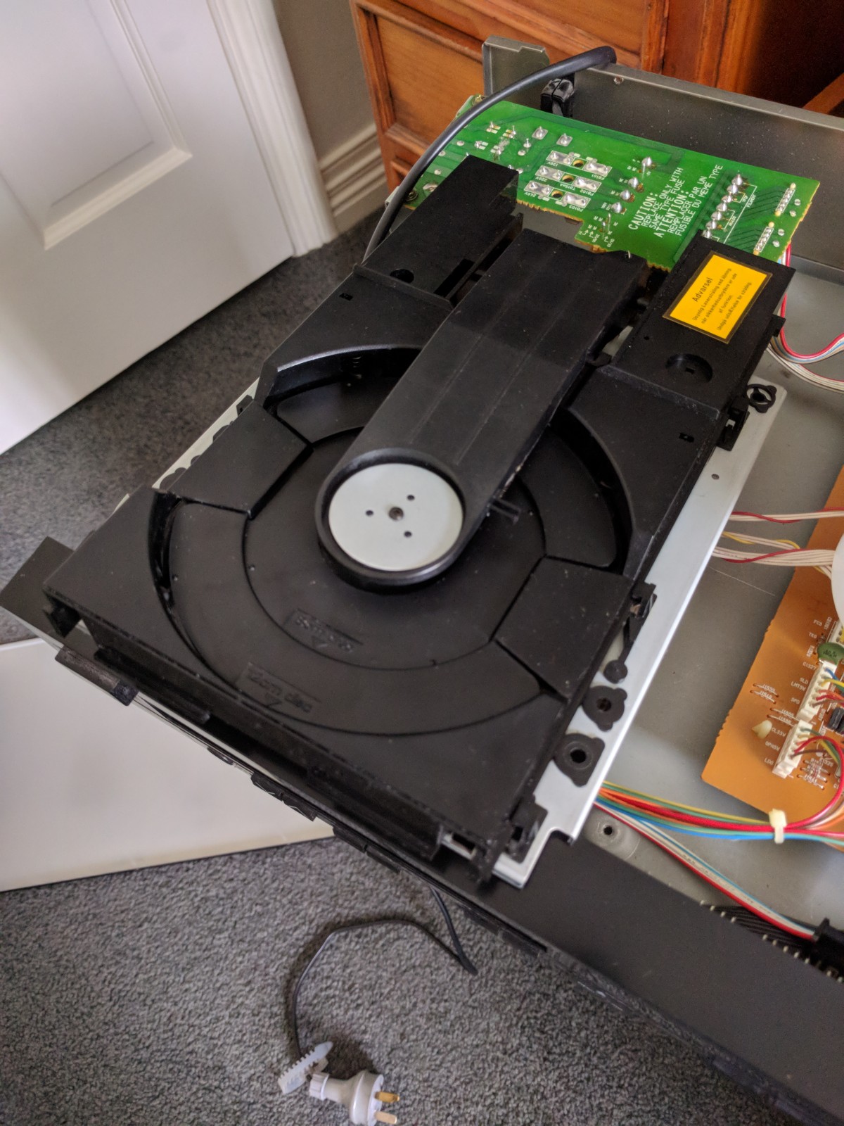

I've unscrewed the CD disc tray with its accompanying circuitry but left the cables in place.
I'm currently getting the tray to stay open about every sixth try.
The rest of the time the tray returns immediately upon hitting the fully open position.
I've gone over it giving the parts a good clean with ear buds.
I know I need to identify and work on the micro sensors, but can't identify them.
Do these shots capture the sensors?

I can only see what looks like two? proper switches on the left of those first images (on the PCB) and also something next to it with orange and yellow wires going to it.
Those on the board might be worth a soak in cleaner.

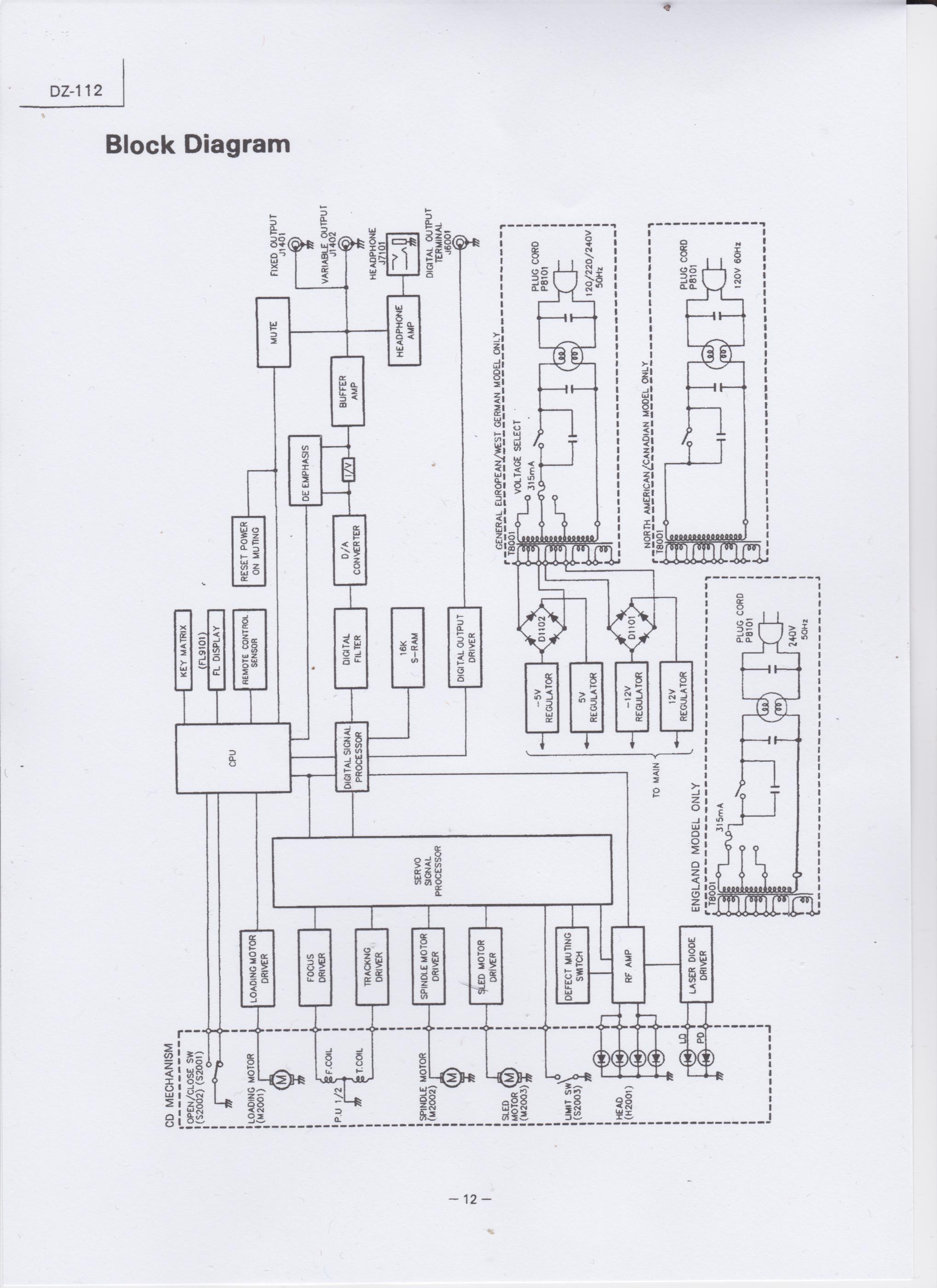

If in doubt then look at the circuit diagram and identify the tray switches that way.

As Mooly has stated earlier the two switches OPEN/CLOSE are on the small board on the left on your pictures. Colour coded leads: orange,yellow,green and the limit switch has the colour coded leads : yellow,orange.
I really appreciate everyones input.
I've carefully re read the posts and was able to identify the switches and clean them.
Before cleaning the cd tray would fail approx 6 times before it remains open.
After cleaning the cd tray now fails approx 2 times before it remains open.
Big improvement.
What should I try next.
Cliff
Big improvement.
Cliff
You have pretty much confirmed the diagnosis by saying it is much better after cleaning the switches. You could try removing the switches and soaking them fully in cleaner while operating them many many times... or replace them if that fails to work. Not really much else option wise 🙂
