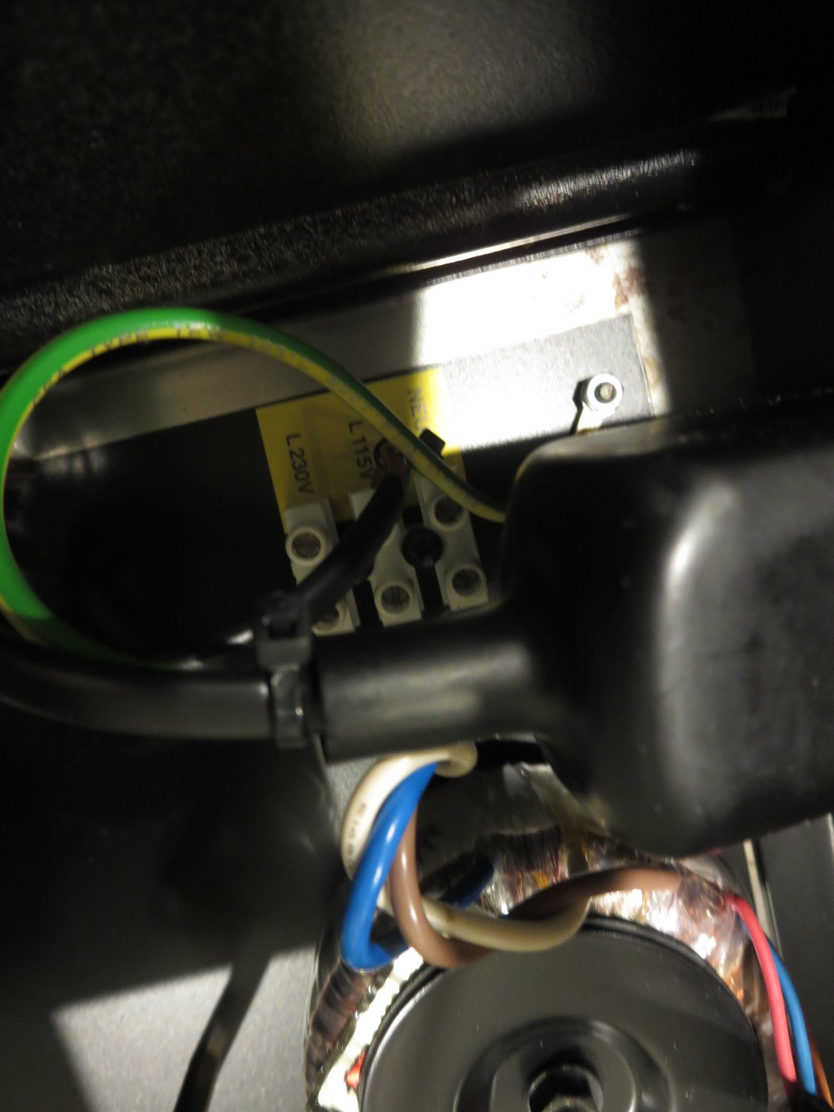

I have a Luxman L550AX that is a Japanese spec 100v version. I am using an external transformer but I want to move the internal jumpers to set it up for 120v 60hz.
I opened it up expecting to see something like the first picture (A Musical Fidelity piece that I am working on) where I can just move the jumper.

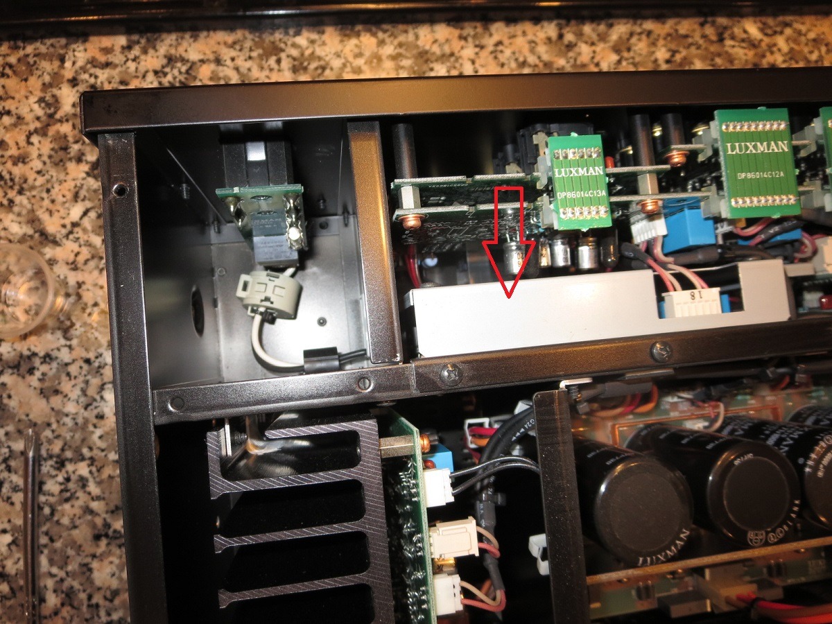

But then I opened the Chassis, it is much more crowded and the power inlet has no easily accessible jumpers. It looks like the power supply is under the grey shield marked in the picture.
Does anyone know how to change the input voltage on a Luxman L-550 AX? I am assuming that it is a simple jumper change and that the jumpers are located below the grey shield, but I do not have a schematic and I don't want to take this apart if I don't know what I have to change ahead of time.

Followup thoughts: The enclosure in your picture looks very thin to accommodate a traditional power transformer. I'm wondering if it might house a switching power supply. If that's the case, there's some chance that it it can handle a wide range of supply voltages and that you don't have to change anything. Can you provide more detailed model and serial number info to explore this notion? Any info on rear panel about supply range?

I'm afraid I'm not having any success in finding a schematic for your amp. The link below seems to be an owner's manual and its block diagram does not seem to suggest a switching supply, but that enclosure sure seems small. I find several L-550 variants, but none that I'm confident represents your amp. You could do some exploratory disassembly, but it looks arduous.
A thought is to try to fit a transformer into the corner compartment to perform the 115V to 100V voltage reduction. It appears power consumption is 230W, so 100VAC line current would about 2.3A. On that assumption, a possible candidate is: http://catalog.triadmagnetics.com/Asset/F7-20.pdf. Not sure there's room or if the idea has any appeal.

You cannot use the tiny little free space in the corner to insert a transformer for the voltage reduction, the space isn't big enough as said transformer needs to be AS BIG as the amp’s power transformer...

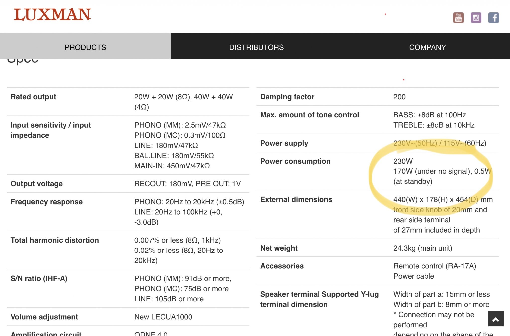

The spec sheet of your amp shows the draw at 230W at max, with an idle of 170W -
You need, at minimum, a 300VA transformer for your 120 to 100v transformer. You don't want to run a transformer at 100%, so a little bigger is required.
