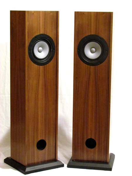

My MLTL for the A12P is now finished. I will run them for a few days before I post measurements. At the moment they are a bit shouty. Possibly break-in, possibly a stuffing problem. Overall, a pretty good sound. Bass is there, but a bit weak. Again, break-in/stuffing. They will take quite a bit of bass boost. Then, the bass is prodigious. Well into the 30's. We'll see.

Nice veneer work Bob
When broken in and with stuffing appropriate to the enclosure/alignment, I doubt you'll find them deficient of bass, but perhaps not as low as the 30s (I could be wrong) .
Both Jeff and Dave found them to take many hundreds of hours of break-in to fully open up, so you may need to adjust damping more than once.

You will appreciate this: The sheet of veneer had booking lines 11" apart. The max cabinet panel width is 10". OK. Four sides can have the booking down the middle. Two of the adjacent cuts went on the front of both boxes and the other two of the left sides. If you look close at the visible left side, it matches the two fronts. The tops, of course, are cut from the strip immediately above the fronts, so the pattern flows uninterrupted up the front and over the top. The rest of the veneer sheet was not a bad match for the lower half, so the right sides and backs match.
It's great fun when the veneer matches the side of the boxes so well.

Judging by the fractionally inset front baffle, I suspect in this case Bob has decided to employ a full-length grill to protect the drivers. Which if they're going to a show, as IIRC he was threatening, is probably a very wise move.
I quite like that look anyway -reminds me of 1970s Rogers gear. All I'd want is a quality receiver to go with it -a Sony V-FET model like the TA-F7B would do very nicely.
Where's the signature contrasting (american) football baffle?
Well, more like a rugby ball or an Australian football.😉
The problem (cosmetics) with the MA drivers is the very wide frame. To do the oval supra-baffle requires a total baffle width 3" wider than the driver frame. There is a 3/4" round-over on the supra-baffle and a 3/4" on the baffle itself. Bottom line is that the speaker width would have gone from 10" to 12". That would have required reducing the depth from the already narrow 8" to 6". Then, the port would not fit with enough breathing room.
So. The cabinet is made for a full-length grill. No, I will not show the speakers with grills on. I am already doing the unthinkable by not using a tube amp. Having grills on would surely bring out the tar and feathers.
Bob

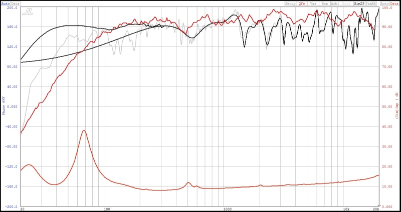

Here are a few measurements: Black is combined driver/port and 4ms gated. Gray is ungated 0.5m. Red is the published FR digitized from Mark's web page. Finally, the impedance at the bottom.
My measurements are anything but anechoic, but you can see the mid-range problem (the peak is actually 1259Hz). Here's hoping that the trace smooths out over time.
Given how ragged the FR trace is, I am surprised at how good these speakers sound. Speaks volumes to the fact that we hear a 1/3 octave smoothed version of the actual FR.

Hi Bob, (Guys),
The 12P has no peak vices at the the point you mention (1.259kHz) under anechoic test conditions. You might need to revisit the box design. Possibly either driver position, the location of the nearest bracing to the driver or the effectiveness of the internal damping. Any internal reflections impacting on the rear of the cone will effect performance. I'm commenting with additional caution as without an anechoic test condition, its difficult to know the extent of external effects from the environment on your measurements.
The overall sound should be pleasing as the driver's wide dispersion profile will mitigate emittance variations. The driver's power-train will optimise at around the 500 hour (dependant on run-in loading).
I should let folks know that as I develop ever lighter cones, especially paper versions, increasing variance in the anechoic measured frequency range will occur. The design of new cones are lower profile delivering wider dispersion and central stereo imaging as these features add to optimisation of the overall listening experience.

Further thoughts. Appreciating the requirement for a shallow MLTL depth to accommodate the characteristics of the driver, I'm wondering how close is damping located to the rear of the driver; And the type of damping?
Your box looks fab so give this system more run-in time. If you find that the peak is still audible at the 400 to 500 hour mark, if it were me, I'd opt for a filter rather than ditch the design. It not aways possible to get a perfect marriage between box and driver straight off the drawing board.

Mark, I am sure you are right that all of the trash is box related. It may never be possible at my level to get a decent FR trace. In the display above, I did make one mistake. I adjusted levels to match at 1kHz.If I had brought my trace up 3-4dB, it can be seen that the envelope follows the published trace at least to 10kHz. I discussed my choices of cosmetics earlier. There are some consequences in the diffraction signature, which indeed may be what I am looking at.
The 1259Hz peak is really bothering me. That a 1/2-wave of ~5.5". Looking at the cabinet, the only dimension that jumps out is the front to back distance. I'm going to increase the thickness of the fiberglass padding behind the driver. Can't hurt.

Hi Bob,
It might be worth giving the drivers another 50 hours or so of run time, then experiment with the internal damping. I suspect that the shallow depth of box might need to the damping to be adjusted to suit. The notch filter should be a decent fix if this particular peak persists.
Overall I reckon the box looks great, very stylish and should mellow acoustically around the 1000 hours. Us mech engineers like to build some operational reserve strength, so the 12P's will continue to "warm" well into the +1000 hour operational timeframe. In my living room, Im using Alp7's Gen. 2's with lots of hours on them (15000+), they are now verrrrrrry sweet.
