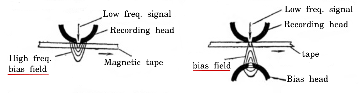

Cross-field is a great Akai invention, and was patented all over the world.
It prevents erasing effect on the audio signal on the tape when it leaves
the narrow gap and the audio field of the head, but still in the much wider
HF bias field. This erasing effect not only significantly reduces the amplitude
of the short wavelength / high freq. signals (depending on the tape speed),
but also creates a lot of distortions for the signals on the tape.
The Cross-Field is devised to narrow the HF bias field at the recording gap to
the same width as the audio signal field.
