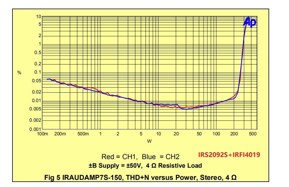

For example, irs2092s + irfi4019 can easily achieve 250W 4R.
THD 0.002%

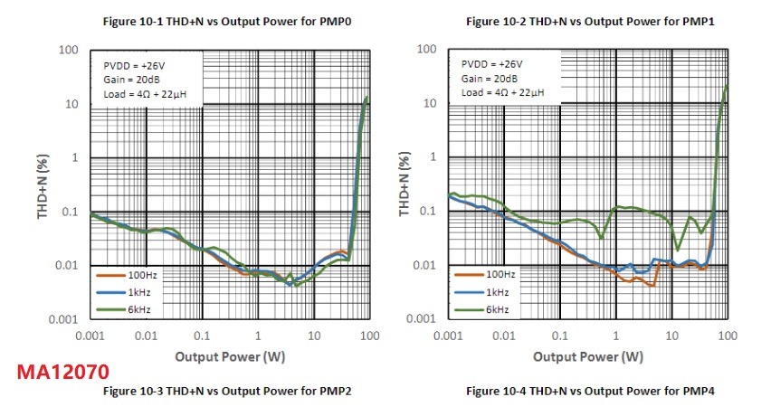

In addition, thd does not mean anything.
If DIY is the smallest thd amplifier. It should be lm4702.
It's easy to make,about thd =0.0003%.
But in fact, I once made lm4702bta.
There is no special effect. It's not even as simple as the circuit I designed.
