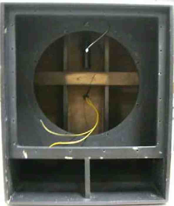

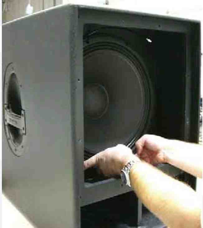

Does anyone know what the innards of the SWA1801z looks like? Documentation from Mackie suggests that it is dual horn-loaded design, but it looks to me more like a 6th order BP alignment with flared vents.
From the photos it looks like a very short front horn loaded bass reflex rear. The front compression chamber and small throats probably help to control excursion so that more power can be applied without hitting xmax. It doesn't look like a true horn though.
That's my take on it though. The freq response looks like a crested bump - not flat at all -no fancy bandpass chamber here.

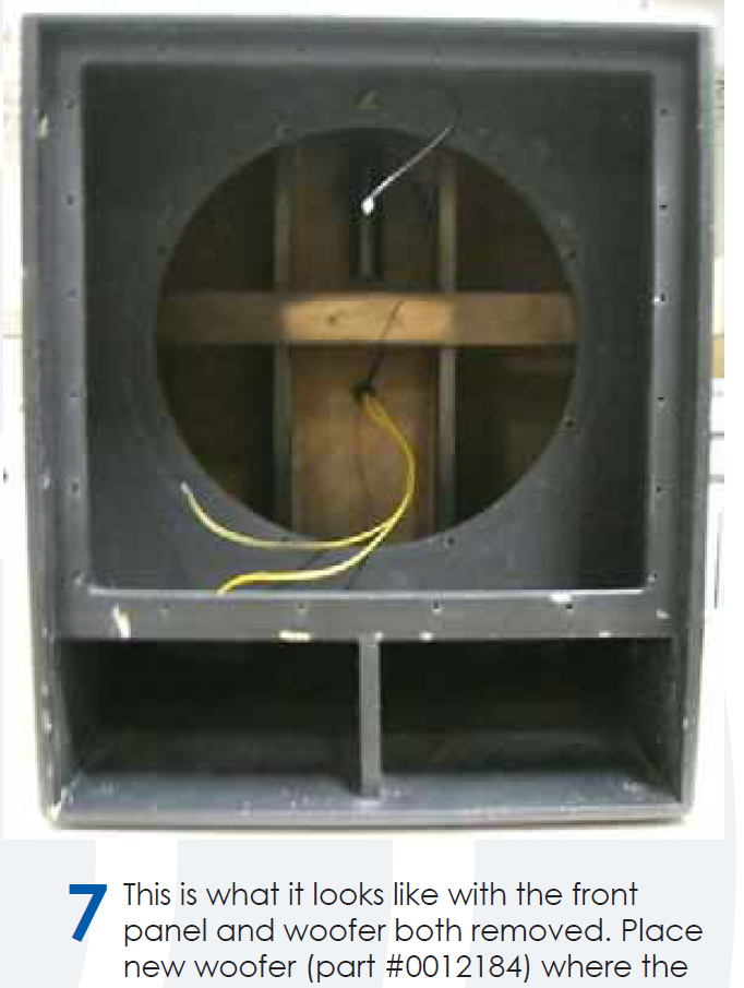

On mackie.com they have a repair manual, etc. This seems to confirm that this is a 6th order BP w/ horn-loaded ports.

The next post photo doesn't show how this can be 6th order bandpass.
even a slot loaded box is a band pass of some kind. no matter how small the chamber (and what effect, if any it has, there is def a ported front chamber.
I thought that the front chamber has to have a port that connects it to the back chamber for it to have bandpass action. Here, the front horn appears isolated from rear chamber or vent. Unless there is a vent located at the bottom of the front chamber and connects to the vent.
I see it now. The front panel forms a chamber in front of the driver with the opening being the flares on the face. The enclosed cabinet volume and bottom ports form the other chamber.

For the standard 6th order BP you have a front chamber that is ported to the outside w/ a duct (in this case a short horn), and a rear chamber that is ported to the outside (in this case the horn opening at the bottom). The driver sits on the dividing baffle between the chambers.
P.S.: Looks like Post #9 got in before me. 🙂 And if you add the third duct between the chambers you have an 8th order bandpass.
