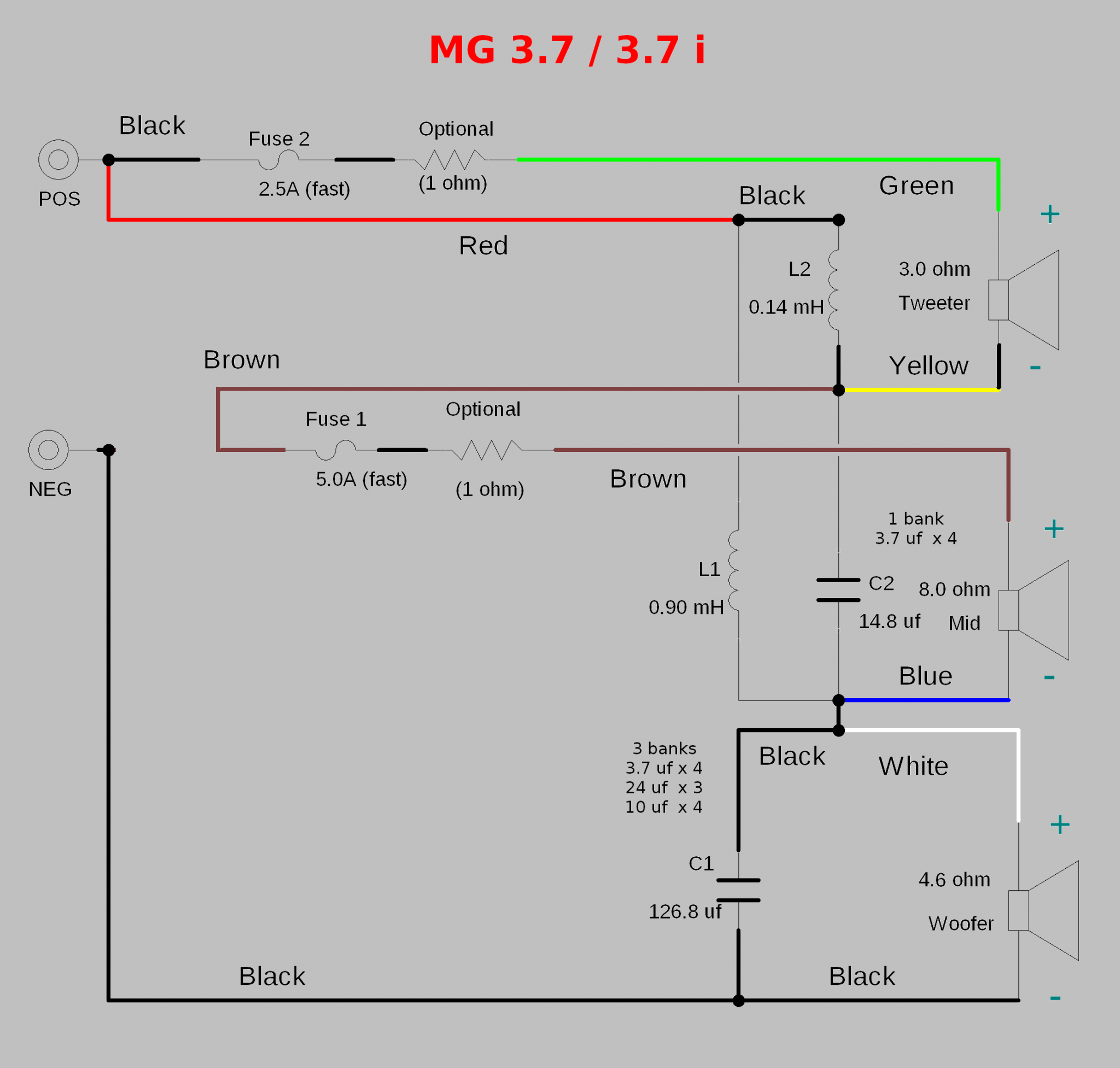

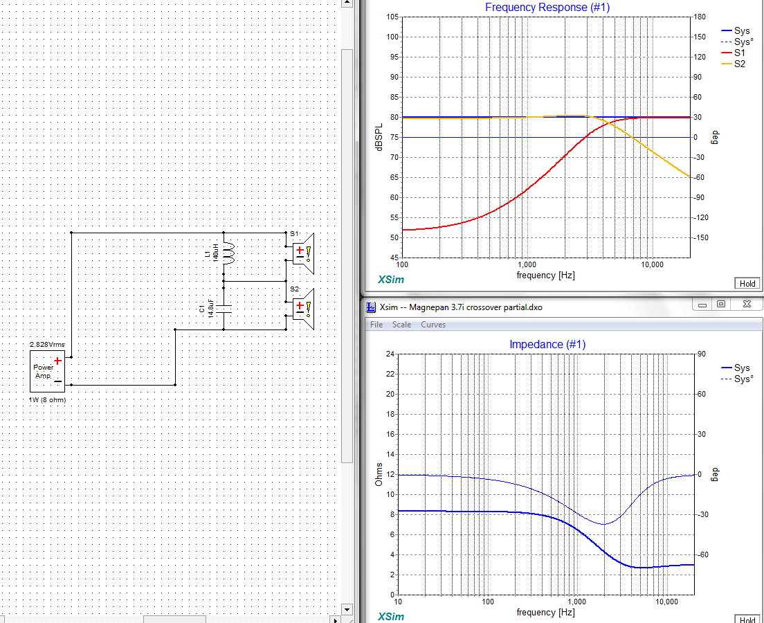

I have a pair of magi 3.7i and would like to convert the crossover from serial to parallel.
So I can bi-amp them and play around with better parts.
From the schematic it looks like, and I am guessing 😊
12 db on the tweeter
6 db band pass on the midrange
6 db on the woofer
Am I right?
Found the schematic here http://www.integracoustics.com/MUG/MUG/tweaks/neolith/
I don't know where I can find neolith so I hope it's okay to use his material

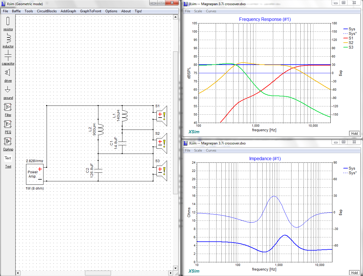

I started with the assumption that you want to match the response of the original design. I left out the optional resistors in my model, then used standard parallel crossover elements to get a reasonable match for the first 10 dB of roll-off for the individual sections. All planar elements were modeled as flat resistance at the values listed on the schematic (which happens to be a seriously confusing way to draw the circuit, to me).
Redrawn/simplified schematic:
My take on the original crossover curves (values approximate and open to interpretation):
Tweeter - 12 dB per octave, 3.2 kHz, Q of 0.6. That matches pretty well down to 1.5 kHz, then deviates where the bend is in the original.
Midrange highpass - 12 dB/octave at approximately 390 Hz, Q of 0.85. Same issue as above - the tail deviates some farther down, and the bump up above the reference level at 600 Hz isn't there.
Midrange lowpass - 12 dB/octave at 5.5 kHz, Q of 0.62
Woofer lowpass - 12 dB/octave at 450 Hz and Q of 0.92, deviations again from original
Converting to a parallel crossover is going to cause some changes you may not have anticipated. Just doing basic matching of the individual driver responses with simple crossovers doesn't work, even with a phase inversion of the midrange (which is standard for 12 dB/octave parallel crossovers). You will also lose the time/phase coherent aspect of the current crossover. Whether all that matters to you, I can't say, but you should realize you will be making significant changes to the way the speaker operates to do this.

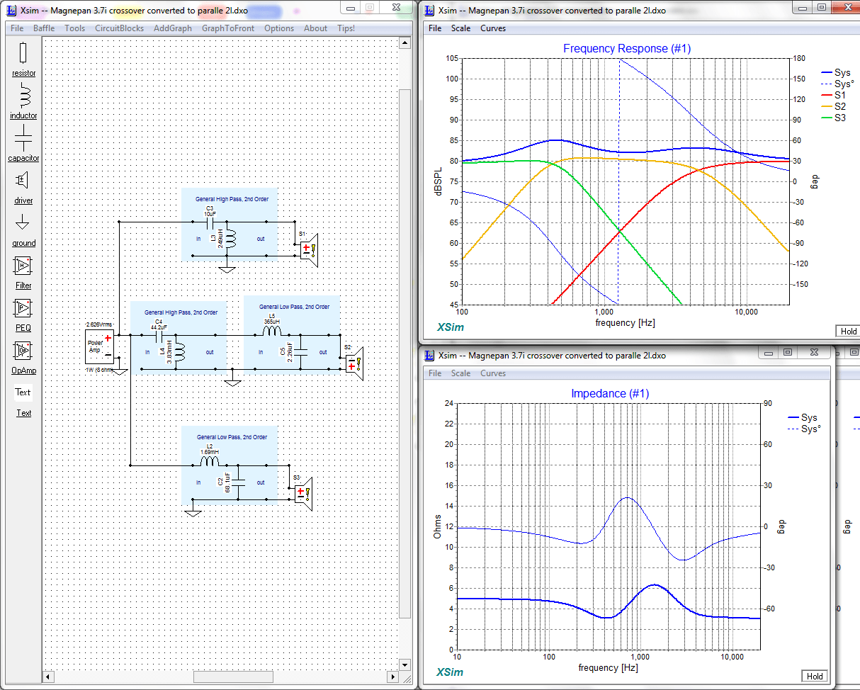

This is what happens when you try to use the same basic curves in the parallel configuration:
I believe the 3.6 version used a parallel crossover. If you really just want to bi-amp, that may be a more suitable version to start with.
If you want to proceed, you have to decide how you want to approach the project. Trying to use more standard Q's at the original crossover frequencies, with inverted midrange polarity seems like a logical approach, but it's not my speaker.

There are many different ways to do all of this, but none of them are going to give you what was there in the same way as the original, but now with 2 amps driving it.
It's going to be a more involved project than a straight conversion to bi-amping would be with a speaker starting off with a parallel crossover configuration. It's likely to need measurement, adjustment, etc. For those with the capabilities, it might be an interesting project. For someone looking for an easy conversion, I think that's less likely.

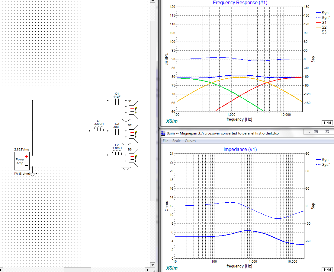

Here's what it looks like with a simple first order parallel configuration, since I didn't include that previously. I tried to keep the cross points at the same frequencies.
Here are the midrange and tweeter in isolation with the original series elements on them. It's reasonably close to the original model, so would likely be OK in this configuration.
Dealing with the woofer/midrange transition while maintaining the same time/phase relationship of the original is likely to need DSP.
A standard 12 dB/octave crossover with a polarity inversion on one of them would probably work too, but that loses the time/phase coherence of the original for the bass/lower mid frequencies. Again, each person has their own ideas about what aspects are important to retain, so I'm not offering an opinion on that.

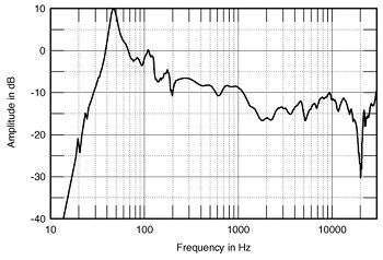

I hope you know why it measured like that or the way they measured it. That is not how they measure in a listening room.
As Roger mentioned, that's not a valid/realistic measurement. (Certainly not representative of how they sound in a room.) If you're making DSP corrections based on that, you're not going in the right direction.True. I'm also using DSP to improve the frequency response. No Magnepan speakers measure well. This is Stereophile's measurement of the 3.6/R. We can do a lot better than this ...
The problems with the measurement technique are explained by Siegfried Linkwitz in the comments section:
https://www.stereophile.com/content/magnepan-magneplanar-mg36r-loudspeaker-more-comments

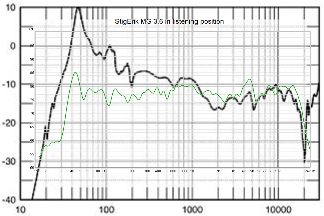

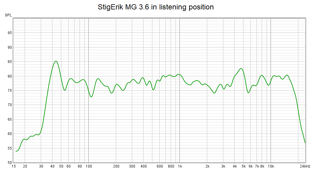

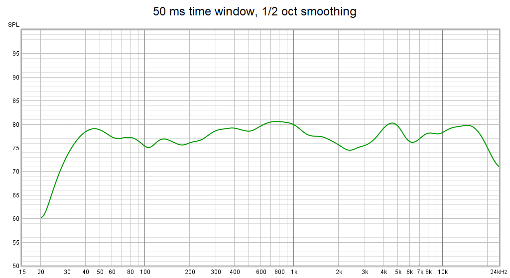

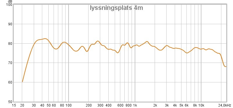

This is my 3.6/R with the passive XO.
1/6 oct smoothing and full time window.
Below is what Linkwitz recommended - 50 ms time window and 1/2 oct smoothing.
