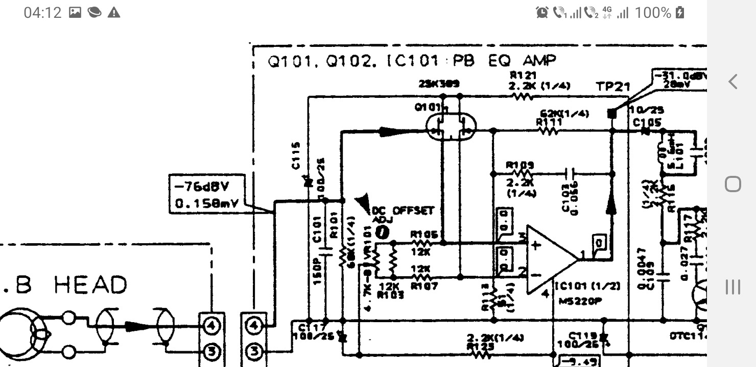

Hello again all,
I am nearing completion of my project and am basing the analogue tape compensation section on a circuit i have found (hopefully attached) from the NE5532 application notes. I was initially planning on using the design from the LM381 but it is a very hard to find IC and has some extra internal capacitors which I believe mean it cannot be directly replaced with a standard op amp.
My first question is : on the circuit attached there is a input cap labelled as being 0.22 which I presume is farads which seems a freakishly large capacitance to use for an input cap, could anyone recommend a value that could be used instead?
Secondly there is a input resistor RSL, does anyone know its function? I am trying to work out a suitable value (or if indeed it is necessary?)
Lastly the feedback capacitor is stated to be 0.003 which is 3mF which is again a very large capacitor, is it possible there might be a u or p missing from the end? I only ask as I have now ripped open a fair few tape decks and have never seen a capacitor this large outside the power supply, perhaps they are just using a better compensation circuit.
Thanks in advance for any advice

All capacitor values are microfarad, 0.22uF input (=220nF), and 0.003uF feedback (=3nF).
RsL is the head loading resistance, and is tailored to the specific head you use. It's likely to be around 180k. With the wrong value, the high frequency response will be poor, or over accentuated.

By the way, what transport (tape drive mechanism) are you using? Or are you building THAT from scratch too?
A side note, the NE5532A variant is lower noise. Might be important if you want really quiet playback.

(As an aside I have designed and built playback only cassette players in the past, and have restored more than a few ReVox G36 tape decks.)

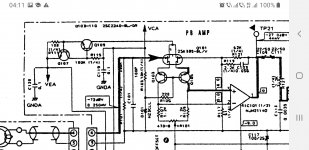

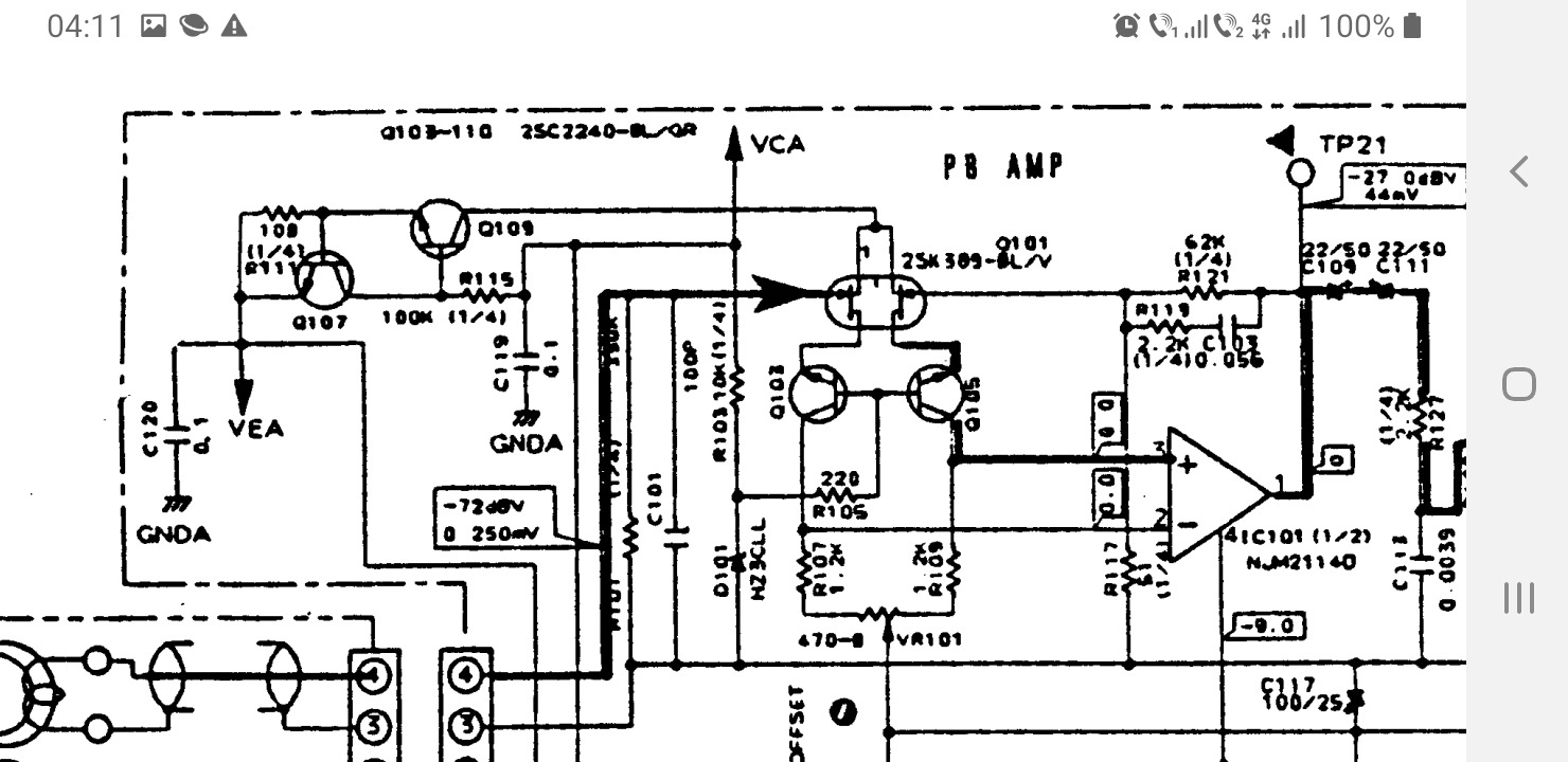

Having built many tape decks in the past with both playback and recording with Dynamic Noise Reduction etc., may I add my two cents.
Philips used to make an an IC, think it was TDA1522, specifically meant for tape amplification. I've used it and it sounded almost very good.
I have also used the JLH circuit which uses an FET in the input and an opamp for the NAB correction part. This also sounds good.
However, I found that some of the discrete circuits from Sony sounded the best. Many have a switch to toggle between 120uS and 70uS; so you can play both normal and metal/chrome tapes.
I have also seen some Pioneer circuits with dual JFETs in the input stage but have never tried them due to component unavailability.
All the best for your project.
By the way, if at all you are using the circuit you posted with the NE5532s, you wouldn't need the RIAA correction part of the circuit in the NFB part, but only the 1.1M, 16K resistors and the 3nF cap. You could also use another RC circuit for 70uS time constant that you can switch to for metal/chrome tapes.

I can only speak from my own experience regarding the voltage output of 8 track cartridge heads. With my scope set to the 2 mV/div scale, I get barely any noticeable movement of the wave on typical program material. Thus, I'll say the output of the head itself is in the high microvolts, or at least far less than 1 mV according to the Tektronix 2465 CT scope.
As someone playing arround with RTRs and cassette decks I feel obligated to give a final word.
The voltage on your heads during playback is frequency dependant. The function is 20dB/dec or 6db/oct
Reason being its an inductor.
For standardisation of your measurements you should measure head output levels at 315Hz for cassette decks (unaffected frequency by both HF rolloff and LF shelf) and for reel to reels at 1kHz. (For speeds at or above 19cm/s)
If you were tomeasure 1mV at 1kHz on a reel to reel head, youd find that at 100Hz youd be measuring 100uV.
The head impedance thus is very important, and you can relyably measure it only with a calibration tape with known record levels.
For what its worth, cassettes usually are recorded 250nWb/m 0dB or 320nWb/m 0dB
This flux will then produce a certain volte in the head and so you can measure by a refference, how is your head doing.
Couple of noteworthy things:
DO NOT MEASURE WITH MULTIMETER OR OSCILLOSCOPE.
These devices have some amounth of leakage current flowing back and mere nano amps are enough to magnetise your heads permanently. The only way to measure the head output level would be with a tube AC voltmeter or a specialised low high input impedance test meter.
Just plug any cassette deck or reel to reel head preamplifier into LTSpice. Youll find that 315Hz most cassette head preamplifier run roughly 60dB gain, thats a lot. And pretty much checks out with the expected voltages on the head. Remember, 20dB / dec voltage gain. The lower the frequency the more gain you need. My preamps for my reel to reel go 85dB gain at 10Hz.
With this knowledge youll find out measuring voltage across your heads is pointless, in fact it does harm because you magnetise your poor heads.
Youre better off building a head preamplifier with known parameters and a Jfet opamp that has input current specs in the picoamp regions. Or CMOS, whichever is at hand. And you need lots and lots of gain to get your head voltage to line levels.
Please for the love of god do not use the NE5532. Its input bias and offset current are so high they will magnetise your heads, and that is no good. Use a TL072 or something with JFETs. If you want something hella good look for OPA1656 opamps. Replacing the old TBA opamps in a revox A700 has proven to be the best decision ever. No noise without tape running across the heads compared the old stuff that was barely below the noisefloor of the tape.
