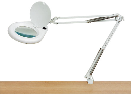

5x Mag 16 Diopter 5"x7" Magnifying Swing Arm Desk Lamp
Desk Clamp 5x Magnifying Lamp
These would be used for soldering. I might get a higher power loupe or cheap boom scope for inspection work later on if needed but the field of view gets pretty small for these (<1inch).
What would you recommend? What do you use? Any tips would be appreciated.
-Charlie

16dioptre is equivalent to 62.5mm focal length.
That is similar to standard 35mm camera lens.
F1 would require a collecting light diameter equal to the focal length.
This magnifier claims a diameter of over 200mm.
That would result in an f number of ~0.3
Have you ever seen an f0.3 62.5mm lens?
What they claim is impossible.
The other one have copied the same impossible information.
What is the world coming to.
Advertising standards to the dogs !

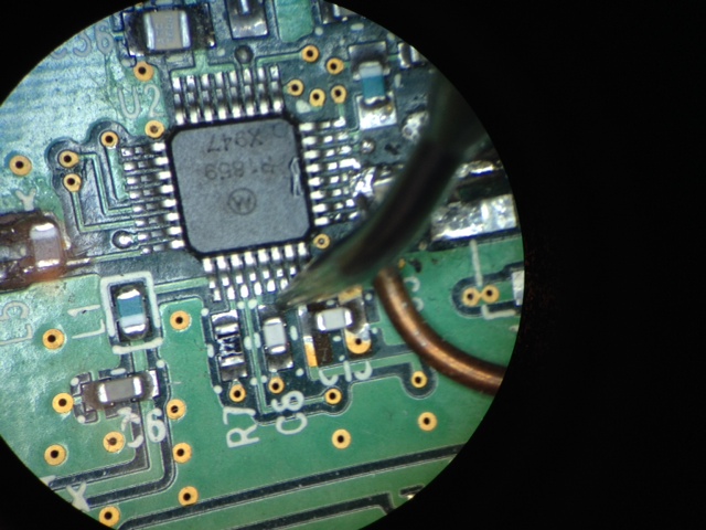

Here is a photo made through my Amscope at 20x magnification. It shows about the smallest smd parts you are ever likely to try to deal with. I show a very small soldering iron tip for reference.
The view through the scope is actually much better than this iPhone photo shows.
So 20x should be enough for your needs.

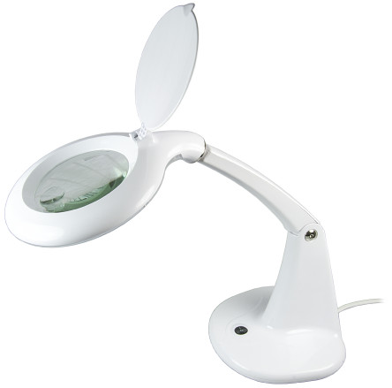

have tried this 125mm one in the 1. phot
worked quite well
but thought the 22W light was a bit too bright, for general lamp use
sold it to a friend
now going to try the smaller 100mm table model in the 2. photo
with 12W light, same mag lense specs, just smaller
but not a pro tool, ofcourse
Features:
• 12 watt circular energy saving tube
• Shadow free light with low heat emission
• Ergonomic design with table base & lens cap
• Quality 100mm (4") lens, 3 dioptre (1.75x mag.)
• Built-in close up lens 12 dioptre (4x mag.)
• Height 15" (37.5cm) • Cable length 1.5m

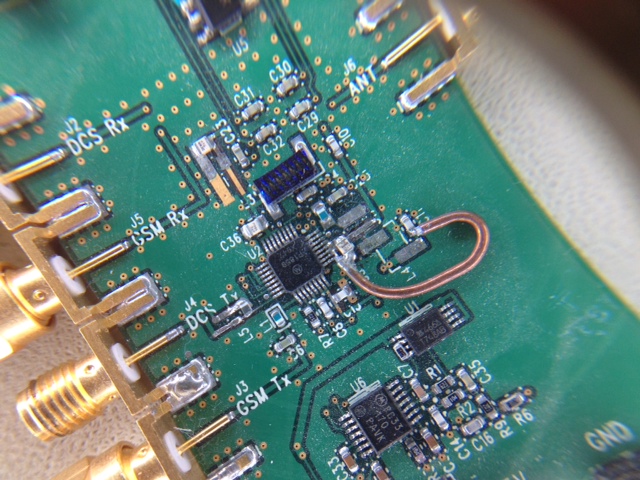

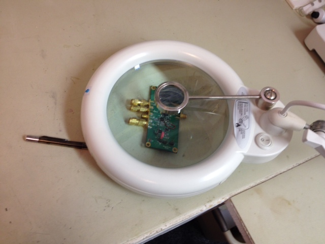

As a comparison, here is the view of the same board through my daylight brand model U22020 with a 1.75x (3 diopter) plus the 4x (12 diopter) magnifier for a total of 21x. The trouble is the working distance is almost zero.
But this is a very good magnifier lamp with optional 2.25x or 3x lenses that can replace the standard one (although the field of view gets smaller).
Useful for probably 90% of the work I do, but when it comes to small smt parts, only the scope works.
Terry

ah, I see now what 'built-in-close-up-lens' means
looks like a smaller field in the normal working lense
could be practical for checking possible solder errors etc
only hope it does not disturb the working lense too much

Daylight is just the brand name. The model is U22020. I picked it because you can change lenses. It comes with a 1.75x, but has optional 2.25x and 3x lenses, although as the power goes up, the field of view (lense opening) gets smaller. I bought the standard and both accessory lenses, but I almost always use the 1.75x since it has the largest field of view, which is handy for most work.
