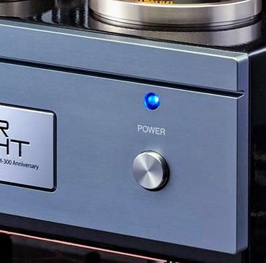

For the amp I'm building I'm looking for a mains switch and despite going through similarly named threads, I can't really find an answer to my question. That is, how do I calculate the minimum safe amp rating for the switch? Or at least, what is a good rule of thumb?
The amp should pull no more then 100W @230V so that would mean 0.43A but that doesn't seem right.
I'm looking for a switch like in the attached picture but the only ones I can find are 3 amp rated or close to that and from what I read, that's (too) low.
The amp in the image is similar to what I'm building (300B SE stereo) so I know it should be possible.

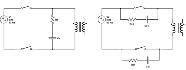

Sorry to dig up this old cat-thread but I have a question about using an RC snubber on the mains switch. I'm using a 2 pole switch, disconnecting both neutral an live. If I choose to use a snubber, do I use one on each pole or only on the contacts switching the hot wire?
Which wire is hot?
Isn't that why you use a 2-pole switch? In many lands you can't be sure because the wall-plug can be inserted both ways. In the US we have a fat-blade convention but 60% of the outlets in my last kitchen were wired H/N reverse.
Do both poles.
Which wire is hot?
Do both poles.

Put the snubber across the mains transformer primary. It will snub whichever switch contact happens to break first; the other contact does not need snubbing. It will also mean longer life for the snubber capacitor, and 'off' really means off.
If for some reason you want to put a snubber on the switch then you need to do it for both contacts because you don't know which will break first.
