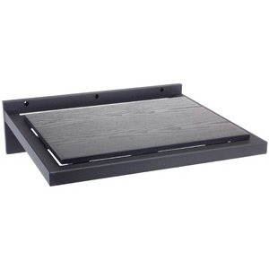

If you are attempting to save some space or reduce the effect of "foot fall" disturbance of your TT I suggest that you consider the use of a wall shelf designed for TT use - such as the one listed below.
Target - VW1 Wall Mount Turntable Shelf-Audio Advisor

If you put your hand on the wall and play at realistic levels you will feel way to much "sounding board drumming" . The huge surface area and the air space behind are just magnifying issues you don,t need. Put your hand on a solid turntable stand and these problems are almost non issues, except of course a 2nd story footfall problem. In that case, this might be the only solution I guess.
