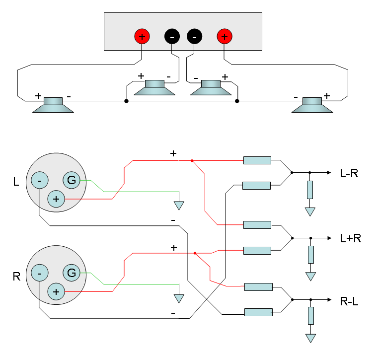

Ideally, I think 3 front channels should be:
true L ..... true C ..... true R
But how to get these 3 channels from stereo signal?
OTOH, there're also other proposals, such as:
L .... (L+R) ..... R
or
L-R ..... (L+R) ..... R-L
These two can be easily done in analog circuits, even between amp and speakers. Supposedly they also provide some good features to please those who are using them. ( No? )

Before stepping into actual circuits, let's talk more about the channel distribution, shall we?
I tried the simpliest 3-ch briefly: L-R speakers connected in series and linked to hot side of both channels of amp, while the C crosses the junction of L-R and the cold side of amp.
In all related diagrams I've seen, the center speaker should be in double and paralleled. I guess it's for proper summing etc. But I use only one here...
In such connection, when playing mono pink noise, the distribution (in level) is obvious center-heavy. Center channel is much louder then both sides. Interestingly, when playing music, soundstage can be very wide and not center-heavy at all.
However I found some problems in the correctness of locallizing - cymbals come to the center which should be at the right side. I guess 2 reasons for this:
1. Wrong level matching across the 3-ch. It's indeed overly center-heavy.
2. Wrong re-distribution by the crude summing. L+R is put at the center, which means all sounds are emmitting through here, including those should be far L and far R in the original signal. So in this case I heard too much right appearing at the center.
Now what?
What are your experiences?
In attached diagram, I did the upper one (for now), with an exception that my center speaker is only one.
And then, what's the difference betweet the two?

L + R for center is the conventional way to derive it. This will tend to diminish your stereo spread soemwhat. Due to that you can play with streching the L and R speakers farther apart. A lot of people play with center channel level also. I hear -6dB as a common setting.
I would be tempted to use out of phase crosstalk to spread the left and right some. Rather than full L - R and R - L I might try L - 0.5R and R - 0.5L.

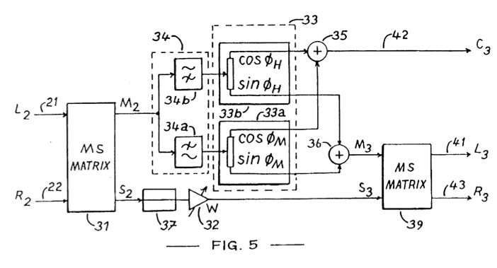

IN DSP
I use the following in Reaper JS to create the LCR.. This is similar to the Trinaural method (Dont know for sure) but done in a Reaper JS plugin....
Im no programmer. So i think there are some improvements to be made.
The degree parameters effect the gain of frequency at each speaker. In my installation i have a HP/LP at 5000hz so high freq is more centre. Low is more spread.
This method also makes sure that gain across all 3 speakers is the same as combined gain from the original L/R signal... (at least i think it is 🙂 )
This works very well. You need to either delay the mid or bring the L/R speakers closer to you to get things right.

As to the DSP provided by optic, it's now far beyond me, sigh~ In the diagram, I can't even guess how it works. (why is C3 irrelevant to R2, and made out of L2 only?)
oops how about the patent i got this from then..... This should help you understand my madness...
Sound reproduction system having a ... - Google Patents
and small mistake in my posted code.... Pasted old file... If anyone is interested i will post an update....
Its not, first block converts L/R signal into a M(mid)/S(side) signal.
