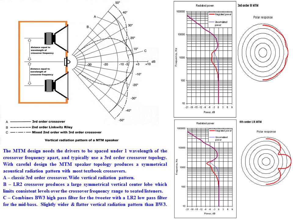

Another thought: I’ve read that MTM has better for vertical polar response (it doesn’t suffer from droop), but does that only apply to 4” and less drivers? Is that because of a CTC spacing issue with larger drivers? It seems like many MTM designs are for 5” or 6” drivers.
MTM vertical dispersion controls the floor and ceiling reflections very well, and this is good if your room is not treated.
However, they contain vertical nulls in the crossover region, due to the insufficient CTC between the two LFs. This problem was addressed (and also alleviated) by Charles Hughes in 2008. You may read Hughes paper here.
With smaller drivers like 4" or lesser, it only becomes easier to get smaller CTC distances and that only makes things less severe. However, properly adding another 8" to the whole contraption would be a difficult thing to do. Adding active subwoofers would be the most straightforward thing you could do.

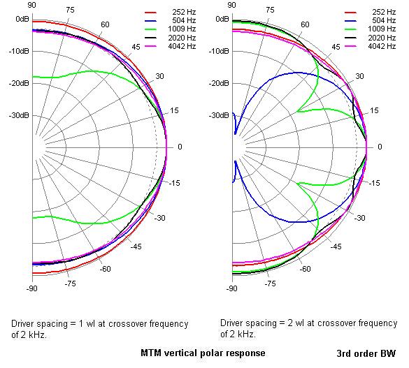

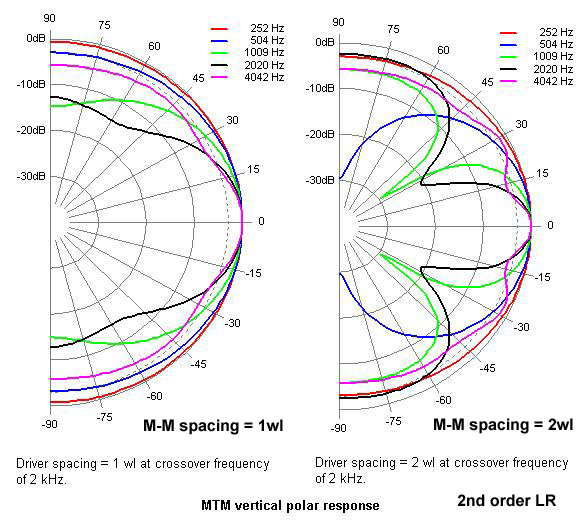

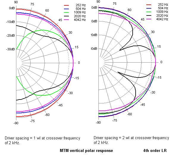

The type of crossover cicuit used in an MTM also has a large affect on polar response.

Yes, the problem addressed by the Hughes paper in #11 is clearly explained in this paper. Note that this paper came way back in 1996 with the Hughes paper appearing only in 2008.LineSource said:This popular birotechnology paper provides MTM insights.
And yes, the crossover has a lot to do with the radiation pattern put out by the speaker. The following are MTM verticals for different crossover types and CTC distances. I got these pictures off another forum (don't remember which) sometime ago. Hope it helps.
