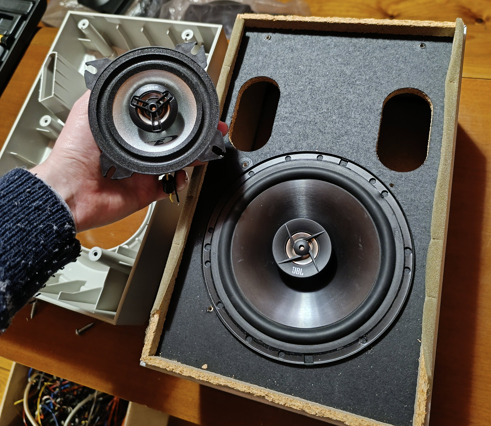

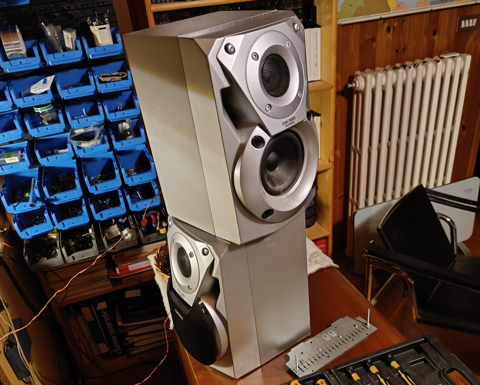

A friend gifted me some old car speakers, instead of throwing them away. Plus I got some broken panasonic speakers that I had laying around for a while.

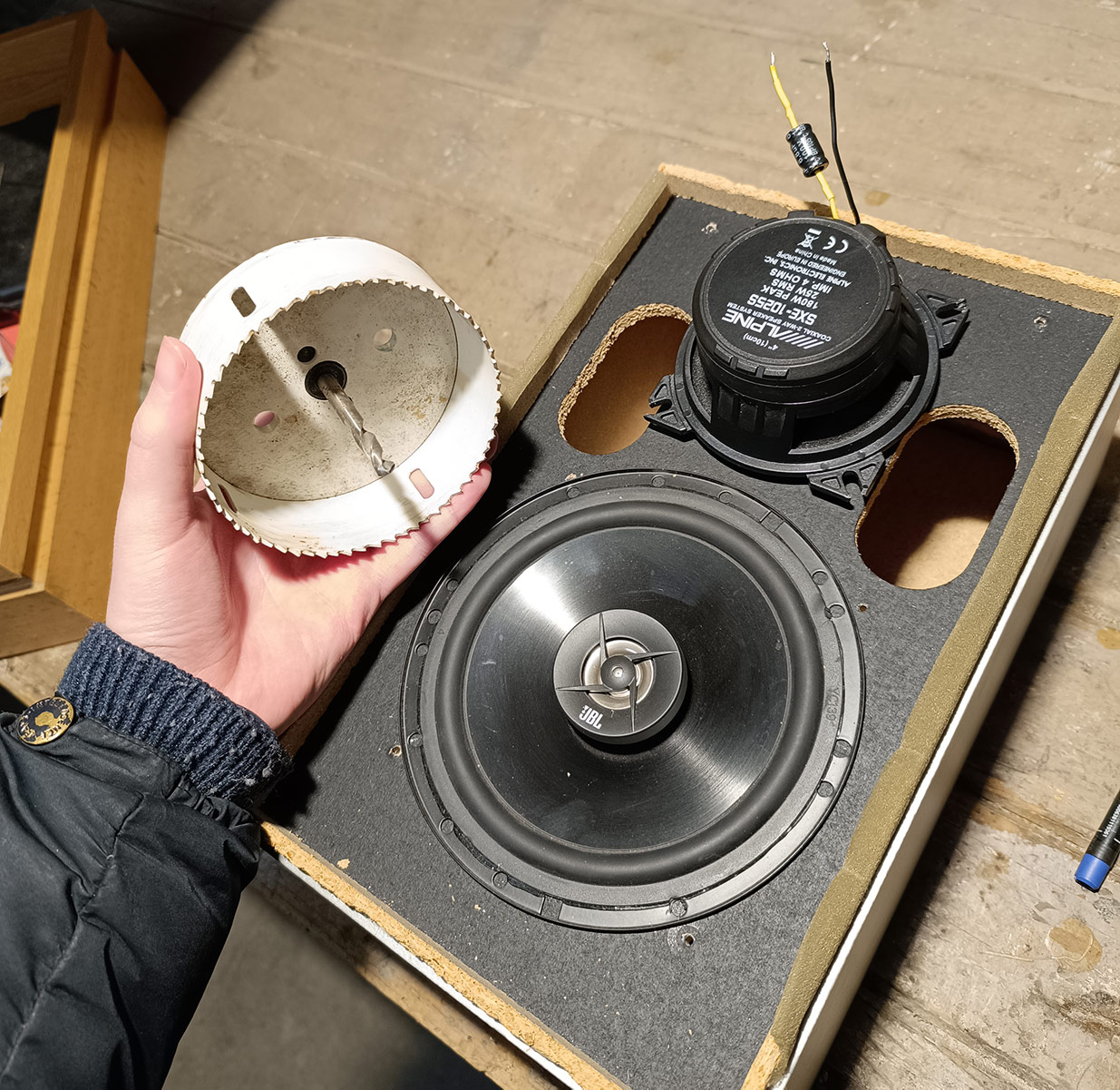

It was quite simple taking the plastic cover away, but then i realized there was no hole for the tweeter and there were two big open slots, that I had to cover if I wanted to make an enclosed loudspeaker.

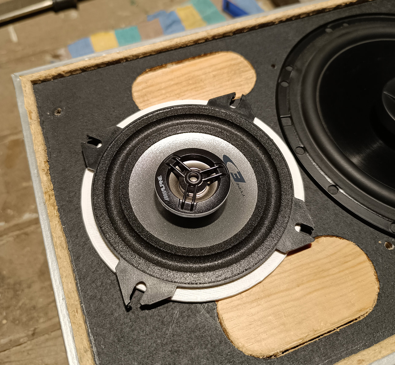

I drilled a hole with a hole saw but it was too big so I had to 3D print a gasket lol

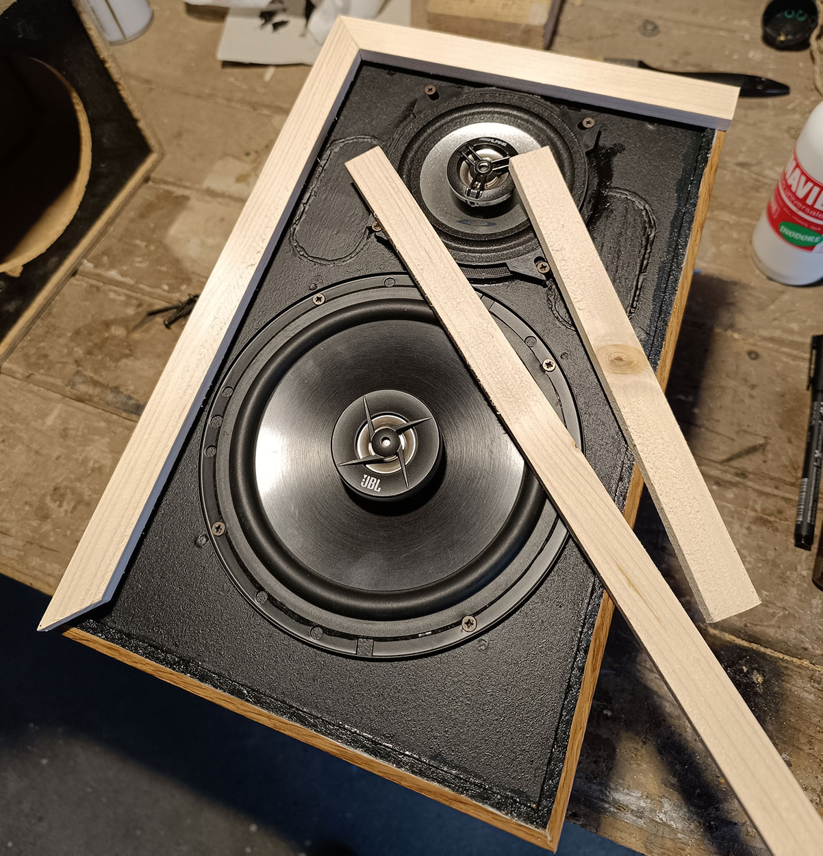

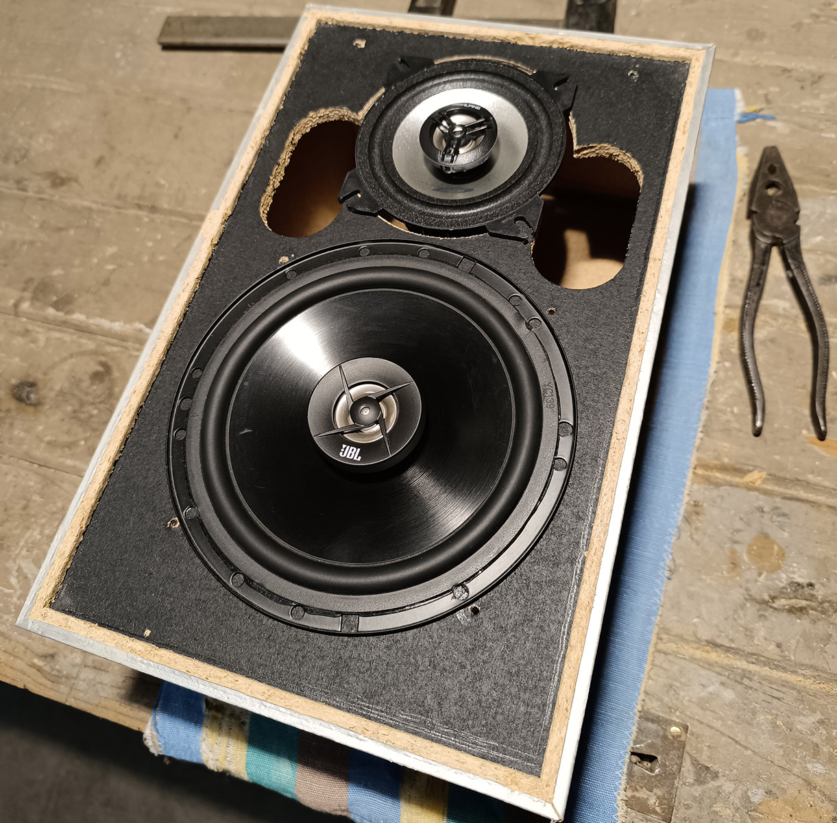

And make two wood pieces by hand to fill the two big slots.
Capacitor in series with the small speaker = high pass filter kinda
Disconnected central coil from second speaker otherwise I had too many highs

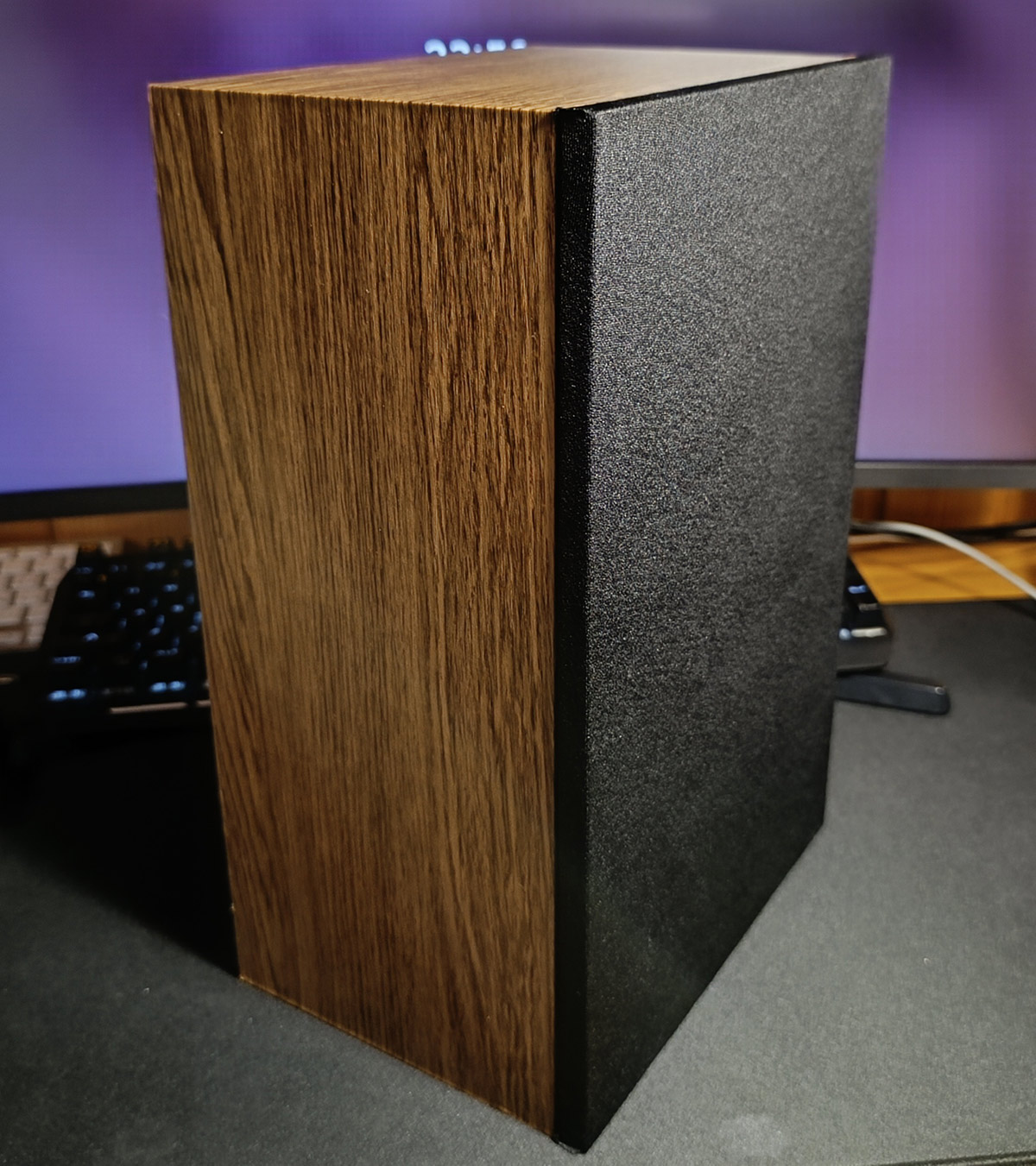

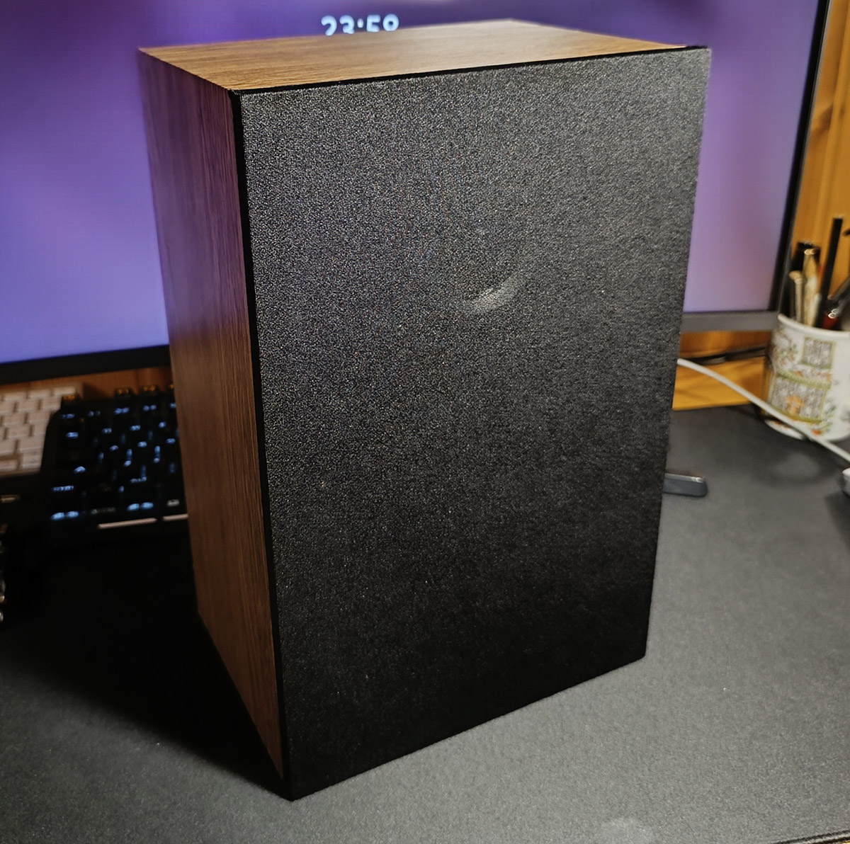

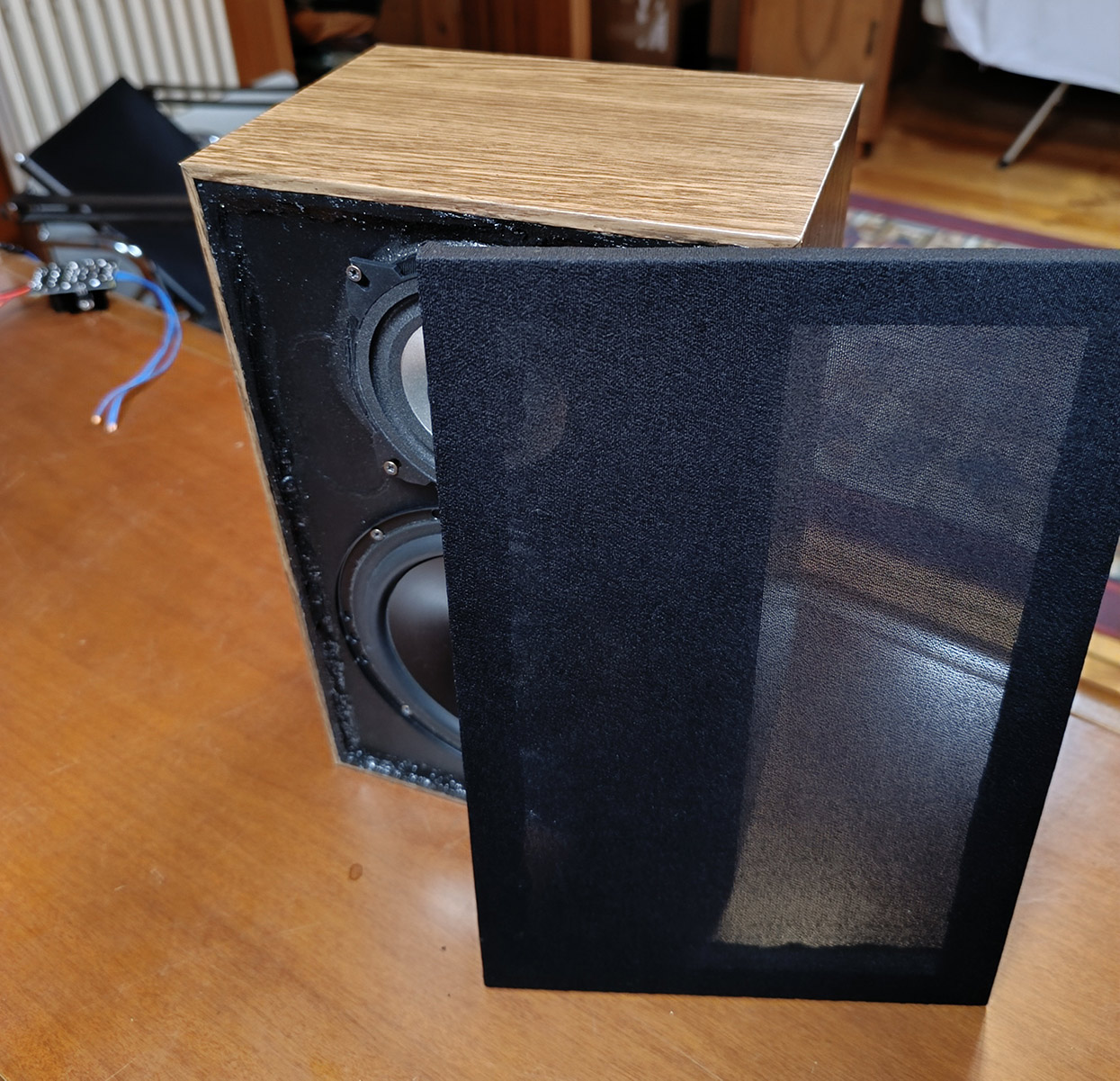

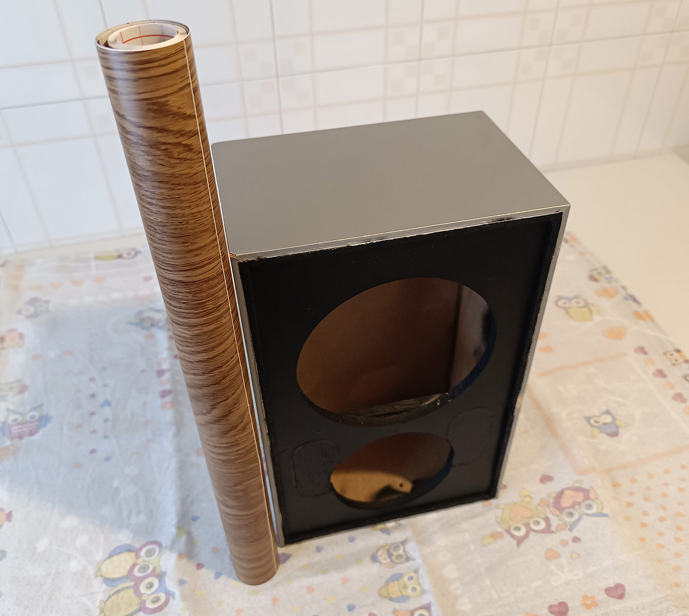

Glued everything, filled with silicone, covered the outer silver parts with some wood grain texture adhesive, and then made a front cover mesh from unused wood and old cloth.
I am currently using them with the subwoofer unit of a LM1875 based 2.1 sound system that had its satellites missing.
I wouldn’t call this Hi-Fi, but it’s pleasant enough to allow me to not always use my headphones and have my hair always messy xD
Great for youtube, videocalls, etc. Basically free as well
