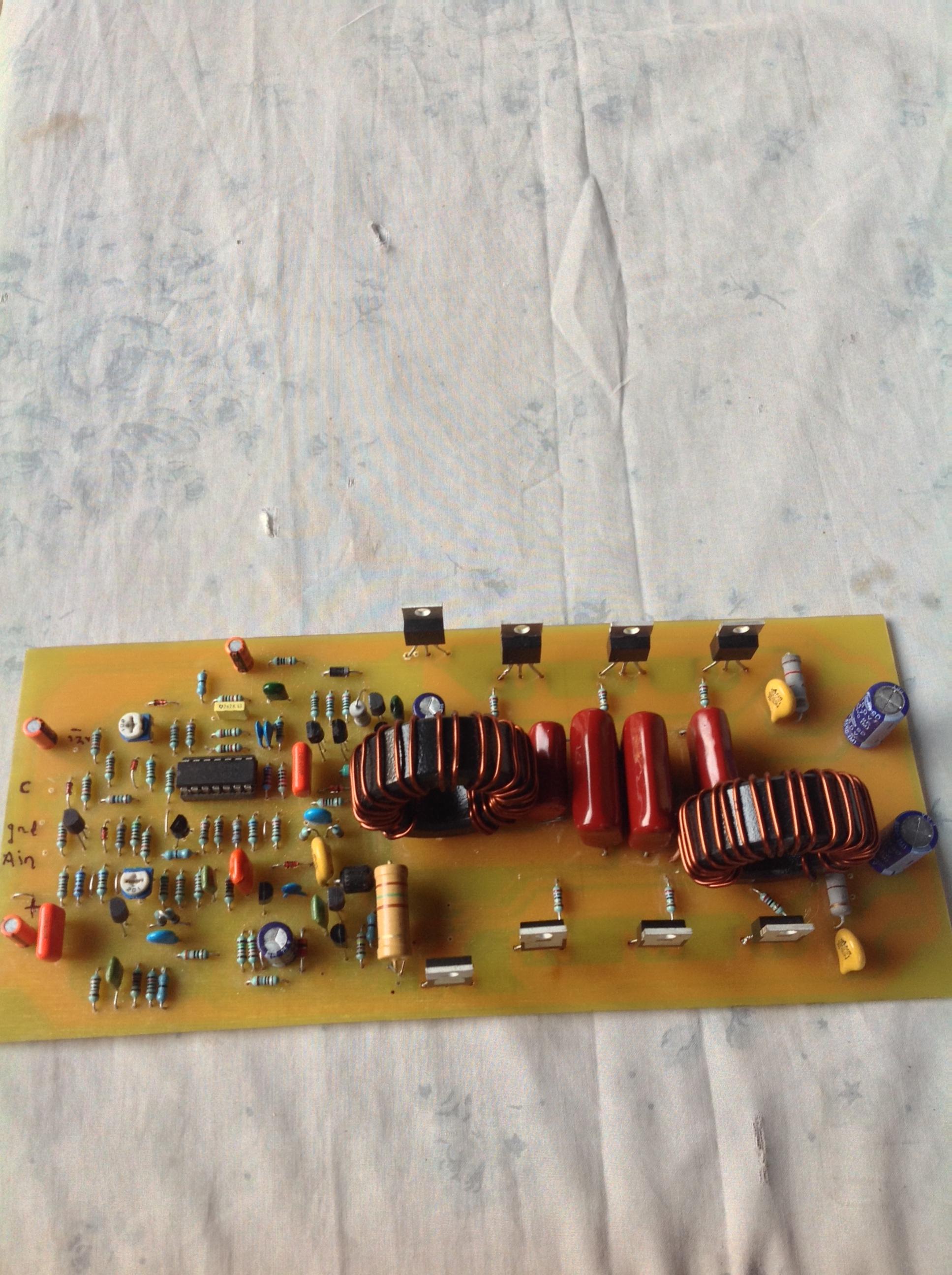

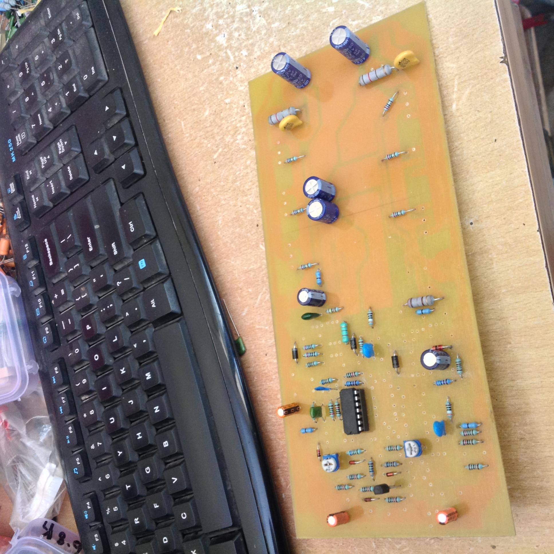

Hello ATatum
greetings nice to hear you have the sunfire TD class 2700 watt
plate amp i tried to diy the sunfire amp with guidance from Sir
mile Apex audio the out section worked fine had no problem with
it the tracking down converter negative i could not get -9volts
if its possible can you send me high resolution pics of bottom pcb
and top components maybe i could try to make it work some
pics attached of the plate amp
Warm Regards
Andrew

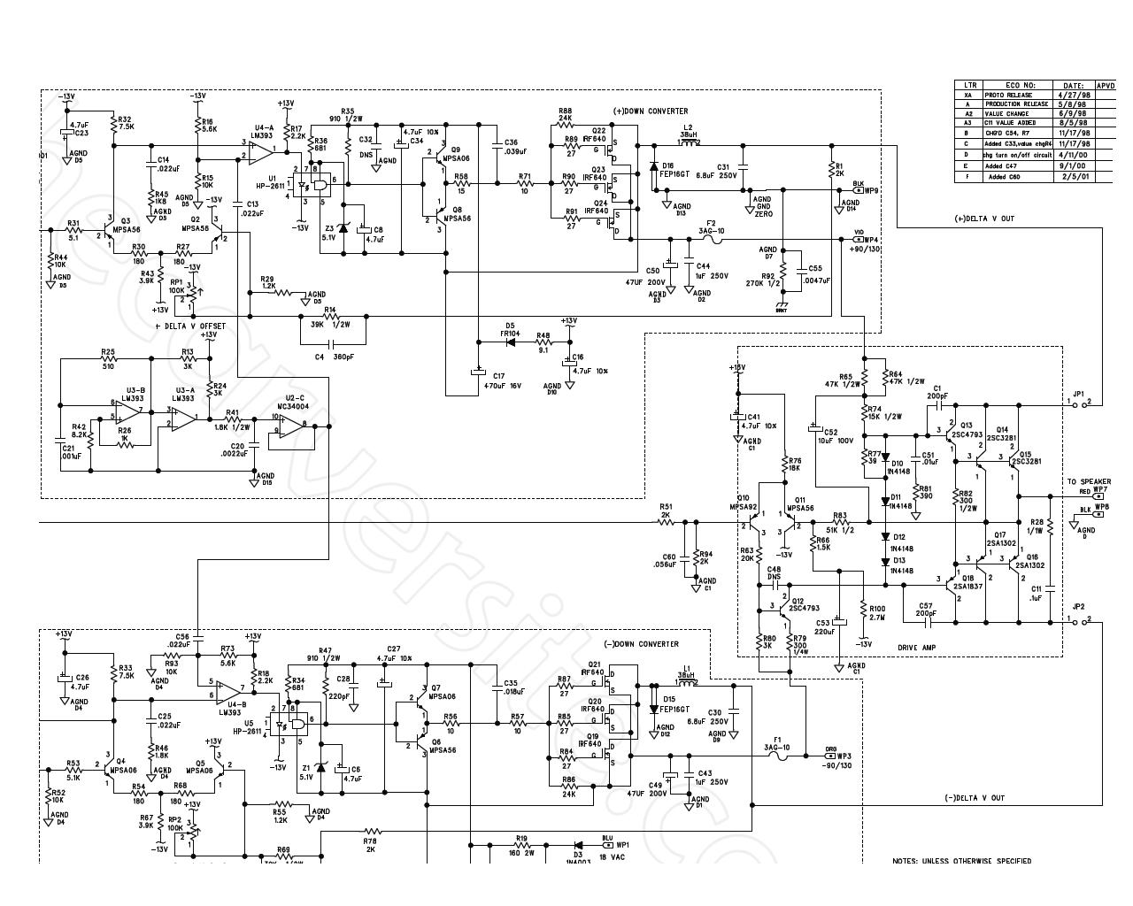

Thanks so much andrewlebon : I will get on this after work TGIFriday!
It is particularly nice to get the schematic, as I had very little luck trying to figure out what did what in the plate amp by inspection. Including such terms that I dont understand, like downward tracking!
Thanks Again, and more later.
Art
Art
