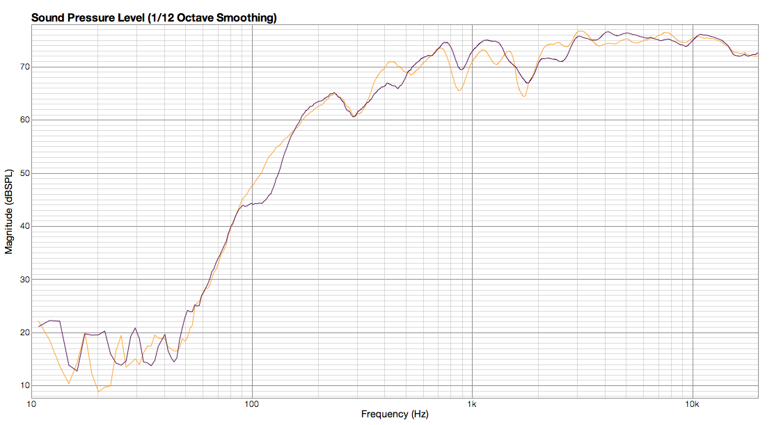

I am using Manger drivers for more than a decade and still find their basic sound quality fascinating. But they are not perfect: dispersion of HF, notch in frequency response at around 800 and 1600 Hz and high distortions at that frequency range. Manger developed new speakers but there is no upgrade of the driver itself for more than 2 decades.

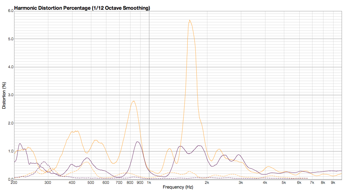

I found Moongel .: RTOM Corporation :. which is used for damping drums and thought to try it on the MSW as they are quite cheap. No effect when used in the periphery of the outside or in the center of inside. But there was some positive effect when the moon gel was applied at the center of the MSW on the frequency response and much more significantly on the distortions levels of the midrange. (filtered at 400HZ)
yellow: MSW alone
dark violet: MSW + Moongel at center

One thing I forgot to mention: they simply stick to the surface but can easily be removed (no glue required). 1/2 pad had close to the same effect as a hole one. And I would not write about it if it would not sound better - I guess 6% distortion is noticeable.

The MSW is suspended/fixed in the center with a semisoft material on the inside of the driver (they call that structure Hochton-Reflexionsdämpfer). So adding a mass to the center should have less effect than adding it to the periphery. But I found no effect of the gel pads except when applied to the center. I did not investigate the effects on low frequency as I used a digital filter at 400 Hz. I did not investigate the lateral behavior yet.

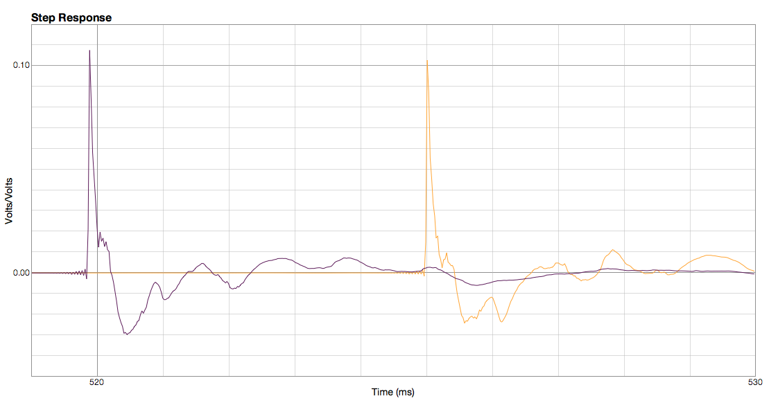

did the step response change?

with moongel app the step response goes worse ...

no way , where should the delay come from? it must be a helmholtz-type resonance that is coupled to the diaphragm and steals energy ...

The mechanical energy will travel from the coil both to the center and to the periphery(at all frequencies). Manger claims that the center structure is to dampen high frequency and on the periphery low frequency. The moongel had an effect only at the center. It reduced distortions not only at 1.6kHZ. The waterfall plots with the gel show much faster decay at 400Hz and above 1000Hz but not between 600 and 1000Hz. The improvements frequency wise are reproducible but minor.

The major improvement is in the distortion. With a sine sweep the untreared MSW makes a high pitched noise at some frequencies that is gone after the treatment. I think the improvement is substantial.
