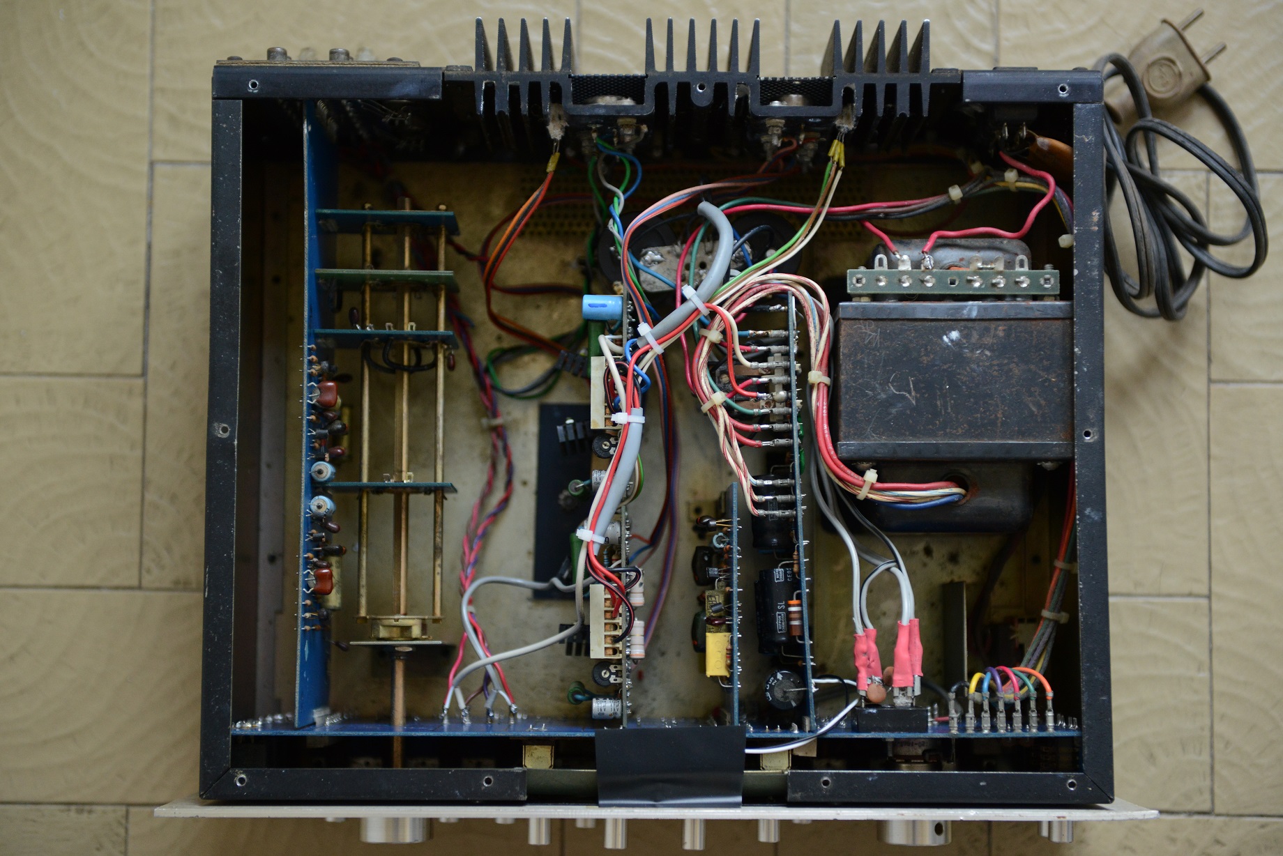

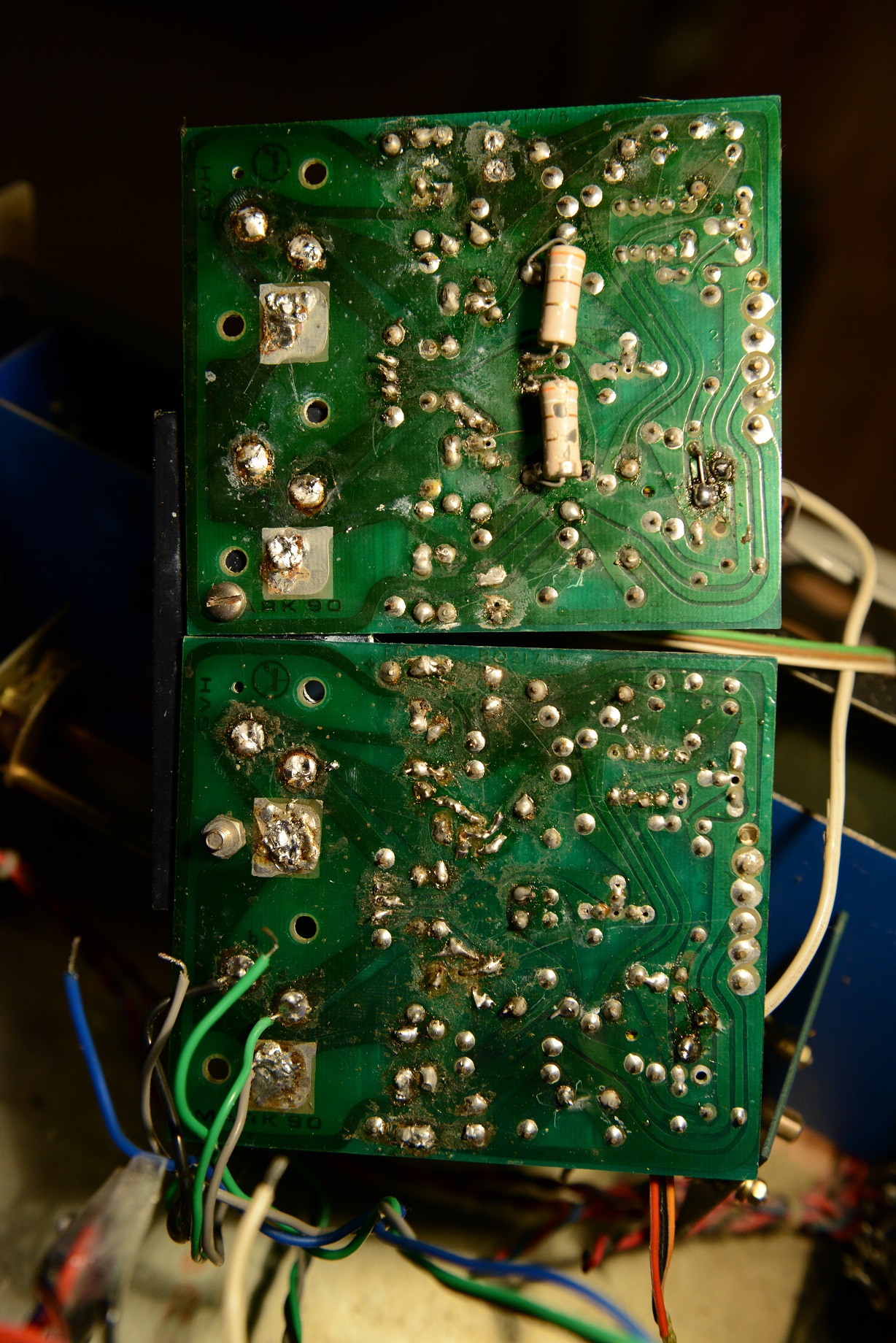

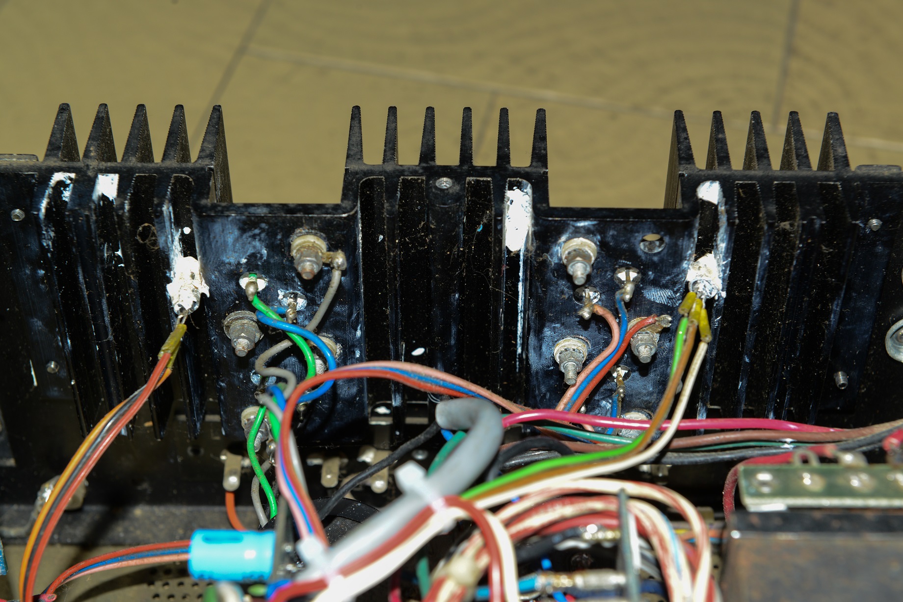

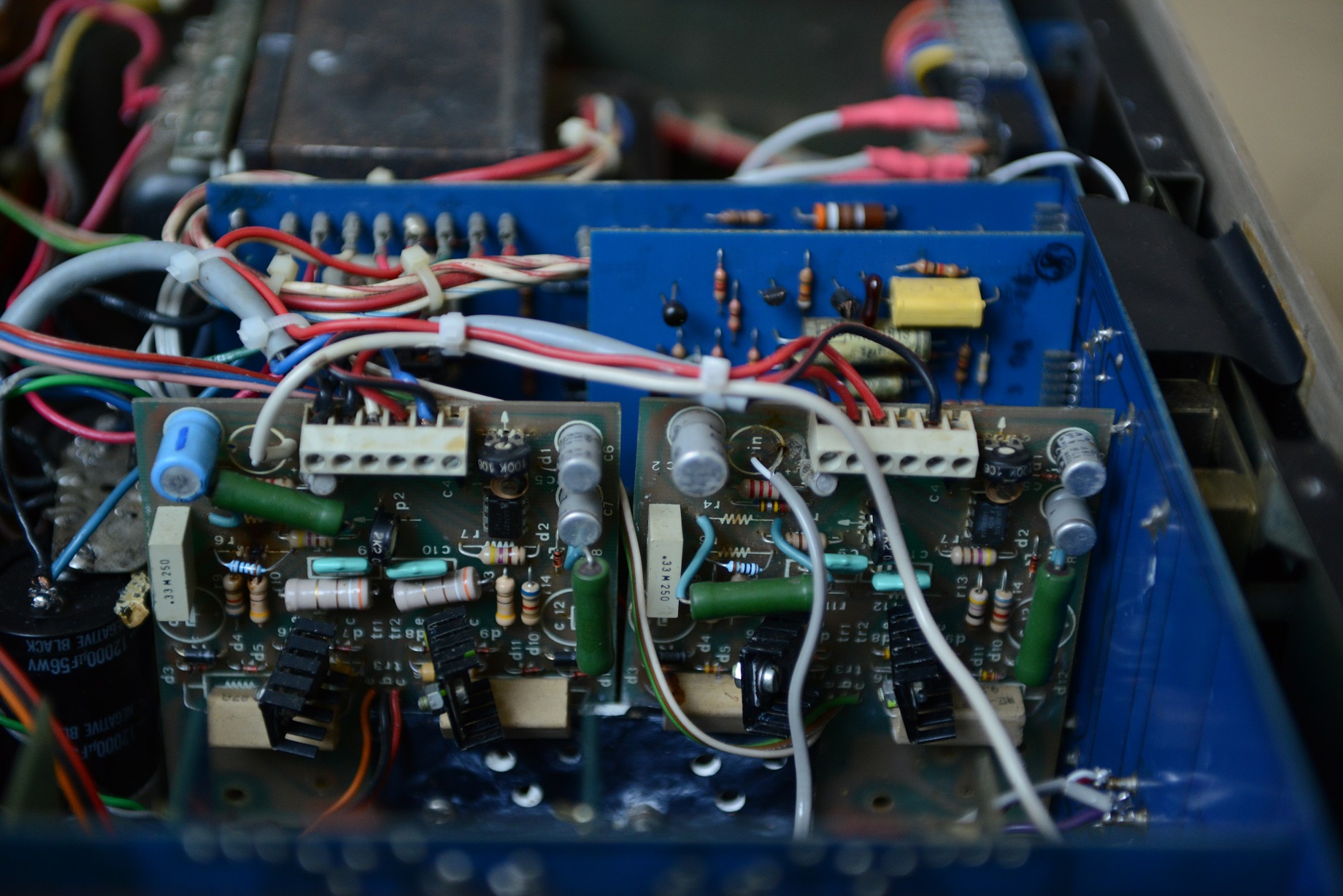

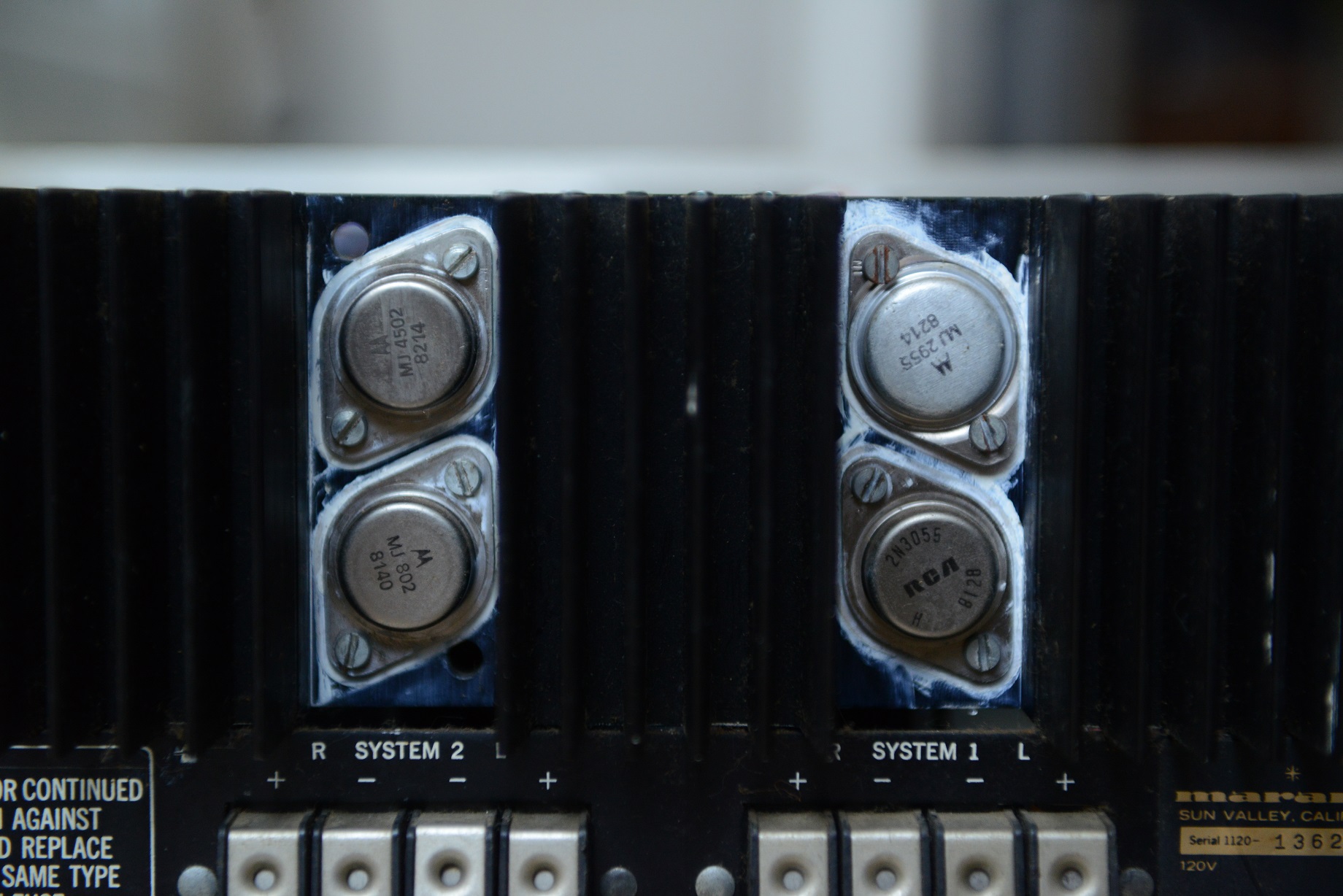

I bought it in working condition but when I pulled the cover, the well built last american made Marantz model had gotten its insides all messed up. The original power amp board was gone and had been replaced by some other dodgy looking board with all kind of different transistor on both channels, some very poor solder joints and a few leaky capacitors. Everything was connected to the output transistors (4 different models and brands) and the power supply (that had also been modified partially destroying the tracks) with a whole lot of very poor quality wires. The case was damaged and rust started to form on the connectors and the transformer. The feet were also missing.
I started by pulling everything that wasn't original and getting the power supply back to original. At that point the amp worked perfectly as a preamp.

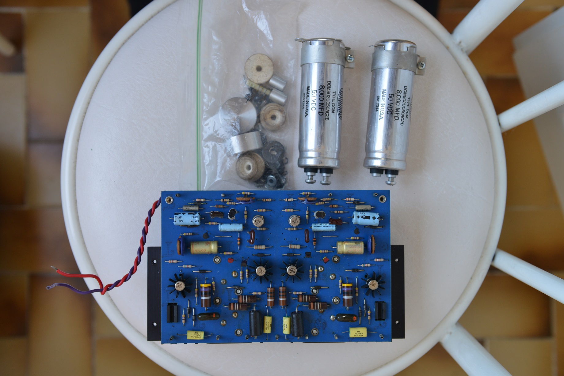

I managed to find a power amp board with the original power transistors in working condition. the seller added some other parts and screws some of which came in very handy.

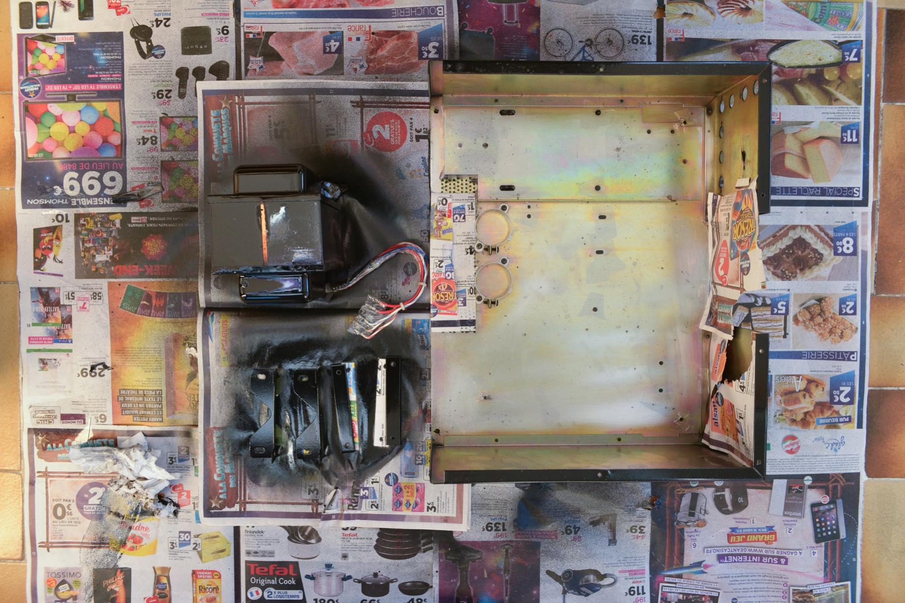

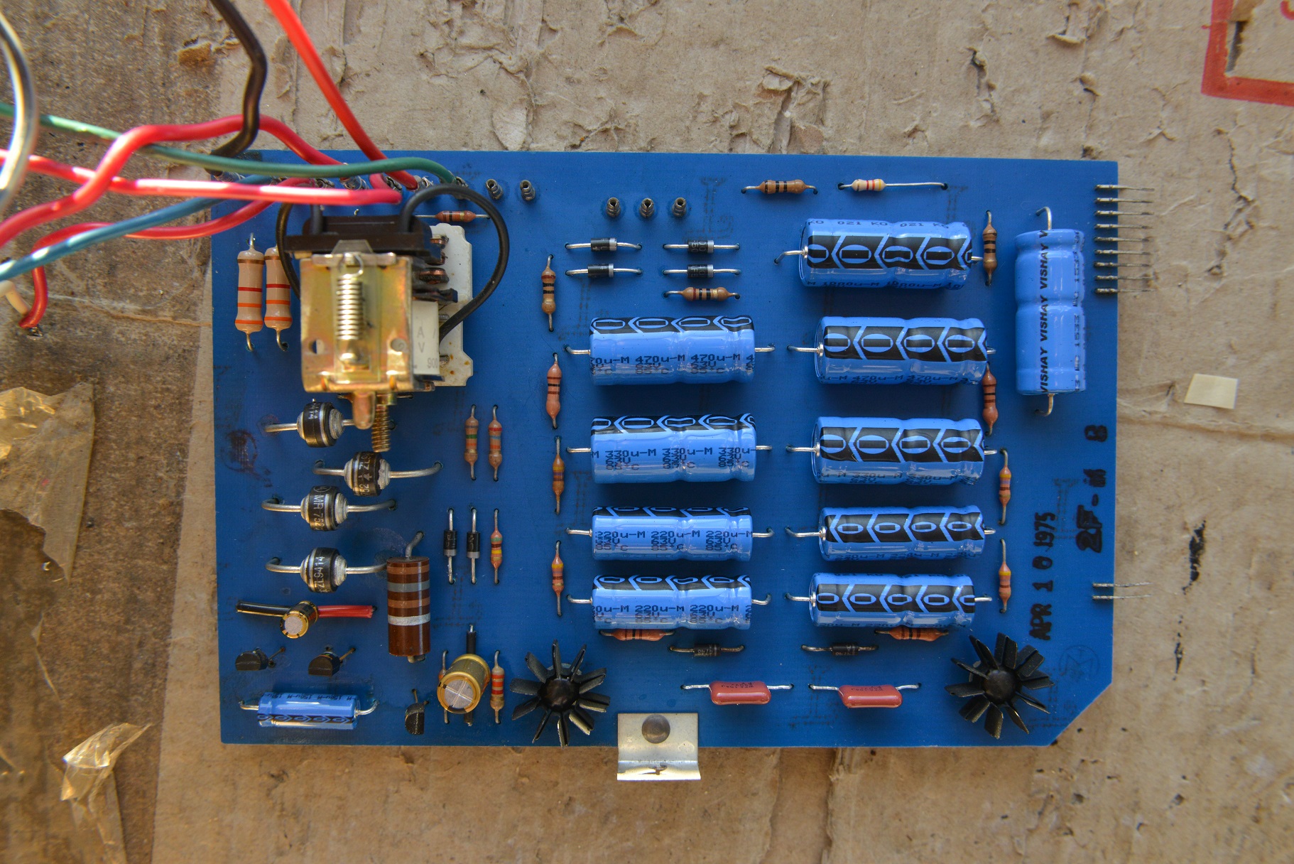

Next thing was a full recap. I pulled all the boards out and gave the case, and transformer a good cleaning and respray.

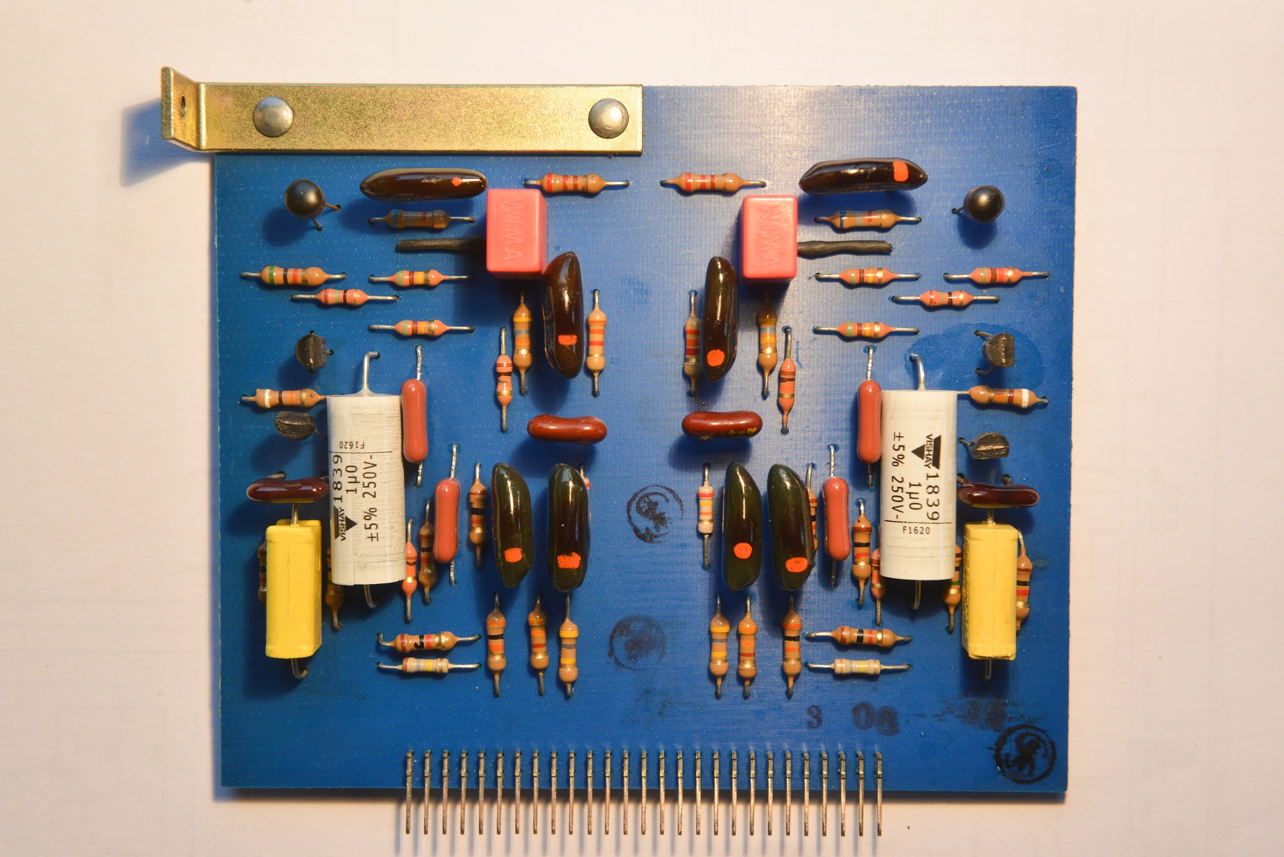

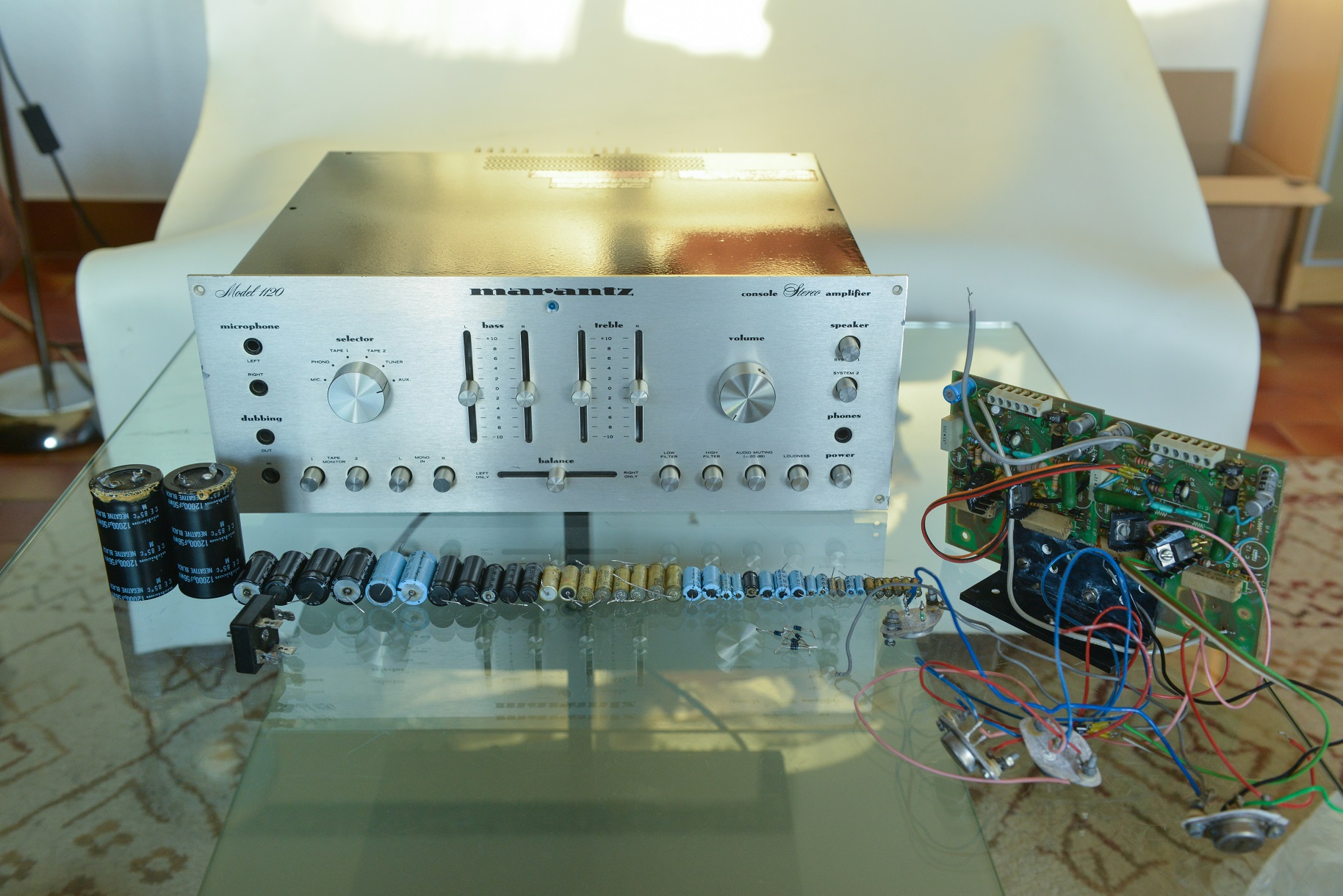

For the filtering caps I went for some screw terminal (as original) cornell Dubilier 12000µF.

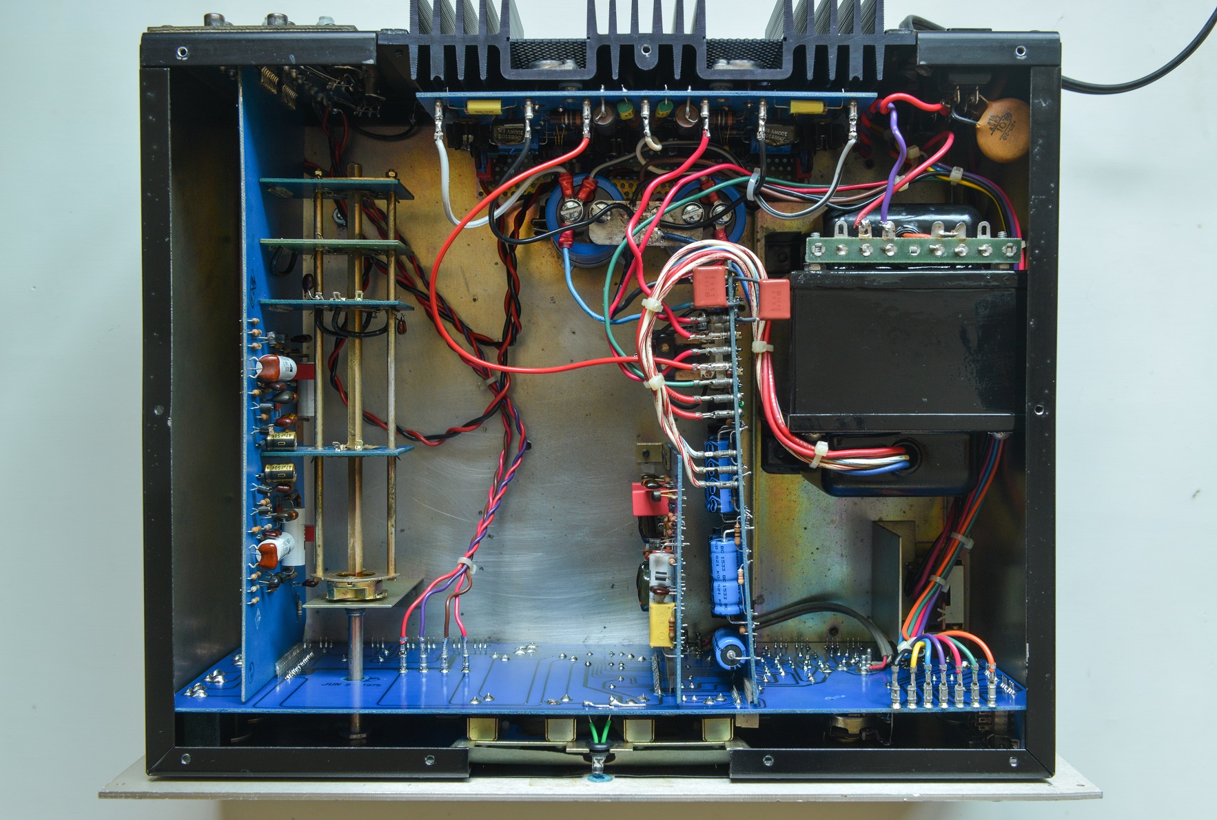

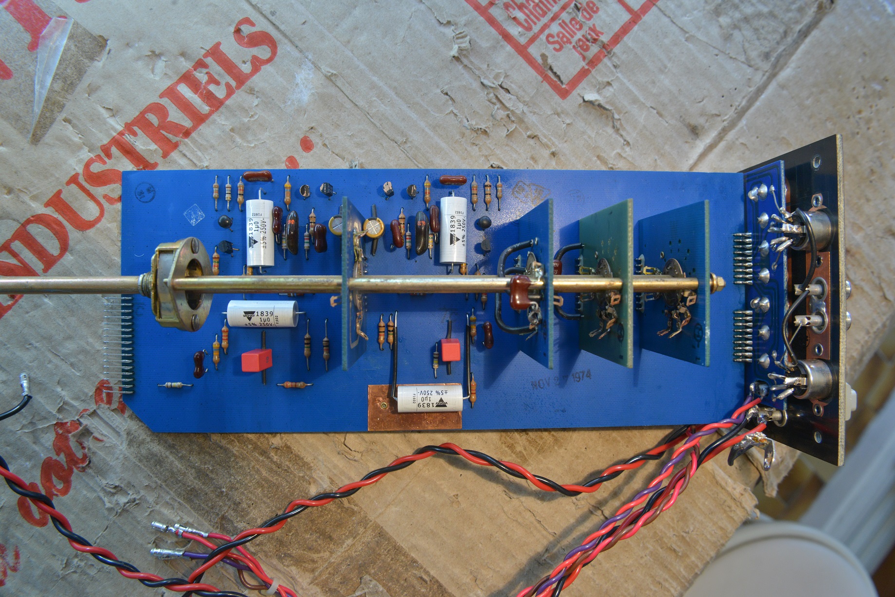

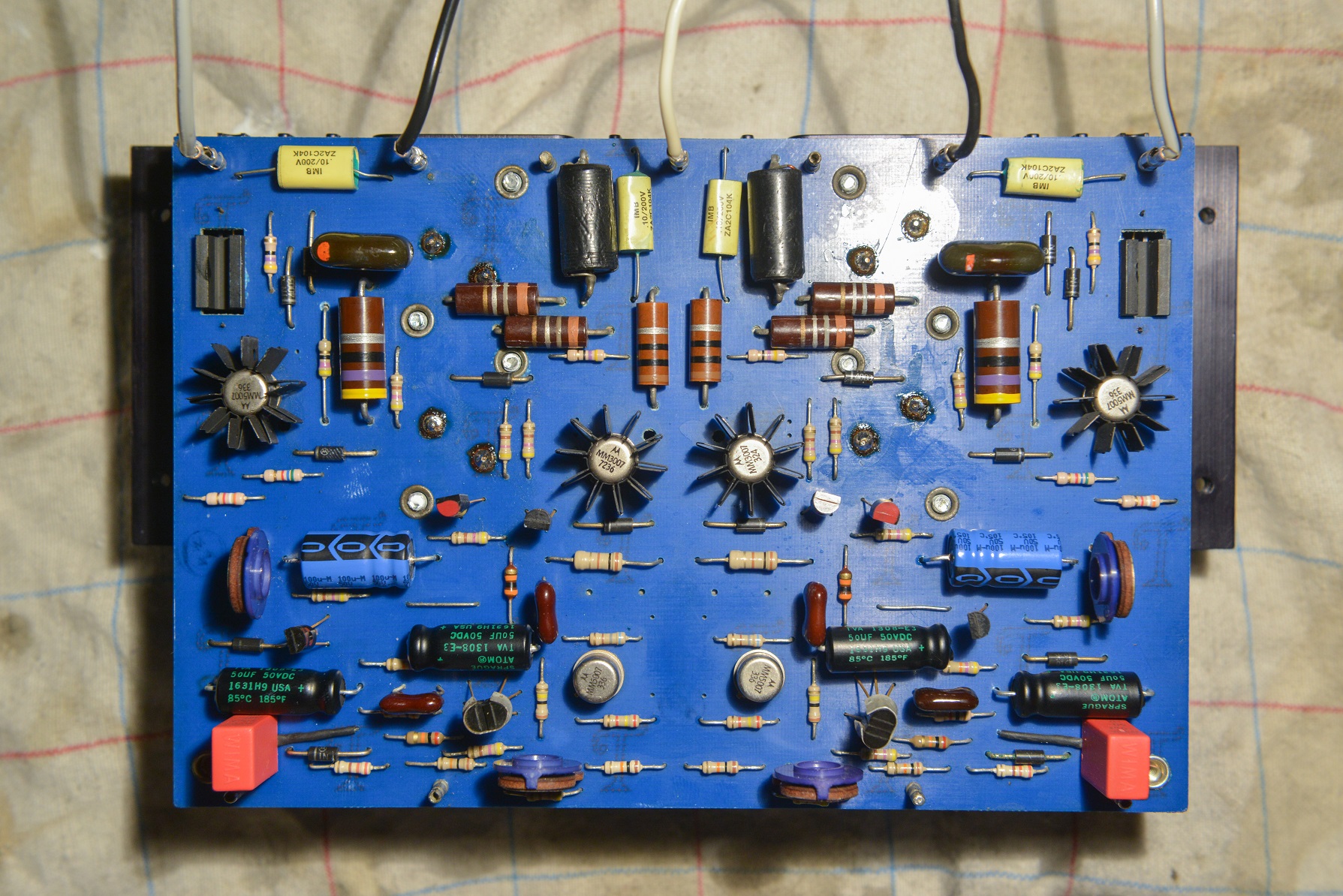

All the boards recapped (I based the choice of capacitors on different existing threads about this model)

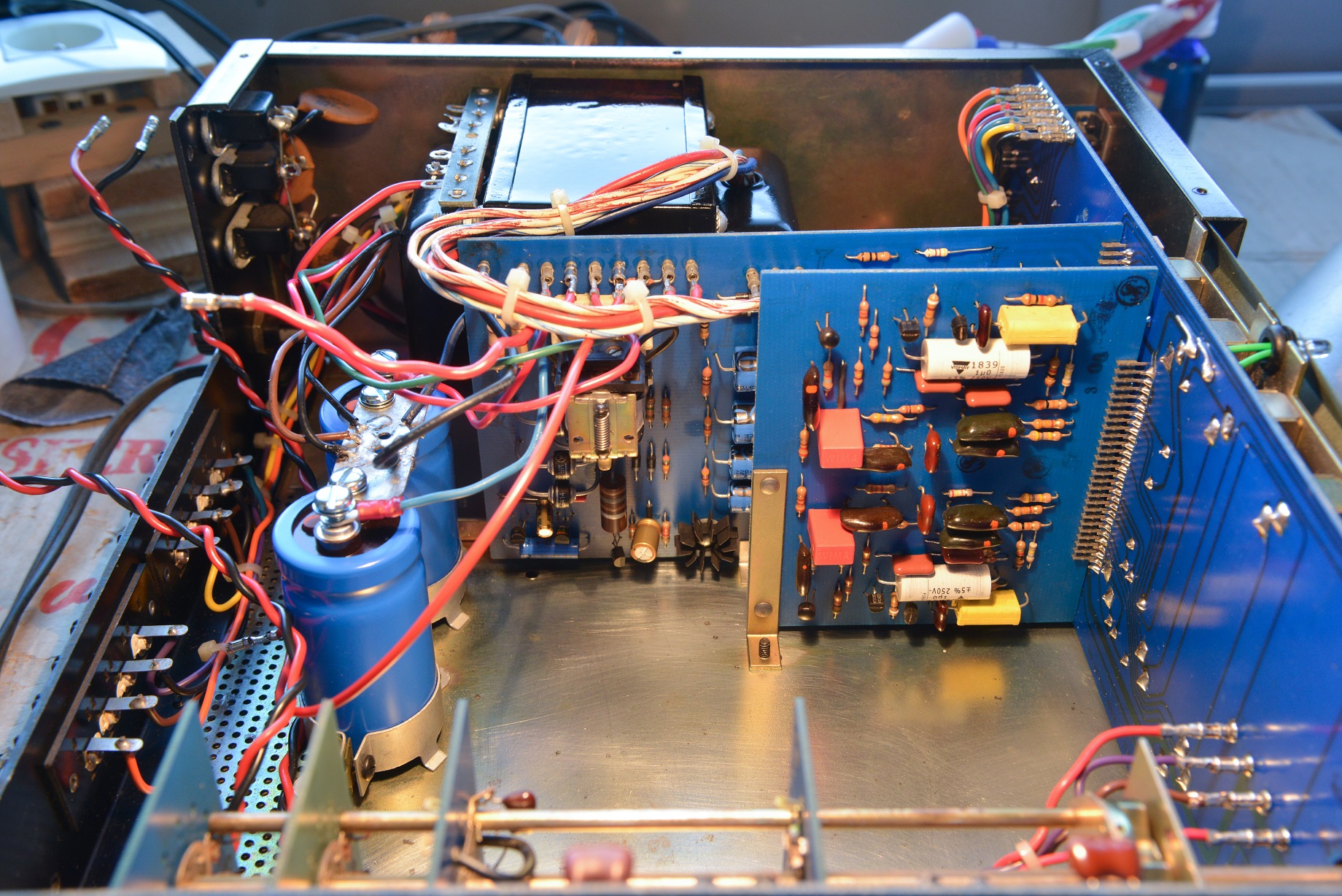

Last but not least, reassembling and rewiring the whole amp, cleaning the faceplate, potentiometers and relay contacts, setting bias and offset and mounting the new feet.
