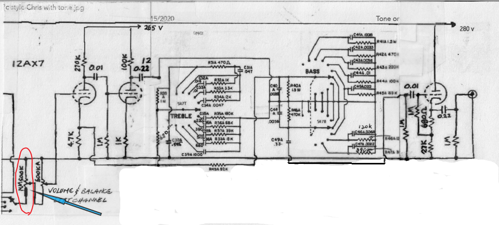

First off, please forgive the smudged image showing a potential somewhat reduced version of the 7C tone stack side minus the hi and lo filters and output trim pots.

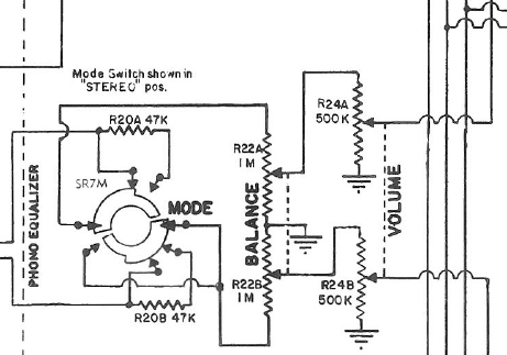

My plan is to utilize a single gang pot per left and right channel for balance control instead of the dual ganged type in the original. The 7C used a dual ganged 1 meg pot for balance control.
Two questions on this: Can someone tell me how many ohms of the 1 meg total the balance pot presented to the circuit when at detent straight up 12 oclock position?
And, noticed Chris Ruggiero used a 500K balance pot instead of a 1 meg for his stripped down version. I happen to have on hand two PEC 500K single gang pots and was hoping to use them in place of the dual ganged 1 meg pot. Any reason this would be a bad idea from a functional or sonic standpoint?

That would be fine, no problem. The phono stage, or any line input, can easily drive such high resistances.
The normal setting of the Marantz balance control has 500k in series, and 500k in shunt, for each channel.
Removing that control will give you +6dB more gain for all inputs, and 6dB lower noise at a given
playback volume. This is very worthwhile to do.
After replacing the original pot with two single pots, you would normally have both pots at maximum,
and only reduce one if needed for channel balance. This is much better than using the original pot.

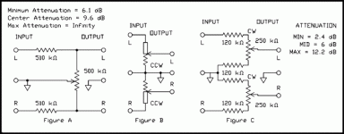

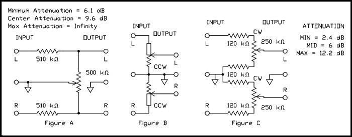

Any chance you could point me in the direction of anything showing the series/shunt layout of this type of balance pot. I guess they were shooting for a constant load impedance?
See your diagram in post #4. Center of rotation is the normal setting for that pot.
Marantz used a standard dual pot for the balance control, that's why it is normally at half rotation.
Others (like Dynaco) used a special dual pot with a shorting track for half of the rotation in each section,
so at the center setting there was no series resistance, and no needless level loss happens.
See the schematic here, figure "B". Notice the two pot sections are wired opposite to each other,
so that when one section attenuates, the other pot section output remains constant.
I follow now, makes sense. I had jumped off track and was thinking more along the lines of an Lpad. I had seen the drawing showing the pot Dynaco uses and didn't look long enough to see the symbols representing the shorting tracks. Interesting device.
Thanks for the info!
