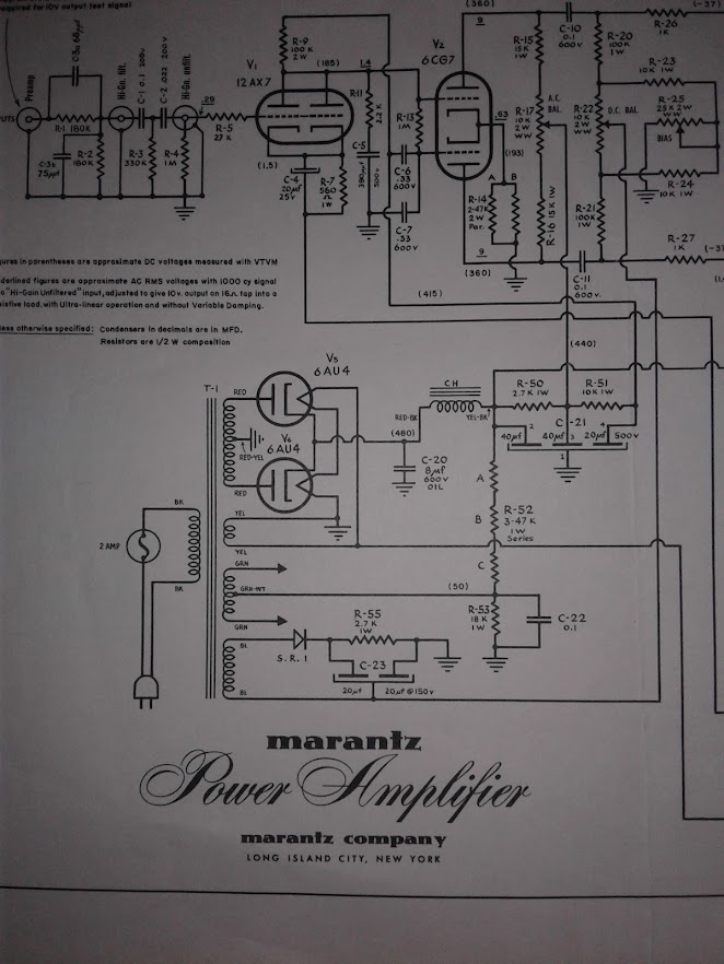

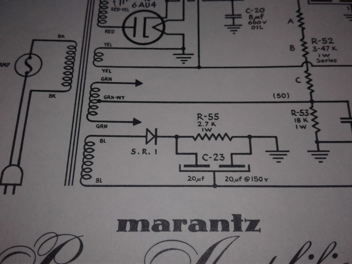

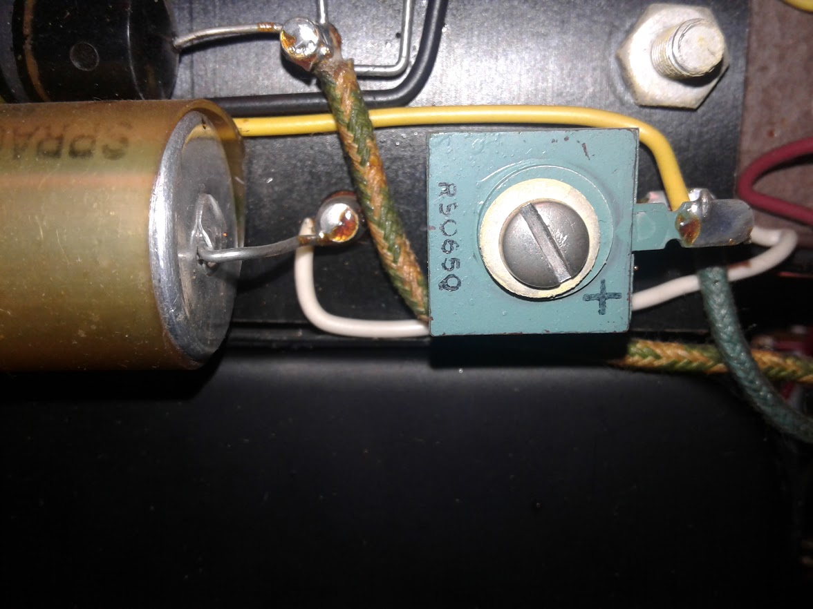

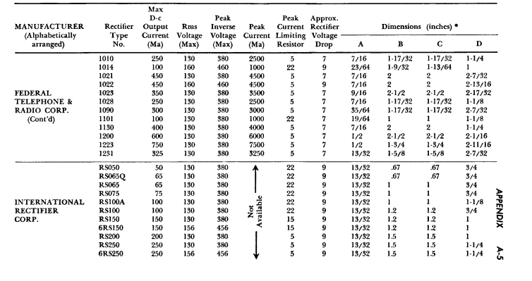

In the example I have, it has a blue colored selenium rectifier marked RS065Q manufactured by the International Rectifier Corp. My concern is that the Rider Manual doesn't list peak current (not available? according to the listing) I found its specs here https://worldradiohistory.com/BOOKS...tifiers-And-Crystal-Diodes-Theodore-Conti.pdf
So how do I come up with a suitable silicone diode/resistor replacement for it? Anyone have any experience with this particular Selenium and know what it can and should be replaced with? The schematic is no help as it only lists the selenium as S.R.1 (sELENIUM Rectifier 1) see schem attached

The selenium rectifier should be replaced with a 1N4005 diode or better, with a series 1k 2W resistor.
The original part should be considered hazardous.
The 6AU4 is the HV rectifier, having one diode per envelope.
Scant information out there on this very rare amplifier and I want to be dead careful in restoring it before I do a dim bulb test and if good power it up slowly and incrementally.
The tube complement seems to have been consistent throughout its 3 or 4 year manufacturing run, consisting of 2 X EL34/6CA7 1 x 12AX7 1X6CG7 and 2 X 6AU4 (Damper Tubes?)
