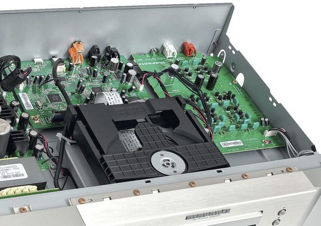

probably 6005 sound better as dac (he have input) or cd ,that is good for in the marantz ,take a look at discrete output stage ... I don't see the small trafo for spdf.......
Cant see it either, possibly a poorer implementation of SPDIF. What I can see however is a huge amount of empty free space in the chassis. Reminds me of Amstrad tape decks and amplifiers in the early 80's, big impressive boxes and tiny internal circuit boards😀

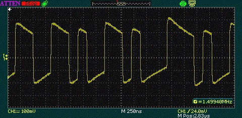

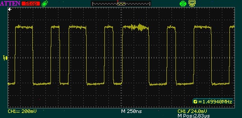

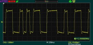

Using the CD620 as a transport-only, I was interested in the Lampizator Philips CDP S/PDIF coax output mods and decided to do similar on the CD620 i.e. take the DOBM digital output on SAA7220 pin 14 direct to a new RCA coax output, bypassing the on-board Philips standard implementation. I used 2 x 150R resistors as a 6dB divider (75R source) with the recommended 100nF disc ceramic blocking capacitor. This way I could compare the existing digital coaxial output with the modded one. I have attached some scope pics of the digital output waveforms across a 75R termination resistor at the end of a 1 metre length QED Qunex 75 Ohm cable. Despite the obvious differences in the signals, after some hours of comparative A/B listening I could not detect any significant tonal difference and came to conclusion, as probably many others did, there was no difference in the sound quality. The original Philips implementation of 74HC08 buffer/divider resistors/pulse transformer was probably pants (OTT) but it does the job adequately. While i had the case open, I replaced all the old 33u/47u/330u Nichicon decoupling electrolytics around the TDA1541A and SAA7220 with 220u/470u all bypassed with a 220nF MKT. Don't know if that has made any difference but it made me feel happier to replace these 26 year old capacitors! I might do the PSU caps if I have some spare time.
I will leave it hooked up to my modded coax output because the signal looks prettier and the stronger 900mVpp signal across the terminating 75R load resistor (in DAC player) will make me feel happier😀.
