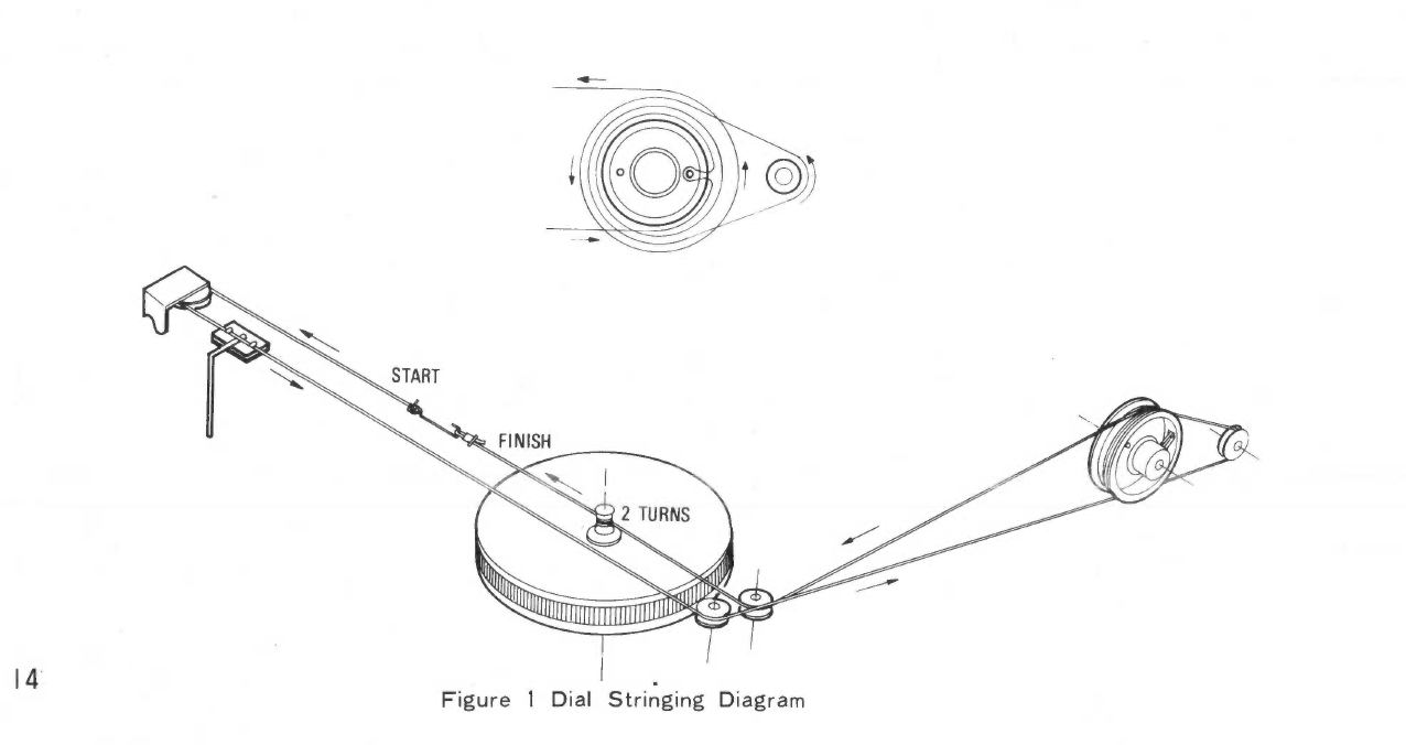

D Djpadilla Member Joined 2023 2023-11-02 6:12 pm #1 2023-11-02 6:12 pm #1 I am looking for tuner string diagram for a maranta receiver model 28 Mooly Moderator Joined 2007 Paid Member 2023-11-02 6:17 pm #2 2023-11-02 6:17 pm #2 Moved to Analogue Source forum 🙂 Mooly Moderator Joined 2007 Paid Member 2023-11-02 6:20 pm #3 2023-11-02 6:20 pm #3 If it is similar to the Model 28 then is the layout. You must log in or register to reply here. Share: Facebook X (Twitter) LinkedIn Reddit Pinterest Tumblr WhatsApp Email Link
