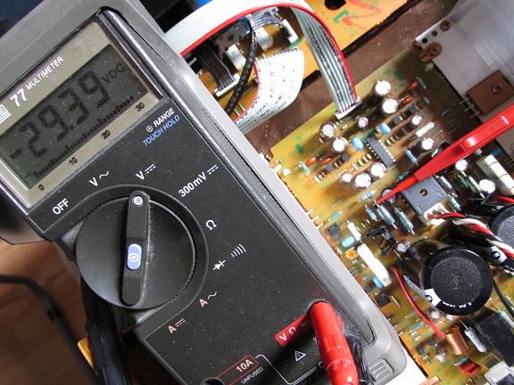

I recently purchased a Marantz PM-66SE KI Signature (the same circuit as the PM-40SE, PM-44SE and PM-66SE, but with a toroidal transformer, a sprinkling of 'boutique' capacitors and a copper-plated chassis.
N.B. The PM-66* variants have an extra transformer winding for the remote control features.
Whilst it appeared to be fully-functional (** I normally listen with the 'Source DIRECT' button engaged **), I was concerned by the amount of heat dissipated by Q801 & Q802.

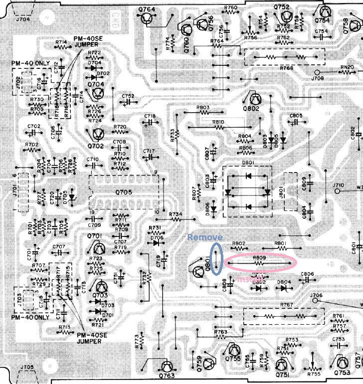

I resolved to reduce the amount of heat dissipated by these transistors with the minimum amount of circuit modifications and parts.
I noted that R802 had been replaced. I also noted that Q801 was loose! Too much heat in a TO220 package.

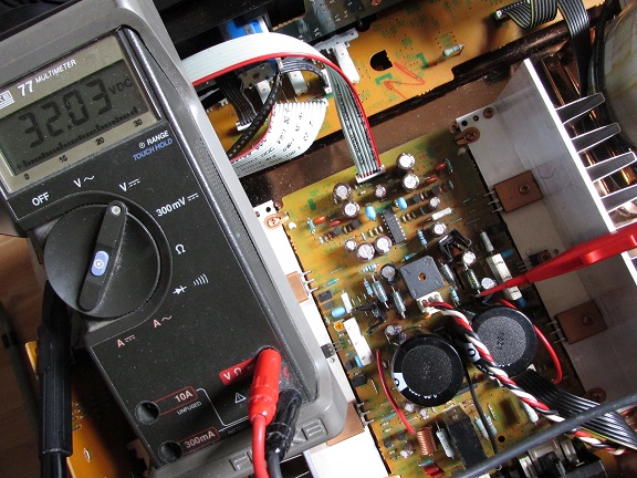

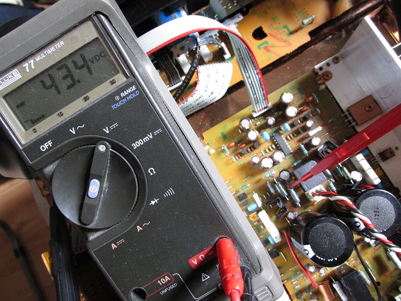

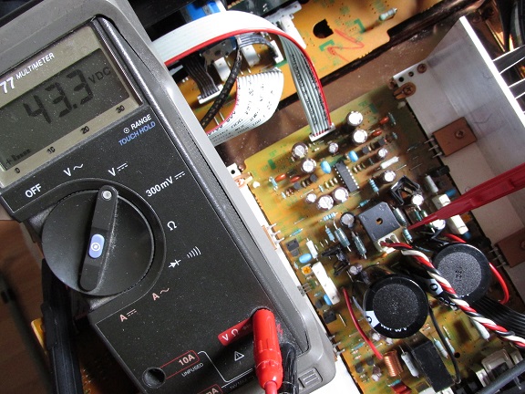

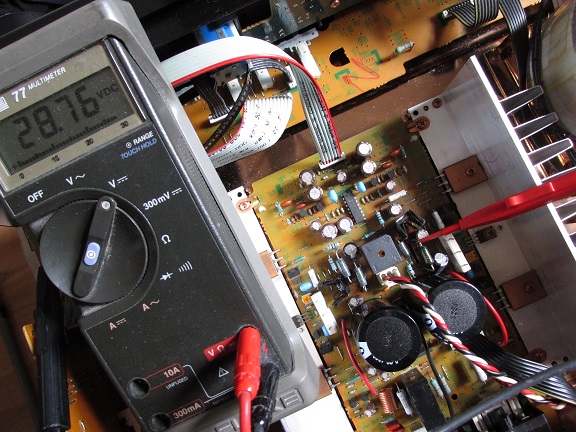

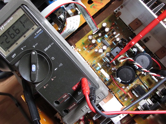

After measuring the voltage drops across R802 (47R / ~5V drop) and R804 (47R / ~3V drop), I determined that the +24V rail was supplying ~100mA (worst case - speaker + source direct relays engaged) and the -18V rails was supplying ~66mA (worst case - ALL LEDs illuminated).
It's not surprising that (according to 'the Internet') R802 is the most common failure with these amplifiers - it's severely underrated. It's a design oversight!.
R804, D804 & D805 also take a beating in the default configuration.

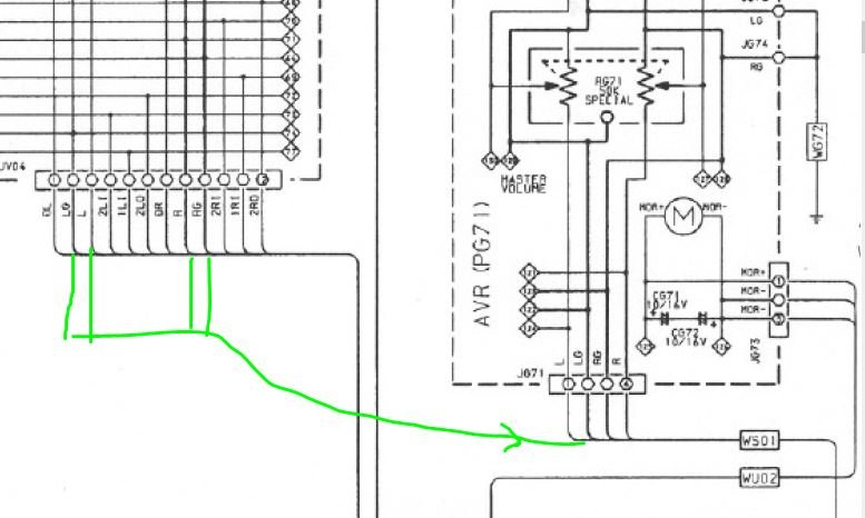

** When I disengaged the 'Source Direct' relay, I lost the right channel (intermittently). Re-engaging the 'Source Direct' relay restored the right channel (always).
After replacing ALL the semiconductors and capacitors, the amplifier was completely destroyed. 😱
The above sentence is completely untrue and is precisely what happens when you believe 'misinformation' on the Internet. 🙄
The right channel could be restored (temporarily) by moving the large ribbon cable (WV01), but would disappear minutes/hours later.
After chasing the intermittent problem, I discovered that the (never used) 'Balance' control had been 'whacked' by a previous (l)User.
Resoldering ALL the pins restored normal operation (but for how long?).

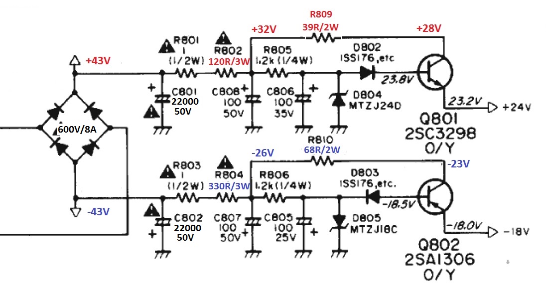

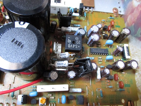

Iteration 1
As I had a 5 pack of 150R/2W wirewound resistors, I replaced R804 with a 150R/2W wirewound and R802 with a 75R/4W (2 x 150R/2W in parallel) wirewound. I also removed the wire link adjacent to Q801 and installed a 75R/4W wirewound in R809 (which Marantz thought about, but didn't fit). This further reduces the strain on Q801.
Heatsinks were attached to Q801 & Q802, power applied and measurements taken.
Although the transistors were cooler, I felt that further heat reductions could be made.

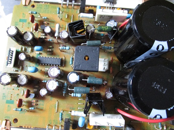

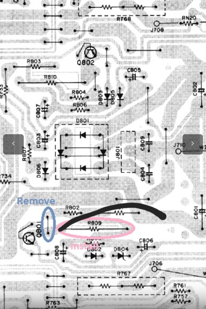

Iteration 2
Criteria: 5-10mA(max) through the Zeners/6-12V(max) across R805 & R806. Minimum heat dissipation in Q801 & Q802.
R802 120R/2W(min)
R804 330R/2W(min) (350R/3W preferred, but would be a 'boutique part)
R809 39R/2W
R810 68R/2W
Unfortunately, I didn't have a 330R/3W wirewound, so I used a 270R/2W wirewound.
Now that R802 & R804 are doing most of the 'heavy lifting', I can now keep my finger on Q801's heatsink!
C801, C802 and D801 were also replaced.
Parts were purchased from RS & Farnell.
Apart from the heatsinks, no audiophool 'boutique' parts were used.

The original power transformer likely had an internal thermal fuse. If it failed due to overheating or any other reason, the transformer would wind up just as useless as it would be if burnt out due to overload.
It's not clear in your posts, but according to the voltages shown on your schematic snips, you or the previous owner must have replaced the power transformer with one that has some 4VAC higher output. If so, this would certainly be the reason for an overheating problem and failure of the fusible resistors. Is the original schematic shown in the OP with only +/-38VDC main output correct for your model? Importantly, if you persist with the transformer's higher voltage supplies, it will necessitate a re-design rather than just patching over the problem with larger dropping resistors for the auxiliary 24 and 18VDC supplies. It should also be obvious that higher voltage rail voltages to the power amplifier won't be without their problems either. Check the capacitor voltage ratings there and whether fusible resistors there are still functional too.
If the transformer is incorrect, I can't see any problem with fitting a standard dual 25VAC toroidal in place of what appears to be a stock dual 30VAC type toroidal. (if that was changed, it would have been an ill-conceived "upgrade") Then you can get back to safe operation with raw 34V rail voltages and replacing the fusible resistors with appropriate similar, original spec parts.

>9 months later... Apologies and corrections.
I may have previously posted circuit diagrams from a lesser model in the Marantz portfolio (probably a PM34, 40, 44 etc), which has lower secondary voltages. My apologies!

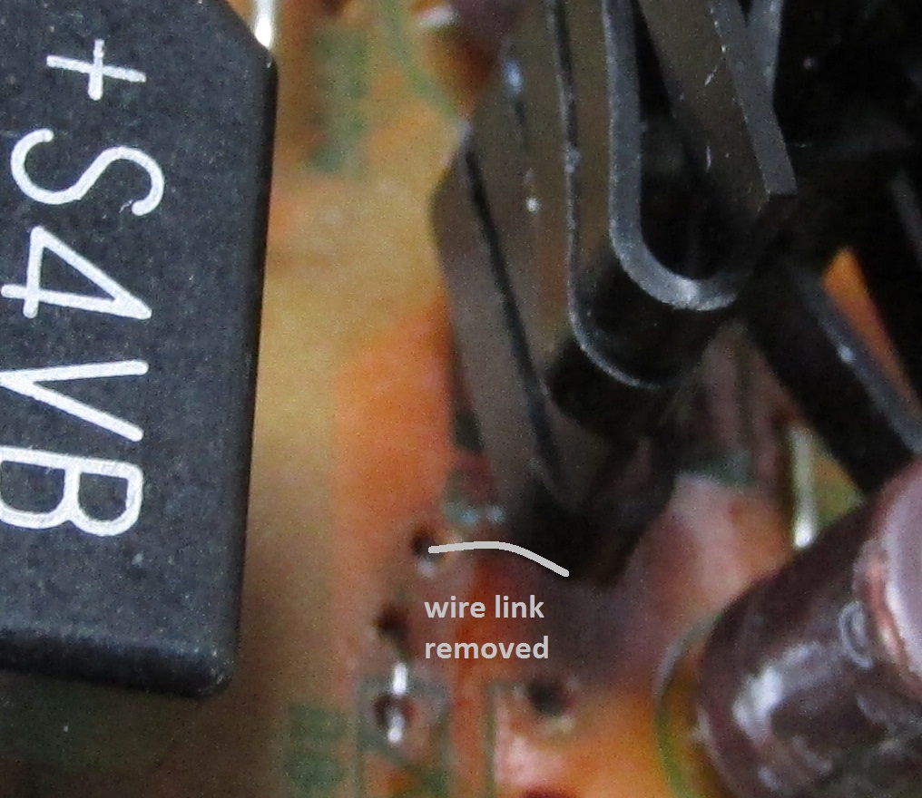

A 230/30-0-30 (+ an additional secondary winding for the uP) toroidal transformer is 'standard' in PM-66SE 'KI' models (as 'Modified in UK' by "a gang of villains in a shed up at Heathrow" - apologies to Squeeze) - it's original!.
According to the circuit diagram (widely available on the Internet), there is a thermal fuse fitted... I've not felt inclined to unwind the transformer and investigate further.
The default C801 & C802 are 12000uF/56V audiophool ELNAs, which were nicely 'domed' on the top (I believe that they have flat tops when they come off the production line).
They didn't smell bad, but the domed tops had me reaching for my hammer and chisel.
I replaced them with these 'bad boys'.
They have no audiophool pretensions whatsoever!
At £6.00 a piece, the amp sounds £12.00 better...!
In fact, after 9 months of 'burn-in', the amp sounds exactly like it sounded on the day the caps were replaced! Who knew?
Perhaps it's only audiophool caps that sound better after 100/200/(pick the latest audiophool random number) hours of 'burn-in' 🙄 🤐
I also replaced the bridge rectumfrier with something beefier.
The amp has been in daily use since I 'rationalised' the modification to 1 x 330R/3W wirewound resistor and 2 x wire links.
I can no longer hear Q801 and (to a lesser extent) Q802 screaming in pain from heat torture.
Power dissipation in Q801 has been reduced by >75%! That's a WIN!

Anyhow, Marantz came up with a better solution to the heat dissipation problem. The solution can be found in the PM57 / PM47 service manual.
And the cause of the claustrophobic sound produced by the PM66KI was the 'SOURCE DIRECT' switch - the audio signal passes through it regardless of switch position.
When I routed the signal from the input selector PCB directly to the VOLUME control PCB, the PM66KI sounded surprisingly good.
Good Luck!

Thanks! Sadly that evening I posted I messed up trying to copy you and now have no output. I accidentally soldered one leg of R809 to the wrong path and now the relay won't click on.
This is seen often with users of some cherished brands as they believe that their brand produces the cream of the crop and any criticism is not allowed. Marantz is such a brand. Cherishing brands of material stuff and becoming fanatical "herd member" is a threat to sanity and critical thinking. I once solved an issue in an A branded device with a severe design error causing a high return/failure rate and was told I was hampering a well designed device by a reputable brand.After replacing ALL the semiconductors and capacitors, the amplifier was completely destroyed. 😱
You did nice work! Removing R801....R804 and mounting an extra 5... 7VA mini 2 x 18V toroid + rectifier and 2 caps would have been a root cause solution though.
From your supplied picture (I do not currently have access to the circuit diagram), it appears that you have bypassed ALL dropping resistors and connected the COLLECTOR of Q801 directly to the +43V supply.
Q801 may have succumbed to the excessive power dissipation it was subjected to. Check Q801, replace if necessary and correct the error before re-applying power via a bulb limiter.
Good Luck!
Good Luck!
Thank you for your help. I installed a new pair today and still nothing. I'm stumped I can't see what other damage this bypass could have done.From your supplied picture (I do not currently have access to the circuit diagram), it appears that you have bypassed ALL dropping resistors and connected the COLLECTOR of Q801 directly to the +43V supply.
