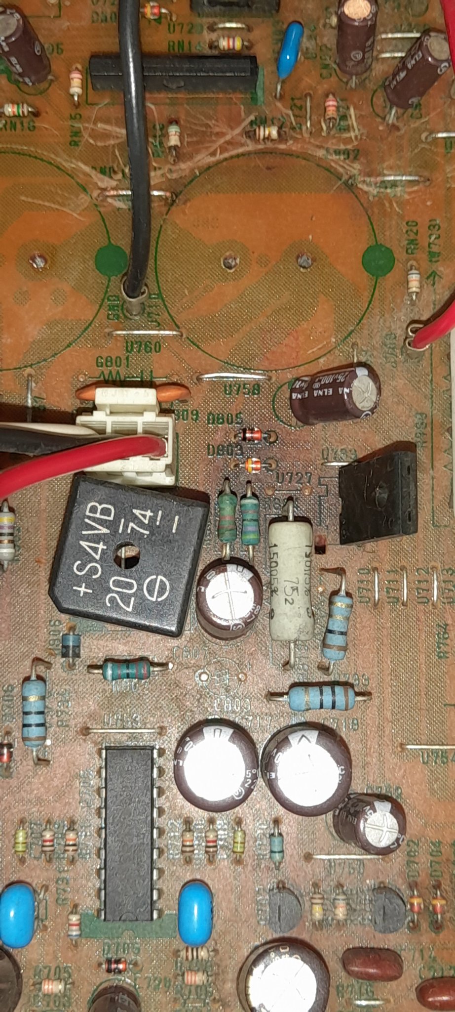

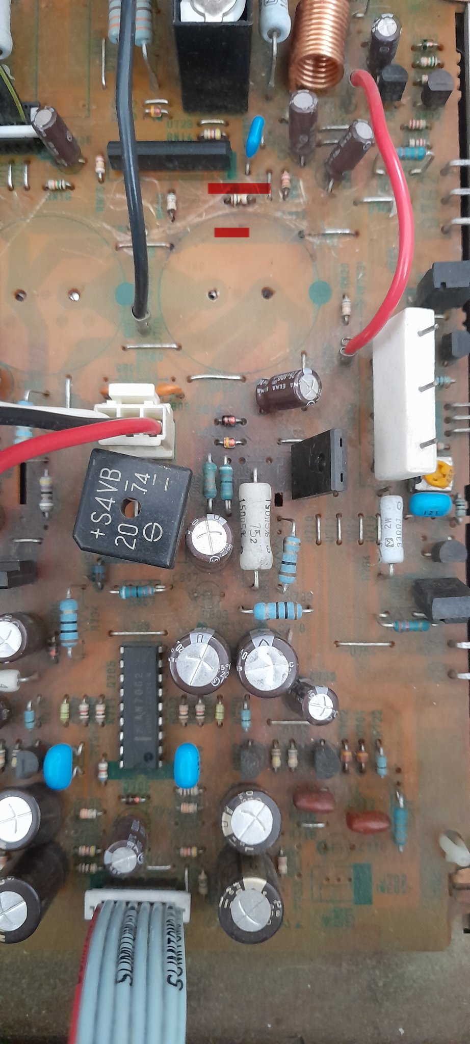

Hi guys, I have this Marantz PM66 SE KI Signature that doesn't have a relay click when powered on. I experimented with test speakers and the output sounds fine if I manually push and hold the relay with a plastic stick.
Can anyone please help a beginner out with this one? The relay doesn't appear to be pitted.
Many thanks to anyone with the patience to help!

You may have excessive DC voltage at the output (but prior to the relay contacts).
The control would not allow the relay to close if this were the case. Use a DVM and see.

Normally I would advise you to measure if there's any DC-voltage present on the input pins of the speaker relay - like rayma suggested - before doing anything else.Thanks for replying! When I press source direct I can hear the the left and right red relays clicking but the speaker relay does nothing. It plays fine on both channels if I take the cover off of the relay and push the contacts like this.
That should be step one because manually closing the speaker relay when an output transistor would have gone short circuit to a power rail would probably fry your test speakers.
Please measure for that and report back.
In the meantime I have a question. I really don't like the look of the scratches and brown spots on the pcb near those big blue filter caps. Is that your doing or does this amp have a history before you got it?

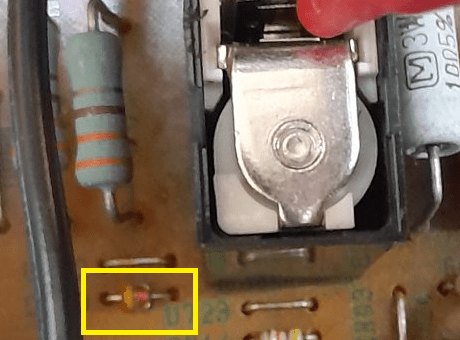

From your picture is the 330 ohm resistor mounted parallel to the coil still measuring 330ohm, or in fact is it open circuit?
I do vaguely remember it was a larger resistor of 2 -5 Watts dissipation. that I changed.

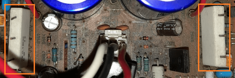

Please do as rayma advised in post #2 and tell us what offset voltage is present for each channel. You can measure this voltage on the middle leg of those large white 3 legged resistors in your picture.
Only 1x relay should click when the 'SOURCE DIRECT' switch is operated - it's on the input seelector PCB....When I press source direct I can hear the the left and right red relays clicking but the speaker relay does nothing.

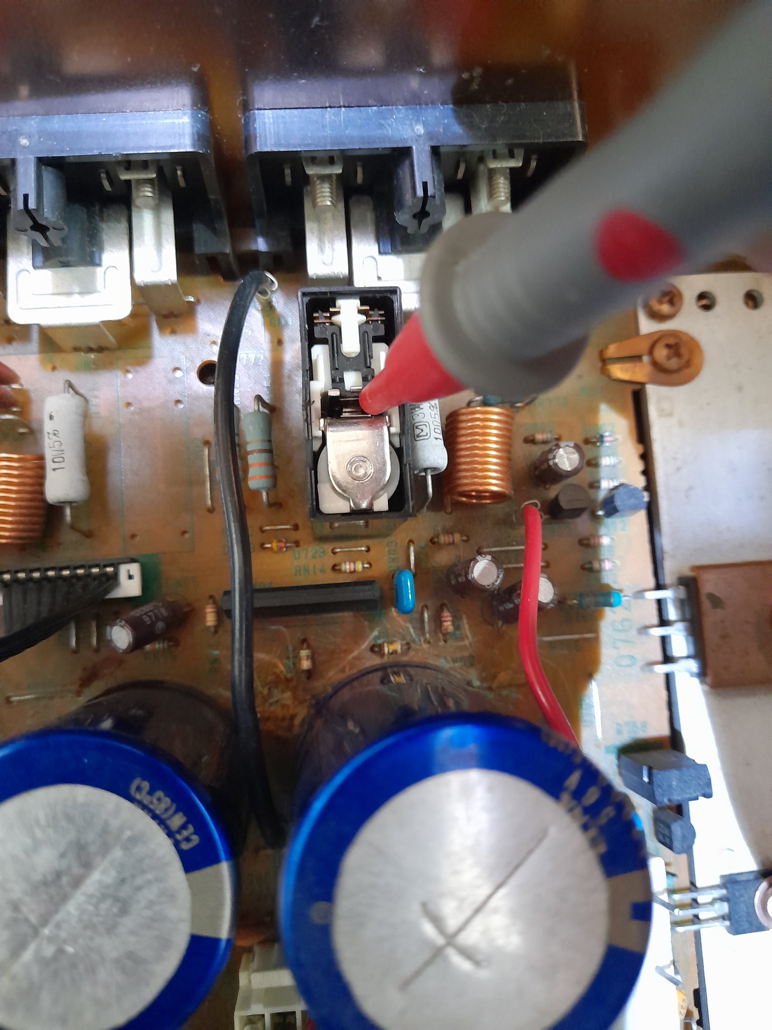

Measure the voltage between the heatsink and each end of DN03 (yellow box) and post the results.
And, as requested by other contributors, please provide the voltages on the centre pins of R767 & R768.

The history is that the guy who owned it thought the volume pot was dodgy and the area of the board around both power caps was covered in that corrosive glue. When cleaning it off with isopropyl alcohol I scratched the board accidentally. I had a normal PM66 that's why the left cap is shorter. I swapped that one out.
I'll test the DC offset tomorrow but fairly certain it was 3 to 4mv area.

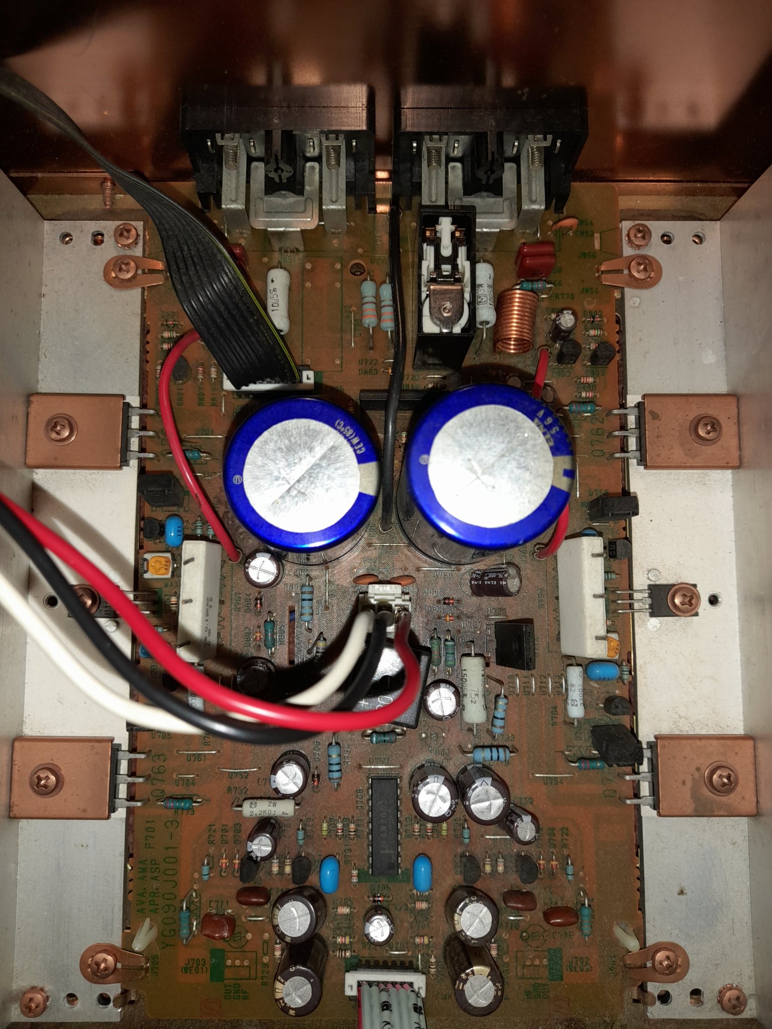

If the DC offset indeed turns out to be only a couple of mV, the speaker protection circuit should not keep the relays open, however, if that corrosive glue damaged the resisitors near those filter caps, it could be malfunctioning. That SIL chip probably is the TA7317 speaker protecion IC. Checking those components would be the next step.

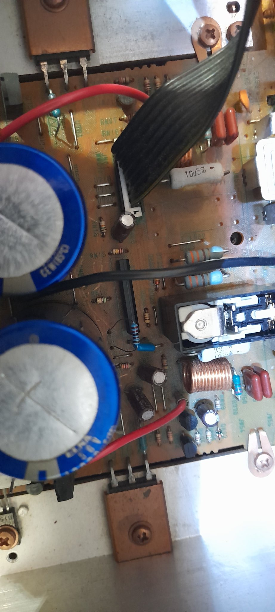

Here's what I've noted so far today. 10.1mv on the center pin. DC offset was around 00.2mv. RN12 is open.
It's working! I put in the first resistor I had to hand and it came back to life. So the glue had worn away RN12.
Thanks to everyone who helped! I'll find out what value should be there and put the correct one in at a later date.

That's a pretty common occurrence when the glue goes acidic and eats away that the components it touches.
I believe the main PCB is the same as the one that went into the PM-40SE I once had, of which I have the service manual.
If that resistor is designated as "RN12" on your PCB, then it's a 100k resistor that should go in there.
Putting "any resistor at hand" in could have blown up your circuit. Better turn off the amp now.
The colour coding of that resistor you put in reads to me as an odd value, whichever way around you read it. Either 1k1 or 151 Ohms, and both are way too low.
Edit: I found an abbreviated version of the service manual for the PM-66SE KI and it confirms RN12 to be a 100k resistor.
