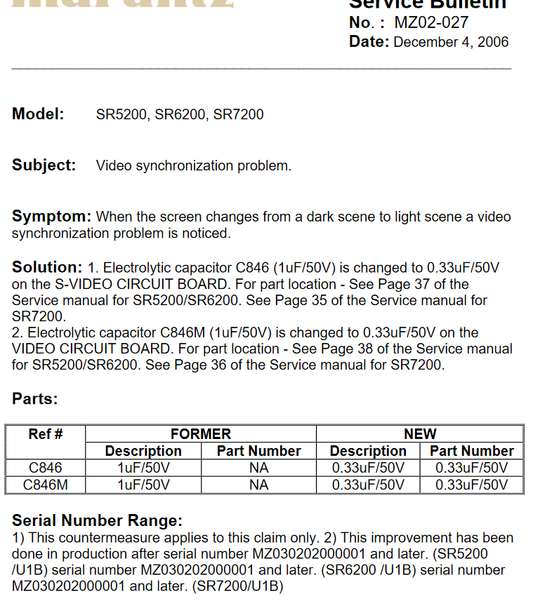

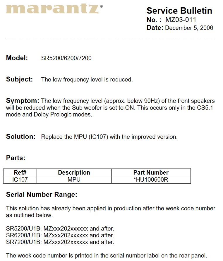

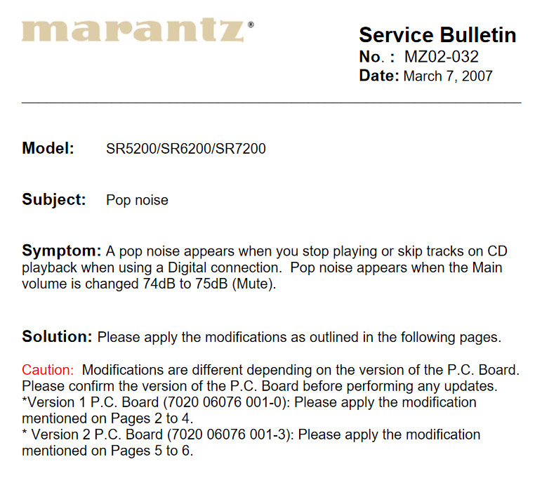

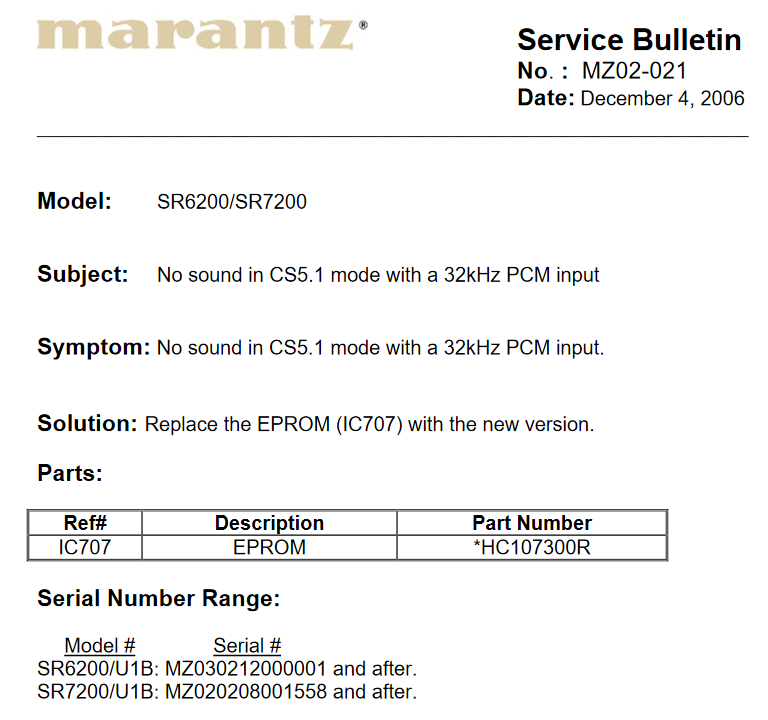

The bulletins are attached but I can tell you none of them are relevant.
