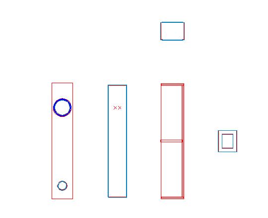

Avoid middle, simetrical bracing. Lower that some 3 ins.
and add a second 2 ins bellow the driver. So there's two bracing and no affecting. Cheers.

Don't forget to account for the volume of the braces in your total internal volume calcs as well.
I am.asking the factory why he suggested to add the bracing. Will.update later. I think its not because of the construction issue. Probably he afraid the box will have unwanted vibration
What factory? Are you preparing these for mass production?

Not for mass production. I should write workshop instead of factory. I cannot handle the wood work myself.

Bracing is suggested in post #65
The bracing should run vertically. Do not use “standard” window braces, they ar enot nearly as effective and tend to disturb the TL.

I remember Jim also mentioned bracing is not really needed for 3/4 inches thick burchy ply wood. I cannot find out which post he mentioned that.
It is big enuff that bracing will help, particularly if the baffle & driver are braced against the back can make significant improvements in box performance despite what Jim has suggested.

Hi all. It's Just there in the post:
"I use 0.75" or 0.50" square hardwood dowels for braces in designs like this one. Typically I cut pieces of the dowel material so that I have a ring that links front to back and side to side of the box. The first internal brace should be located 1-2" below the driver cutout. This mitigates any excess pressure around the driver and is located near the top of the box as well."
Anyway thanks for clarification. It saves some extra work.

Dowel helps but is inferior in terms of what is trying to be achieved vrs a brace that connects 3 or 4 panels (ref Tappan). ie push potential resonances up in frequency such that they are unlikely to ever be excited when you are playing music.

I have calculated the port length. It should be like 5 inches in my case. What if i use a longer tube? Would it affect the overall balance? or it just produce a lower bass?
