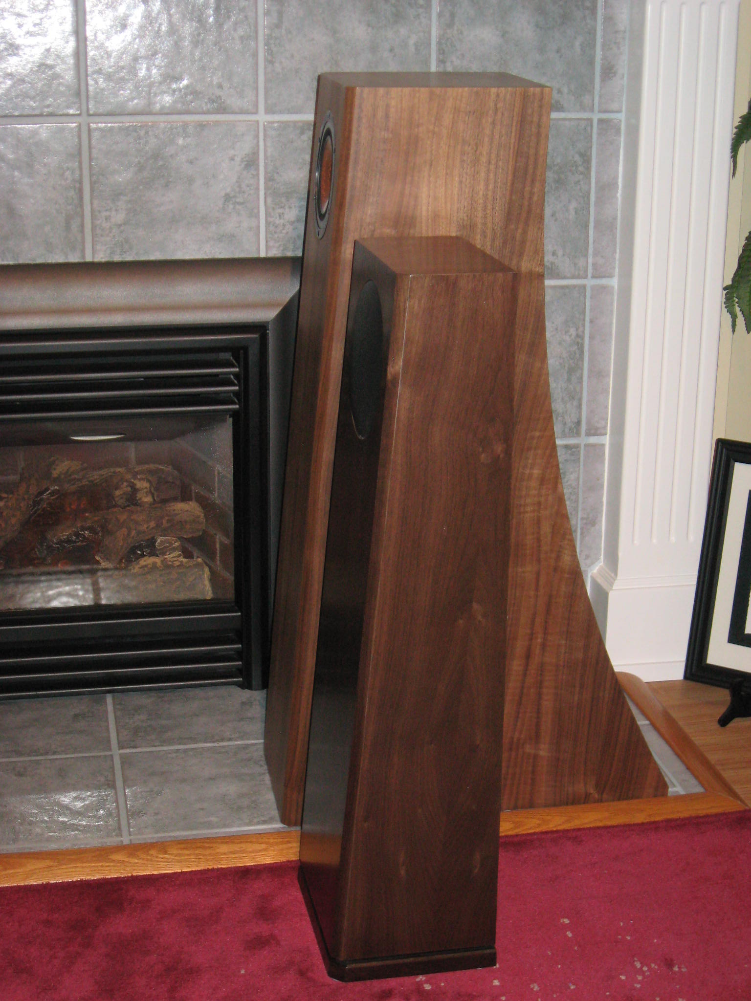

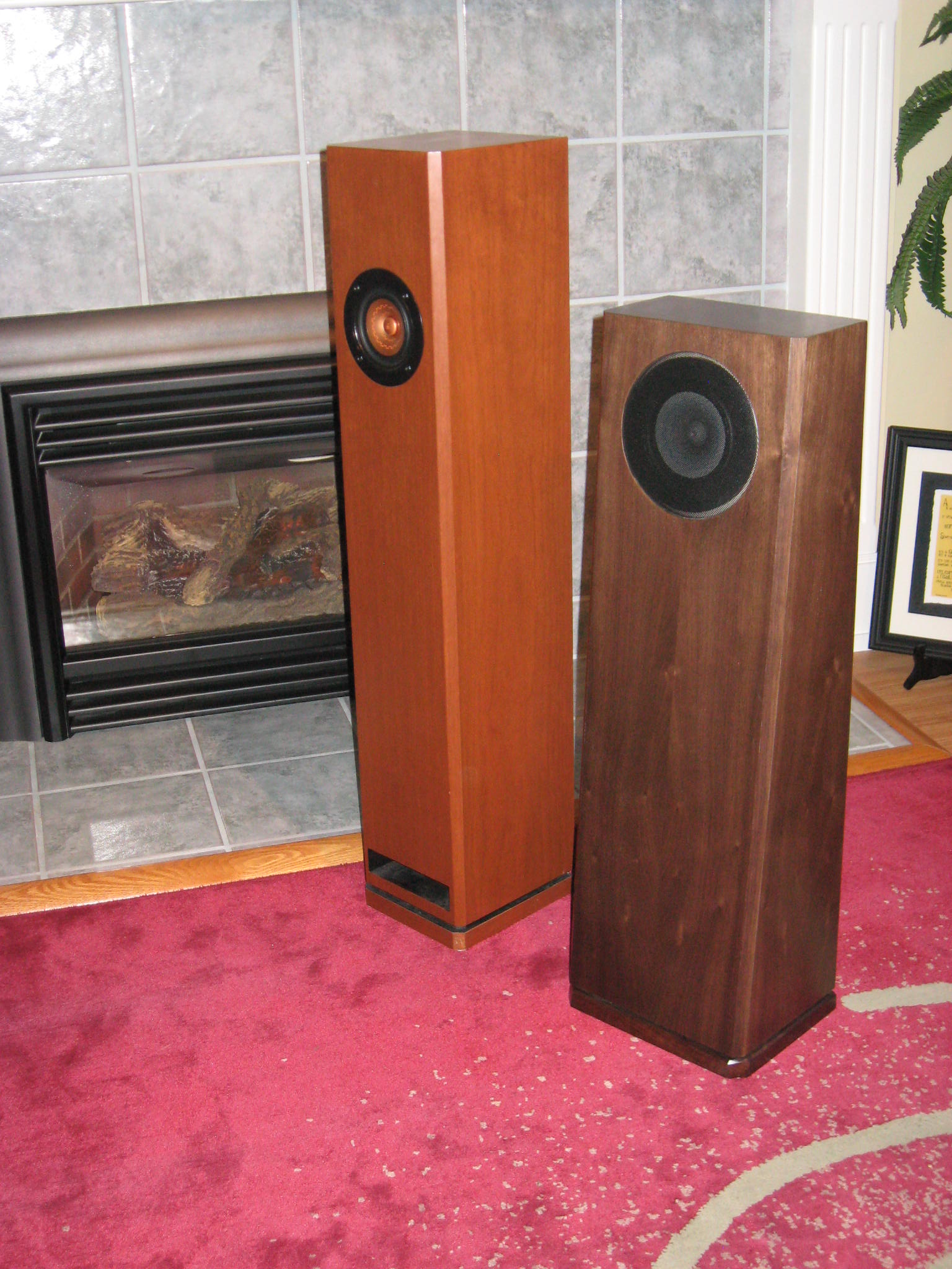

A few more photos re "scale /dimensions" FHXL10P , Pensil7, MarKen10X
Now, as to "sonics" - after a couple of sessions with all 3 enclosures shown, including both 10.3 and 10P in the XLs, I was only able to come to one conclusion - regardless of your preference for metal or paper, if you have the floor space for the horns ....
The A7 definitely has something special going on in terms of low level detail/microdynamics/DDR whatever you want to call it, and sense of depth of image. As probably mentioned elsewhere, on initial audition of the 10P and 10.3, I preferred the former, and indeed upgraded the front row 3 of my small video system with the smaller enclosures pictured above. However, after a second listen to a carefully broken in pair of 10.3, I'm not so sure I'd as heartily recommend one over the other.

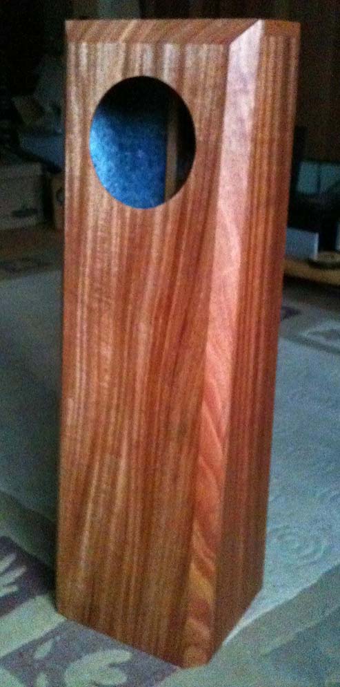

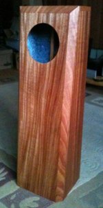

FF165 floorstanders
Although it'll be awhile before these are completed I thought I'd post a picture anyways. I built these with the port bottom firing and towards the front for something a little different. The baffle is solid 1 1/2" mahogany with 3/4" solid top the rest is MDX plywood ( 3 interior ply's of wood outer ply's of mdf )
Not sure why the picture got rotated but maybe Dave can fix?
