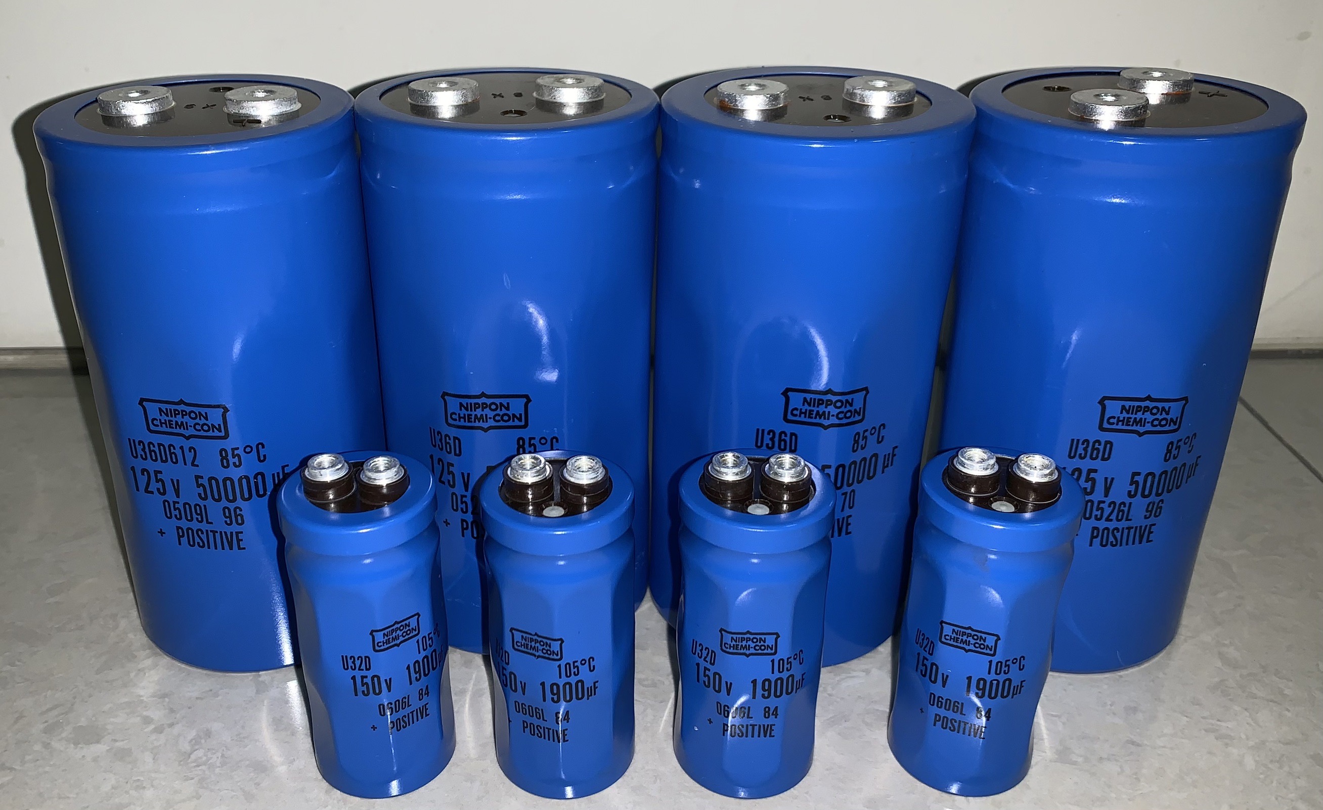

@willcycle: Thank you so much for your response. I will do that component change. Meanwhile: After I pulled the amplifier from its position I noticed quite some fluid underneath, possibly electrolyte. So I am going to dismantle the amp today and check for the source. Would you know the preferred capacitor brand and series for replacements inside an ML?
Thanks. I posted a new thread about capacitor sourcing. Unfortunately it looks like that (at least in the U.S.) the major suppliers only offer the same brand with that rating (50,000uF/125V): Cornell Dubilier. As that brand capacitor failed in my amplifier only after seven months of operation I would prefer a different brand. Even this one is back ordered 14 weeks...

It is almost as if you got a lower grade black caps in your 333 after revision.

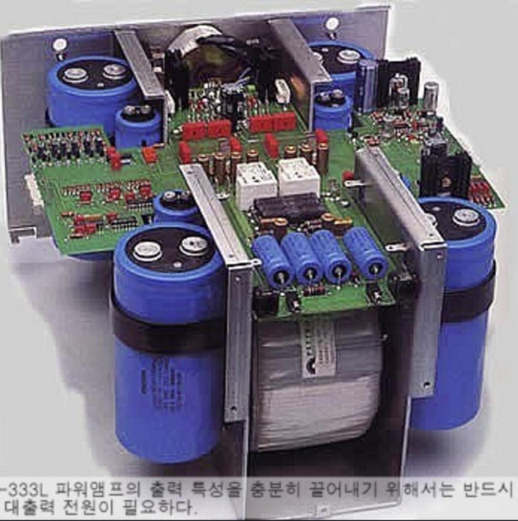

In the image below you can see a 333 with the trusted 5000hr lifetime blue caps.
These blue Cornell Dubilier caps are still available, but not exactly the 50.000u/125V, but I also don't know what the original value was, was it indeed 50.000uF/125V?

A 45.000uF 160V with 76mm diameter would probably fit and perfectly fulfil it's duty.
Do you know the voltage on those caps, I would be careful to lower the specified voltage.
