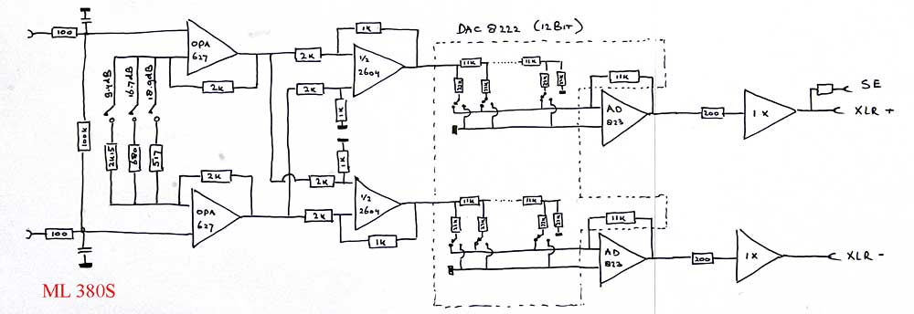

I am looking for Mark Levinson 380S schematics or a list of component changes so I can do a DIY upgrade with my 380 preamp. If anyone has either please get back to me. Thanks so much!

I'm not sure you are correct. I believe the opamps and output transistors are different between the 380 and 380S.
