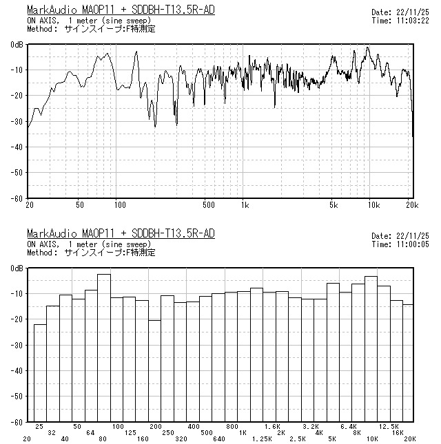

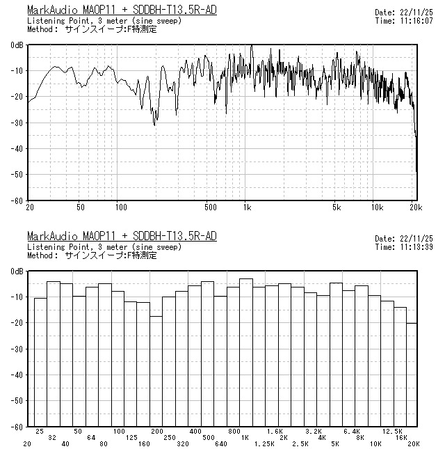

MAOP11 + SDDBH / Frequency Response (ON AXIS, 1 meter & Listening Point, 3 meter)
The microphone position for air recording is 0.5 m in front of the listening point.

- Full Range
- MarkAudio MAOP11 + SDDBH-T13.5R-AD (Dual Back-loaded Horn adding adjustable Duct, no sound absorber)
