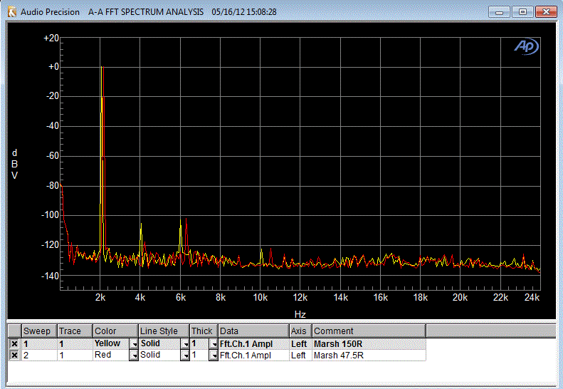

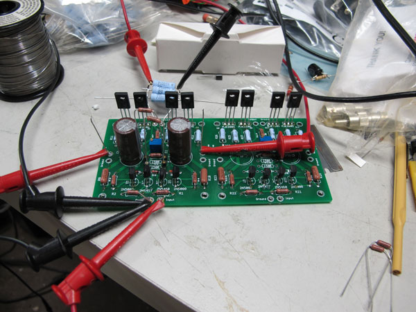

Boards arrived this morning. I could probably tweak this up a bit by matching the input JFETs. The values of R3 and R4 aren't specified in the article, so I used some machined female pins and inserted values of 47R5 and 150R to see what an FFT would look like:

The above was into a 250 ohm load -- similar to my Sennheiser HD-650's -- tomorrow i will run the amp into the "worst case" 30 ohm load.
The DC offset changed by only a milliVolt after a few hours which is very good indeed. The output transistors should be happy bolted to the chassis with the appropriate insulators.
I don't know if I'm going to run it off a wall wart and a couple of DC-DC converters, or make up a quiet push-pull switcher.
This would probably be a tremendous line amp if A=10.
...edit...and the bandwidth is much greater than suggested in the article.
