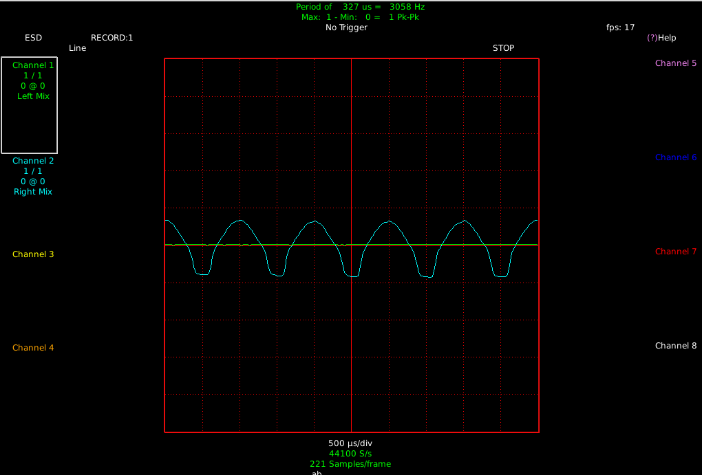

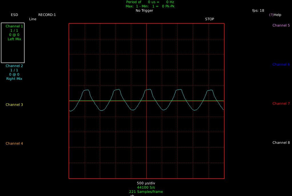

I am expecting to get at least 12V clean out of this amp into 8 ohm load before it starts to clip.
With a 20mV 1kHz sine wave input and the volume about 3/4 (250mV feeding the PI) I should and do get 6V going to the grids of the power tubes and this should give me max output power (I think) BUT I am only getting around 7V out to the dummy load and this is when it starts to clip (only on one side of the sine wave).
I took some screen shots of the clipping. One is of the normal channel showing one side of the sine wave clipping on the output, and the other is the tremolo channel showing clipping on opposite side of sine wave.
Both screenshots are taken with the volume maxed out. Signal voltages taken at power tubes control grid and speaker output.
Normal channel G1 left tube 11.6V and G1 right tube 12.35V output at resistive load 10V
Tremolo channel G1 left tube 10V and G1 right tube 9.5V output at resistive load 9.5V

I am starting to think this is a output transformer problem, it's a Mercury Magnetics and pretty sure it costs an arm and a leg but at this point I don't see it being anything else.
You can test it by removing it and applying AC voltages to primaries and monitoring the secondaries. You should see reduction in secondary voltage scaled to primary : secondary ratios.
