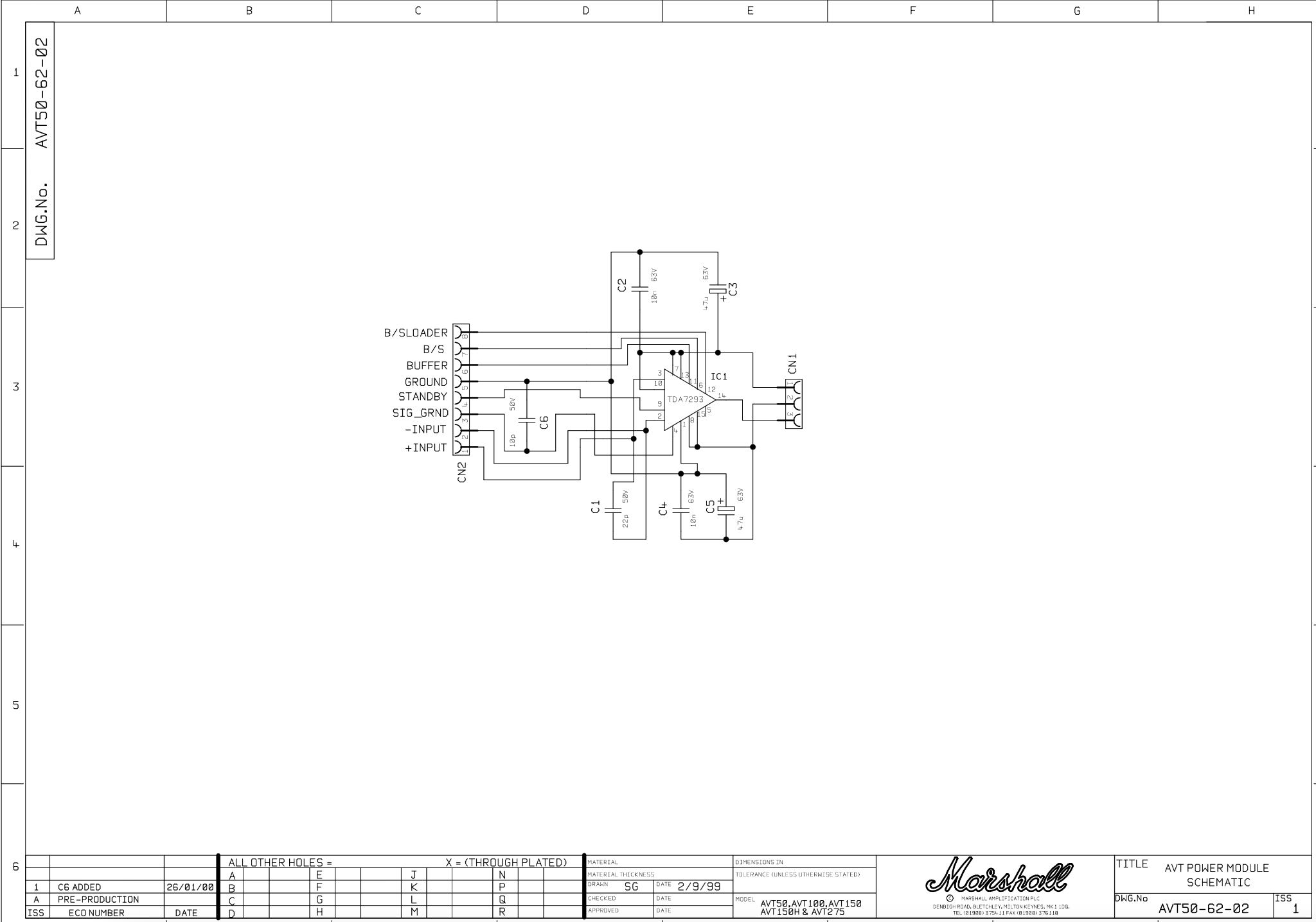

Bought a AVT150H
Upon first use only the clean channel worked.
Now i opening up to look at it and the TDA7293 chips have been replaced before and have failed again. One looks to have let out smoke.
I amp hoping to replace the AVT50-62-00 with a class D power section. If anyone can assist me with this undertaking.
Can these even be done? Thanks!

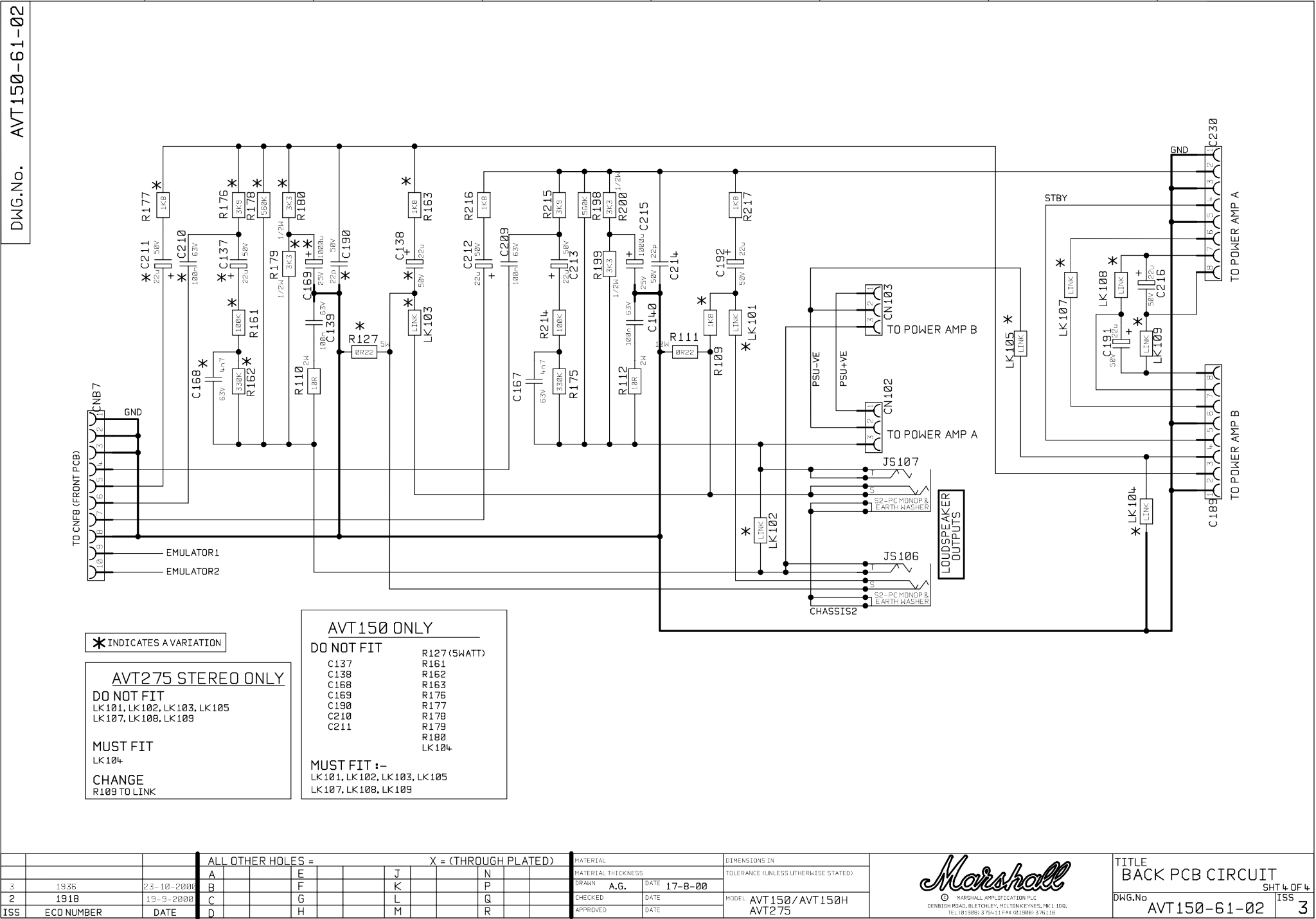

Here is the schematic.

Modifying the TDAs to class D sounds like a recipe for disaster.
If you fit TDAs from fleabay, they will fail.
Purchase from a Ti distributor like RS Components, Mouser, Farnell etc.
Here is the schematics of the TDAs and power side.
Buy these instead of cheap fakes. How much is your time worth?

This is it. There must have been a reason for these basically rugged chip amps to fail. It's also hard to imagine that a renowned company chose unreliable designs and components that aren't apt in their products.
