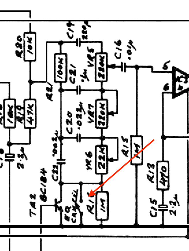

Hi @Enzo, I have spend some time with the unit and tinkered with the controls. The amplifier was mounted into the chassis and warmed up for approx. 10 mins. No instrument connected. Footswitch was connected (without it the both signal routes boost and normal are active).
"Normal" channel
- without E.Q engaged for boost channel the amount/volume of buzz does not change when turning the controls (only regular background noise goes up)
- with Gain (E.Q push-pull) potentiometer pulled forward = E.Q is engaged for boost channel, buzz is lower with master volume on 3 and returns back when master volume is on 7
- buzz lowers when I stick cable do the effect loop RETURN jack
- buzz comes back to initial level when I connect SEND/RETURN with jumper cable
"Boost" channel
- buzz is equal like in normal channel when master volume is on zero
- buzz is lower with master volume on 3 and returns back when master volume is on 7 (E.Q enabled and disabled)
Also when the amp was on idle for some minutes new issue occured. Intermittent popping. Single pops, small groups, or even bursts. Some small transistor turned noisy? Already freeze sprayed them when I was looking for some bad solder joint and they did not popped during the test.

@nigelwright7557
1/ Poorly screened input circuit. -> could be (hum lowers when the preamp is bypassed via effects loop, indicates that the cause could in preamp)
2/ Poor smoothing and decoupling capacitors. -> all were changed, and the new ones were measured before installation
3/ Magnetic coupling from transformer to circuit, especially input. -> could be, but how to improve this one?

with no plug in the input what do get across the tip and sleeve positions for resistance?
do you have the means to upload pic's?
is your AC source grounded?
i once neglected proper hardware and failed to notice that the pot was bridged by the chassis...
The pots are working, detailed measurements of each were not performed. On pot was replaced for smaller variant by some historic repair, I have measured only that one, it looked ok.
But I should probably return to them.
What pics would like to see exactly?
AC source is grounded.
Ok. Will try to make photos tomorrow.
What exactly do you mean by across input jack? Resistance between positive signal contact and ground? Without jack sticked in?
