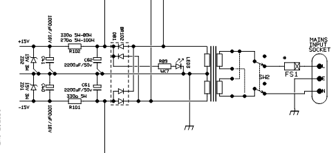

Hello! I've just got a Valvestate 8080 for a decent price (a good deal, but not cheap) and unfortunately found out a bit too late that when turned on, with nothing plugged in and all knobs to 0, it has a constant, relatively loud buzzing sound (my fault for buying without testing!). The buzz goes away when the loudspeaker is disconnected. I've tried a few outlets too but no luck.
I took the head out and cleaned all the pots with contact cleaner but that didn't do very much (though it's probably good maintenance anyway). Visually nothing seems to be amiss, but I know very little about electronics and amp repairs. One thing to note maybe is that the transformer doesn't appear to be original.
Is there something obvious I should try? This happens on all channels, with a guitar plugged in or not. On similar thread (here and across the internet) people suggest to replace the valve but I'm not sure it's the issue since it happens even on the clean channel which as I understand doesn't use the valve.
Could it be the power supply/transformer? Is there something I can look at that involves minimal soldering? (I can do it, just not very confident with an iron that's all!) — I guess what's puzzling is that it disappear when the loudspeaker is disconnected...
When turned off, it also gives a sharp pop sound. I unplugged the reverb and that seems to fix it. Any way I can get the reverb not to do that?

well if it's not that one of the diodes in the bridge rectifier is bad then it's the usual problem of bad solder joints on the power resistors that are feeding the low voltage supply for the pre-amp stages. it's a bad design if you ask me those dropping resistors run smoking hot because they're dropping a whole lot of voltage as they are taken from the high voltage supply (R 101,R102 330 or 270 ohm depending on whether it's an 80 or 100 watt model) and the solder on those gets to near the melting point. if the amp is played hard turn off and moved or subjected to shock those solder joints will fail!!
i still have an 8080 which i repaired by using a separate transformer to supply the low voltage.

@turk 182 Thanks for this, I have to say, I am mostly clueless about electronics. I've located R101 and R102 and from the top they look solidly anchored and not moving. I can't seem to remove the board (couldn't find any videos online and working out on my own, I found 3 plastic pins but even then, it wouldn't come off) and sticking my phone on the side didn't offer up much more insight.
@JMFahey The buzz is through the speaker and doesn't respond to any control. The only way to remove it is to unplug the loudspeaker. Does that help?

First susects are the main filter caps - either the caps themselves or the solder to them.

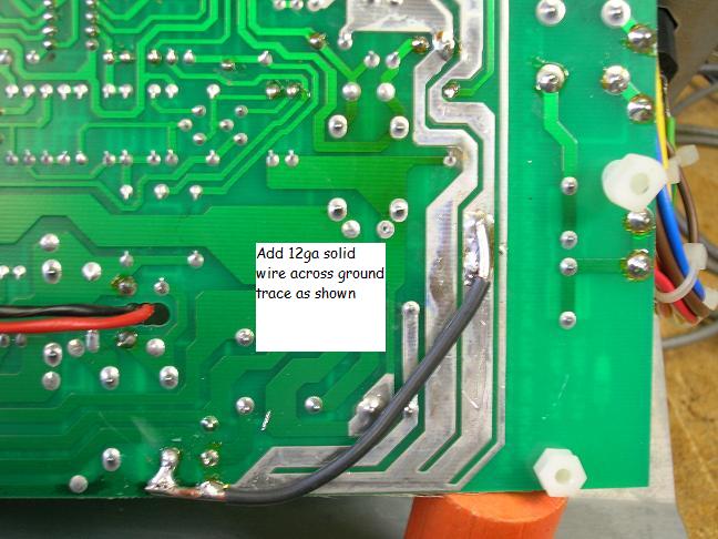

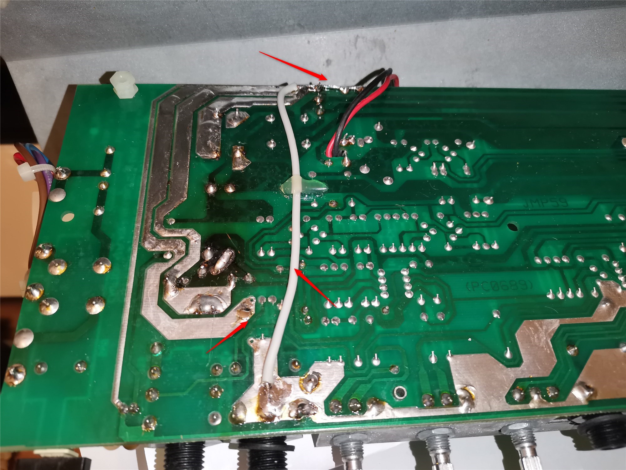

Maybe it's a late answer, but I had the same experience with my 8080. It seems hum is not caused by malfunction, but rather poor PCB design.
I could significantly reduce hum by creating new ground path for the preamp section:
- I removed original jumper from PCB
- Added a new grounding wire (solder points on the top of the picture were also bridged)
ZD1 and ZD2 (15 volt zeners) and C40 and 41 (1000 mfd 16volt which are too low in voltage rating for duty here imho) are often bad and much of the preamp sections noise problems.
Hey @kikikaka I am trying to do this same modification to eliminate the buzz in the same amp. Could you tell me what you mean by "remove the original jumper" here? Which jumper is that? Do you mean from the PCB to the chassis on the input jack side?Maybe it's a late answer, but I had the same experience with my 8080. It seems hum is not caused by malfunction, but rather poor PCB design.

I tried this ground workaround from another forum - similar to yours - but it didn't do anything for me.
