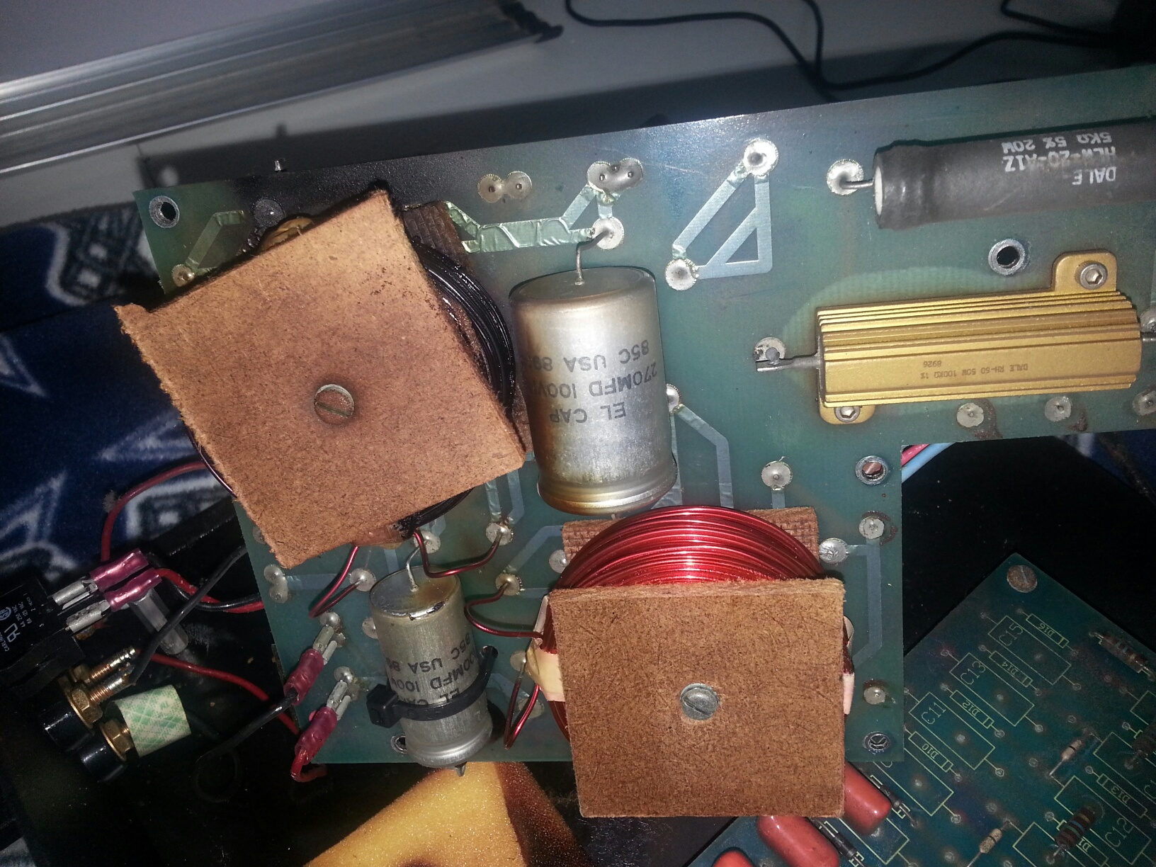

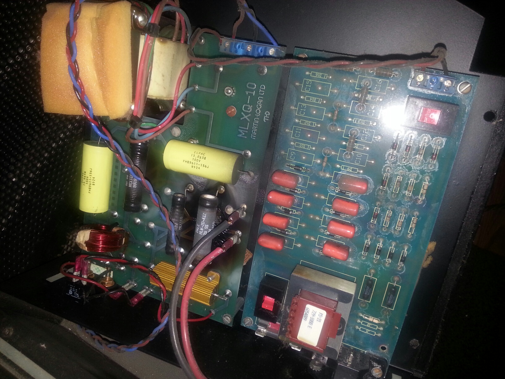

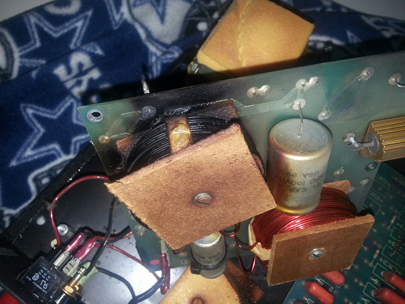

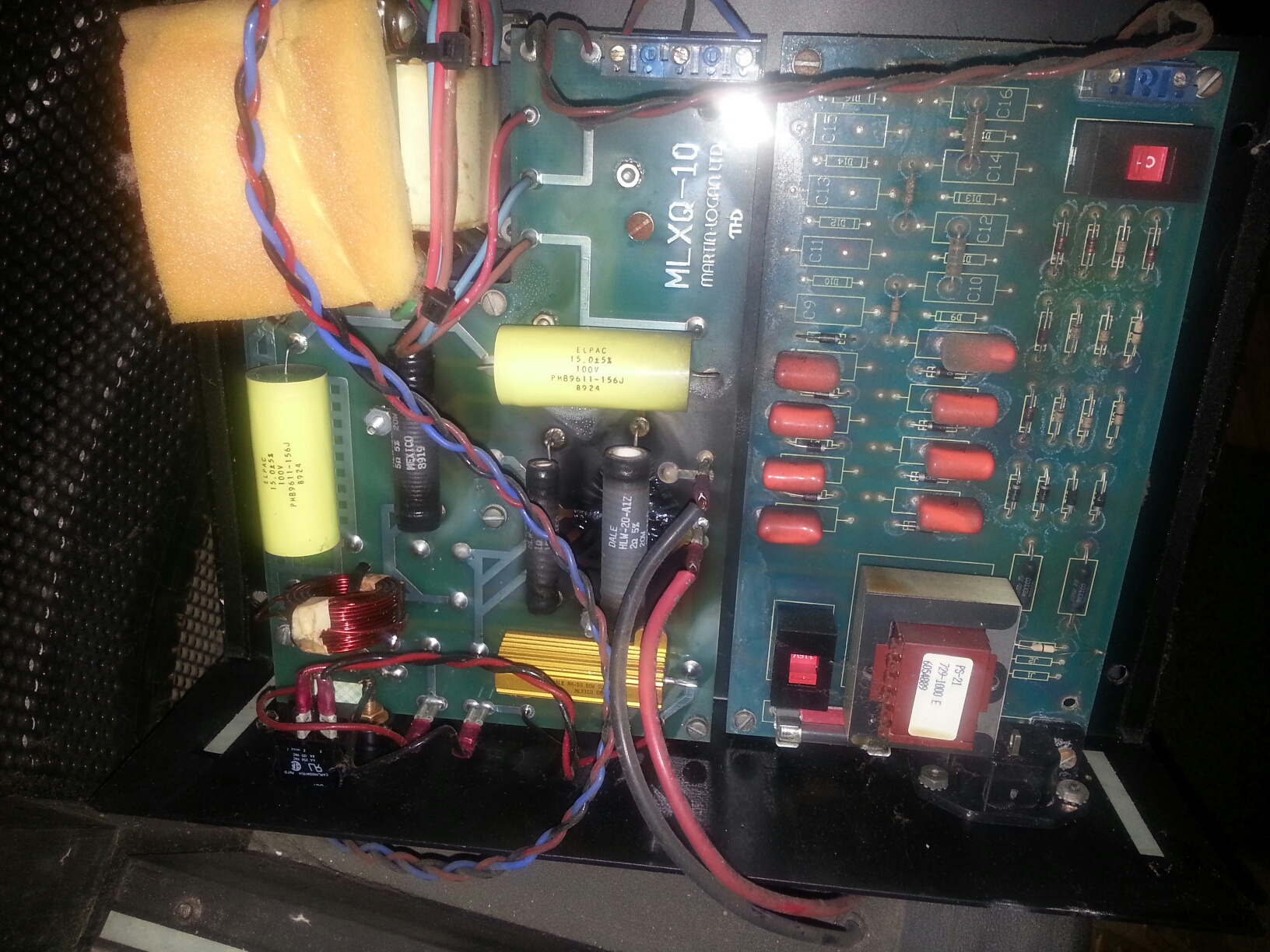

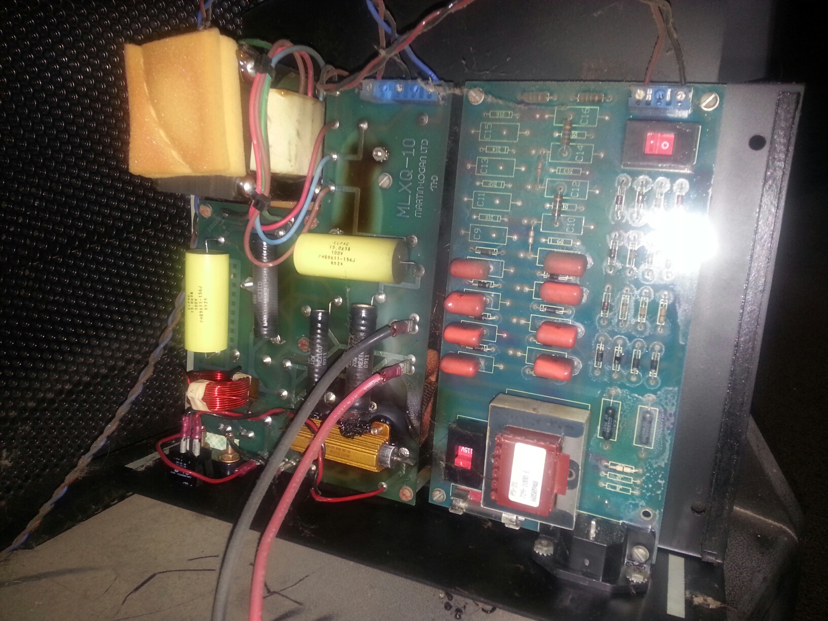

I purchased a pair of ML Sequels II recently for $160.00 knowing that they did not work properly hoping that I could fix them. I heard these a few times and have always loved them. I was not able to audition the speakers prior to buying but look good on exterior inspection...woofers fine, membrane had no rips and looked pretty clean. when I got home, I plugged them in and only heard sound from the woofers. I waited a few hours and looked inside the back metal plate with the electronics...very dusty and what looked like several burned areas (see pics). As I researched these on this forum, I notice that a couple of you recommended some cap upgrades/mods. Thinking I had nothing to lose, I ordered the caps and replaced them according to the step-step instructions. I then tried them again and no more sound came from the panels. I will be calling ML directly soon but am afraid that replacing panels and/or electronics may be more expensive than I would like to pay, I have and additional $100 in caps into these already. While I know understand that the mylar membrane made need cleaning or replacement due to coating wearing off, I should hear some sound. This makes me believe that I'm missing something. The back plate is separated into two sections (crossover with transformer and possibly a power supply section)??? While I have very little experience with electronics, I'm wiling to learn. I understand that the panels need current in order to work which makes me think that the power supply part is not working??? need help/suggestions.

Looks like the bias is out............if there is No bias... all parts well cook....an get vary HOt..like yours look!
Any amp can be driven into clipping.........to the amp...with out bias.. it looks all most like a dead short!
you need to start cking the res....see how far off sec thay are....but with out bias the panels well no work.......... or make sound......

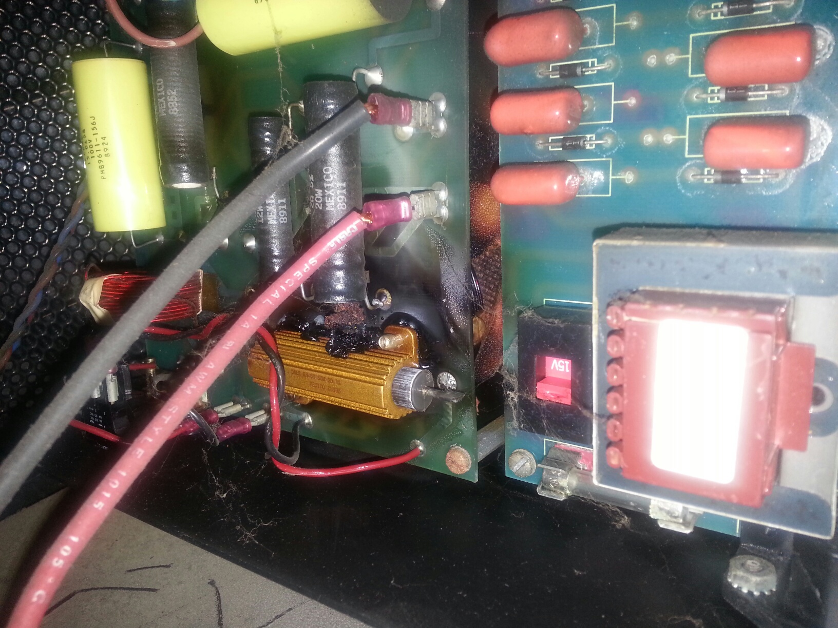

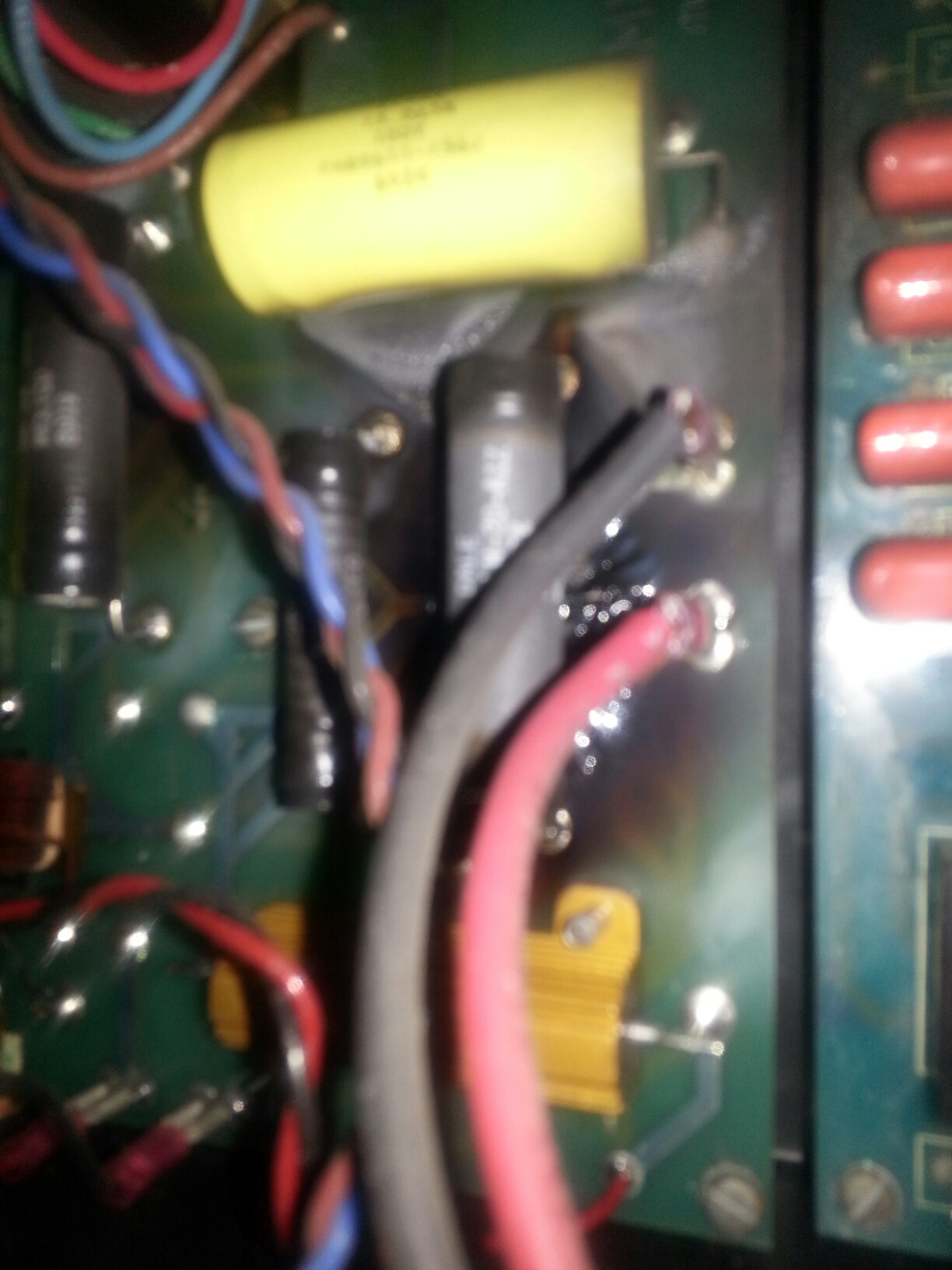

I assume that the first 5 pics are from one ESL and the second 5 pics are from the other ESL?
If so, both bias supplies (the PCBs to the right, containing only fewer smaller parts) seem to be the only subassemblies that survived the butchering.
Sorry, but it's beyond my head how someone could push a speaker over its limits as it has been done here. 😕
It must have smelled terribly awful.
The amount of destruction, debris and dust also lets me assume, that the owner must have had the attitude of a mass murderer 🙄

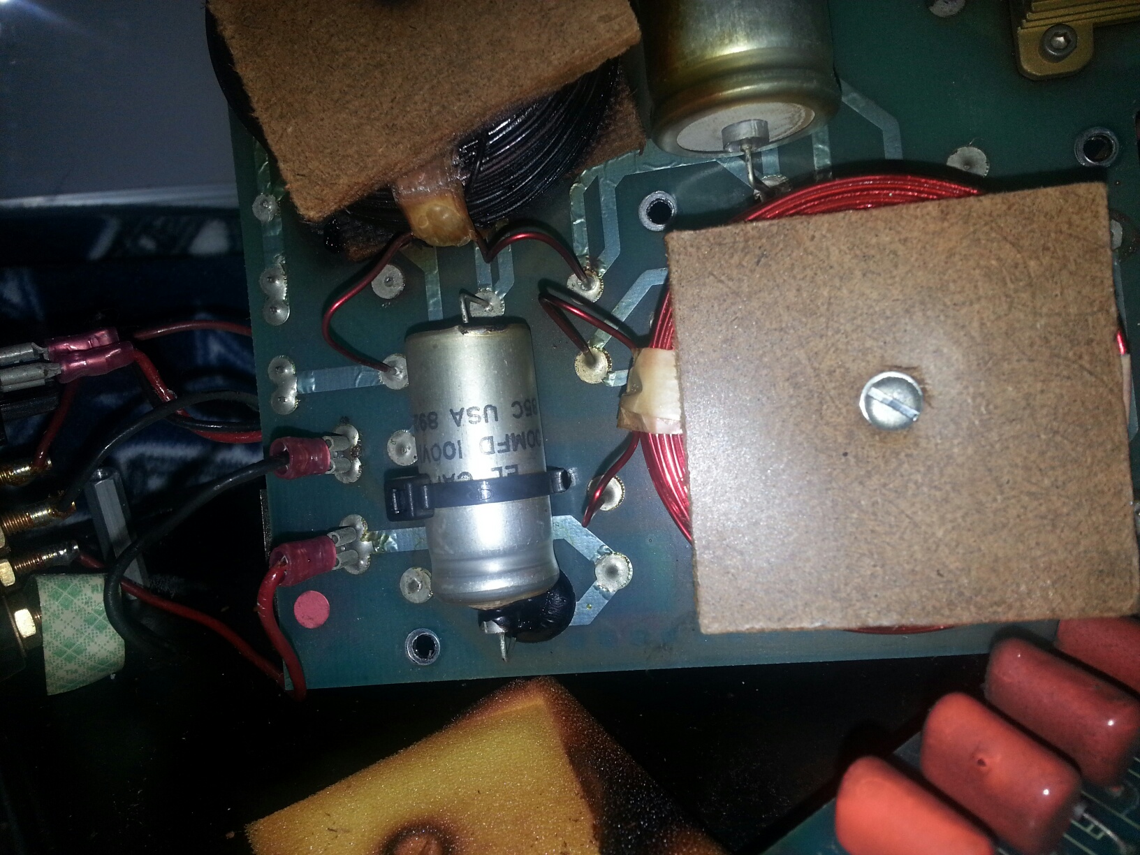

Anyway, looking closer at pic 6 the color of the grey-black tubular resistors indicate overheating and possible destruction. Also the copper traces in that area look deformed and delaminated from the PCB.
The inductance mounted right below this area is clearly carbonated and most certainly defect.
With Your restricted knowledge I suggest to rather get complete replacment boards.

Yes, that could be as You suggest, but then he must have had a helluf too much bass. Wonder that the bass drivers an the ears survived the treatment.
So I'm not yet convinced that the bias has been lost, i.e that the bas supply failed.
With all that debris it could be massive leakage at the panel, or breakdown of the diaphragm coating.
I also woudn't rule too much partying stress and constantly clipping amp impossible.
Anyway, the test procedure should clear a few issues.

Lots of good info and suggestions. Because I don't have much to lose, I'm going to try washing my panels first and if that does not help or helps very little, I may attempt to recoat them very carefully. If the coating is done correctly and they still don't work, I will have to assume that it is an electrical issue. I may also try some electrical testing/troubleshooting with a multimeter that was suggested earlier in the thread. I'll keep everyone posted and I just want to say what a wonderful group of folks you all are to take time out of your busy day to help me with this project. Win or lose, I want to thank you all.
Washed and hooked...one works and one does not. Will try switching panels to see if panel is the issue or electronics. Even so, my amp just shut down from overheating when I was using a manepan mmg on the right and the working sequel on the left?? Weird. I thought it may have been my new amp...monster dbx bx1 stable to 1 ohm. I tried my other amp which has always powered my maggies well (parasound 1500) and it did the same thing. ..overheated...does not sound like an amp issue. There must be a short or something going on in the electronics of the sequel. ..I felt the back plate and it was cold...not even warm? The amps, however, were hot. One step forward and two back....any suggestions?
I forgot to mention that the working sequel was blowing my 4 amp fuse in the back of the new amp that seemed sufficient for my maggies...first clue that something was wrong. My other fuse ( on the maggie's side) did not blow. Could there still be water in the panel causing this to happen... I blew out the water with my compressor on both sides then vacuumed them with my shop vac on both sides? Could the issue be that I have two different types of speakers hooked up to the same amplifier? Again, looking for a suggestions.
if you have NOT replacet the bad part in the crossovers........... can be dead shorts...no amp like to drive a short........... the amps well die....... ....stop!
you art just testing.............i would never run any amp tell parts are all ck.......changed!
Tyu
I replaced most if not all the caps in the working sequel. Also, I replaced the little gold colored part with groves on the sides (may also be a cap). Fixed a couple of traces which seemed broken but my soldering is not pretty. Even so, I did not see any wire or trace touching something it should not be. I'll have to check again. By a "short," you mean something is touching something it should not be touching. ..in simple terms? Or am I way off and I should be looking for something different?
In one of photos, you can see one the spools of wire (I think that is part of the crossover) that was very toasty...I did not replace it as it look like the wire was intact. However, I fixed a trace under the spool that was broken from the heat. I feel like I'm close yet so far. I also would like to apologies for my limited knowledge on basic electronics and terms. If you guys are patient and break it down like you are talking to a 10 year old, I may be able to diagnose the problem. Thanks in advance.
