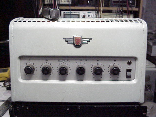

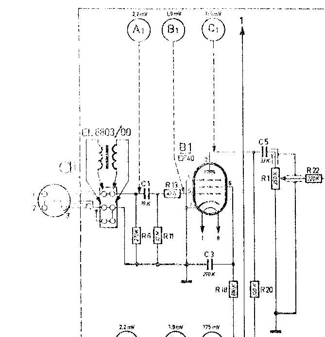

I've got this classic Beyer M55 microphone and would like to wire it correctly to the mic input of the Philips EL6431.
Microphone comes with three wires and a shielding, amplifier mic input has the three plugs, hot, cold and ground.
Full schematic of EL6431 here.

That was quick. I'll wire the hot to hot and see how far I get with grounding the other pins.

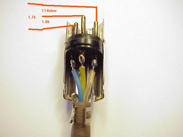

changing beyer m55 din plug for xlr
Hello,
iv'e just picked up an old m55 and want to rewire it with a male xlr connector to replace the 3 pin din.
It is identical as the picture above with a three core cable plus a shield. How should I wire this to the xlr ? Other mics I have wired have used to a two core plus shield. Do I need to bridge the pins, or wire the shield somewhere else?

Had a mess about with the wires and all is working now and sounding nice!
Realised that connecting either the blue or white wire to xlr pin 2 decides the hi or low impedance, the other is not used. White lo, blue hi.
