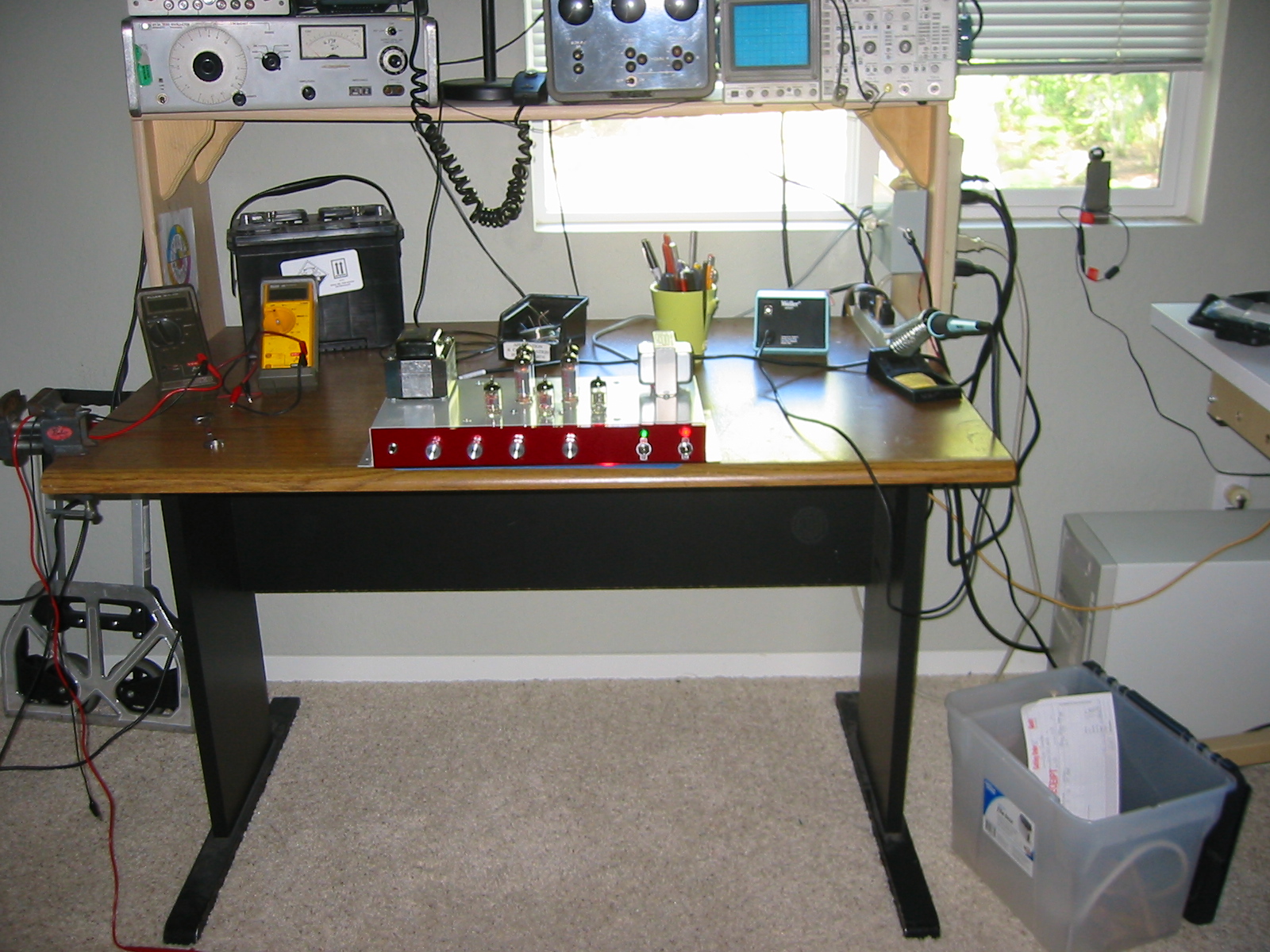

The current through the common cathode resistor is I=11.2/120 or 93.3 ma, devided by two is 46.7 ma per tube. I think thats not so bad. If p=.046 X 348 then each tube is disapating 16.0 W ---- I would like to hear from other on this because I have thoughts of trying a EL84 guitar amp.

I don't think there's much difference in sound with a colder bias, my cathode resistor is 150 Ohms.

Cassiel- I honestly didtent read the date on that first post😕 That just goes to show not much has changed. Here is my latest project. Quad El84 amp. Let your friend's story be a lesson to us all.

Not rude at all. I know that class A guitar amps is are a myth. Why would you even want a super clean, distornless amp anyway? Here is a link to my earlier efforts

and thanks for posting . Tube coice is kinda limited, I need to stick with current production output devices, So for now JJ's are my tube of choice.
