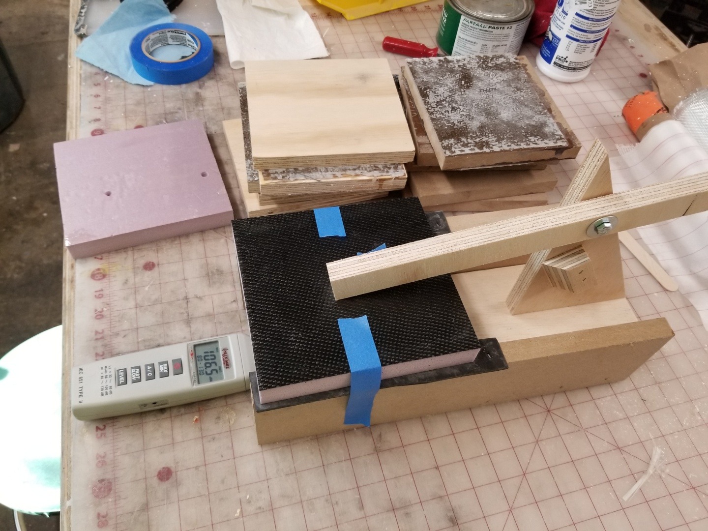

I have been planning to build a speaker with a carbon fiber skin for awhile now, but every mention of using carbon fiber in a speaker cabinet is followed by doomsday type statements, with people saying that it's just really bad.
My gut response is to dismiss those comments, but I decided it is worth researching and testing before I commit to it. Carbon fiber is definitely not common, but I have found 2 examples of speakers using carbon fiber in the cabinets. One is a studio monitor with a carbon fiber skinned front baffle, and the other a high end speaker made from carbon fiber with aluminum honeycomb core.
The plan would be to apply a "skin" of carbon fiber over a cabinet after it is made. The questions I have are: Is it better to skin the outside only, or skin both inside and outside? What is the difference between skinning MDF vs Plywood? And how does a carbon skin compare to a hemp skin? Hemp is promoted as providing "damping" to a composite, and damping sounds good in the context of a speaker cabinet.
To test, I made a bunch of samples of all the combinations I am interested in. They ended up being 6"x 7". I put them in a test jig that "taps" them equally, and I measured the max SPL for a single drop. I took a bunch of measurements and averaged them.
The test jig is pretty simple. It has a board that lifts up against a fixed stop, and gravity swings it down. I set the test pieces on a thin foam strip to prevent rattling against the test jig. This made the results more consistent and repeatable.
Results:
Plywood, bare ACX 3/4": 108.93dB
Plywood with carbon on 1 side: 96.36dB
Plywood with carbon on 2 sides: 94.62dB
Plywood with hemp on 1 side: 105.61dB
Plywood with hemp on 2 sides: 98.5dB
MDF, bare, 3/4": 102.9dB
MDF with carbon on 1 side: 109.8dB (back side impregnated with epoxy b/c otherwise it will warp from moisture)
MDF with carbon on 2 sides: 102.88dB
MDF with hemp on 1 side: 108.86dB
MDF with hemp on 2 sides: 101.38dB
1" extruded polystyrene foam board bare: 110.4dB (taped down so it didn't bounce on jig)
1" extruded polystyrene foam board carbon 2 sides: 106.93dB
I also observed that the resonant frequency of the samples changes when adding the different skins, as one would expect. Tapping bare MDF makes a lower pitch than tapping bare plywood, but adding 1 layer of carbon to the MDF makes the resonant frequency roughly the same as the bare plywood. Adding the second layer increased the frequency again, but only the equivalent of a couple notes on a musical scale.
My takeaway at the moment is that nothing bad happens when you cover plywood or MDF with carbon fiber. The resonant frequency increases due to the panel becoming more rigid; the same thing happens if you put your bracing closer together. It also appears that common pine plywood is a good choice to use with a carbon skin. MDF seems to be more resonant with a skin, possibly because the resin soaks into the MDF and changes it's properties? And the foam didn't do particularly well in this test, which may be due to the fact it is so light weight that it bounces out of the test jig.
I may do more experiments. I was considering using carbon fiber with an endgrain balsa core material. That is denser than the extruded foam, but much less dense than plywood or MDF. It is rigid and light weight, and my guess is it is probably better than the foam.

Interesting. You could try kevlar, which has higher damping than carbon - either as the skin alone, or laminated with a layer of carbon too.
I didn't try kevlar for aesthetic reasons. I don't want yellow speakers! I do have some Kevlar laying around, though...Interesting. You could try kevlar, which has higher damping than carbon - either as the skin alone, or laminated with a layer of carbon too.
As far as damping, I believe the hemp has the highest damping of laminating fabrics. So the damping of kevlar would be less than the hemp.
I don't think either hemp or kevlar would effectively "damp" a panel. The hemp increased the resonant frequency, it did more to make the panel stiffer than it contributed any damping.

I think you're describing "constrained layer damping"? Two materials separated by a viscous material that limits transmission of vibrations. It is a thing. However, the effect will depend on the materials chosen, and it is well beyond what I'm trying to do! You'd have to find products made specifically for the purpose, and construction may be a bit challenging.I would go for choosing one material for stiffness and another to provide damping, stiff materials are usually very resonant. Stiffness and mass can reduce the response to stimulus, and their ratio (plus geometry) determines resonant frequencies, but only a lossy material can improve damping to quell those resonances. Elastomers are often used for damping as even a thin layer can provide a lot of effect especially in a laminated structure. For instance the three thin rubber layers in a cricket bat handle absorb a lot of shock/vibration from the impact that would otherwise transfer to the players hands.
The premise of my post was to see if a carbon fiber skin will ruin a speaker or have some negative effect. It isn't much of a test, but it is enough to make me think that it'll be just fine!

I have thought about a laminate using balsa core material. It would be cool, but in my test the plywood covered with carbon seemed the best. And it's tougher than balsa, which is important since I'm hoping to use a single layer of carbon. (Using balsa would offer welcome weight savings. The current prototype uses 1.5 sheets of chip board. I tweaked my back wrestling with it this weekend!)What about balsa wood, skinned inside and out with carbon fibre, to make a light, rigid sandwich, with a layer of mass loaded dampening on the inside? This would mean that the dampening layer would be heavier than the stiffness layer, giving more dampening effect.
