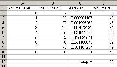

I think we would use 6db steps. The audio we produce is alarms for equipment, so it doesn't need to be that great of resolution. In fact, I think once the volume is set, it probably is never looked at again. So at 6 db, 9 steps would be 54 db range. I think we go up to about 80 dbA. So I would make step 0 be 0 db and step1 be ~32 db and then go 6db every other step.

I think the quoted post is what I am looking for. What equation did you use to calculate the multipliers? I used y=10log(v2/v1). I knew what I wanted y to be, so then I use x = 10^(y/10) and got the values on the attached table. Don't worry about column D, that is just my guess at measured sound pressure.
As you can see my numbers are not the same, so I must of done something wrong.
Not correct. 3 dB down is multiply by 1/SQRT(2). The voltage multiplier is y=20log(v2/v1). Your equation is valid for the SPL.
