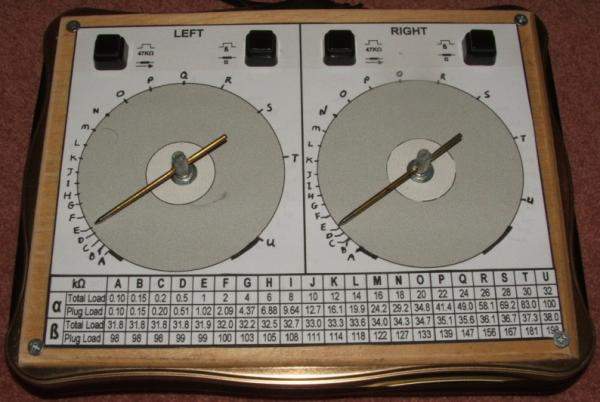

Saw this on the wonderfull WWW...
Of course with any scheme using 'fixed-values'...
...you may just miss 'the sweet-spot' by a country-mile !!! 😡
Saw this on the WWW somewhere.
Simples ! 😱
The guy made 2 precision 'calibrated pots'...dialed in the values...
BOOM !
Job done !
Can always replace the pots with a fixed value if you're worried about them. 😕
BINGO ! 'sweet-spot' found for ANY cartridge. 😎
Smart dude...
...lateral-thinking !
Si.
