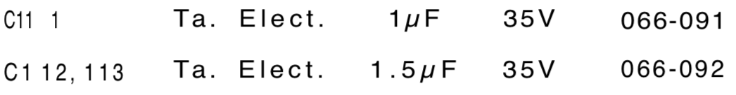

There are definitely more film caps than electrolytics. I count 19 electrolytic in the service manual including the power supply cans and some labeled "Ta. Elect." (any idea what that means?) and 26 Mylar. What can I look for in the part numbers to know if the electrolytics are the long life grade? I would hope they are at this price point!

...some labeled "Ta. Elect." (any idea what that means?)...
Tantalum Electrolytic.
Tants were very fashionable many decades back. At the time they were smaller and less leaky than Aluminum (ordinary) electrolytics. Some said they sounded different (but they shouldn't). Passion has cooled since old Tants tend to blow-up violently, and Al electros have improved SO much since those days. Today I would choose a "LL" (low leakage) Al rather than a Tant.
Thanks PRR! I still don't understand how those are shown in the parts list. It seems like they are repeats of already named capacitors. I'll attach some screenshots as an example.

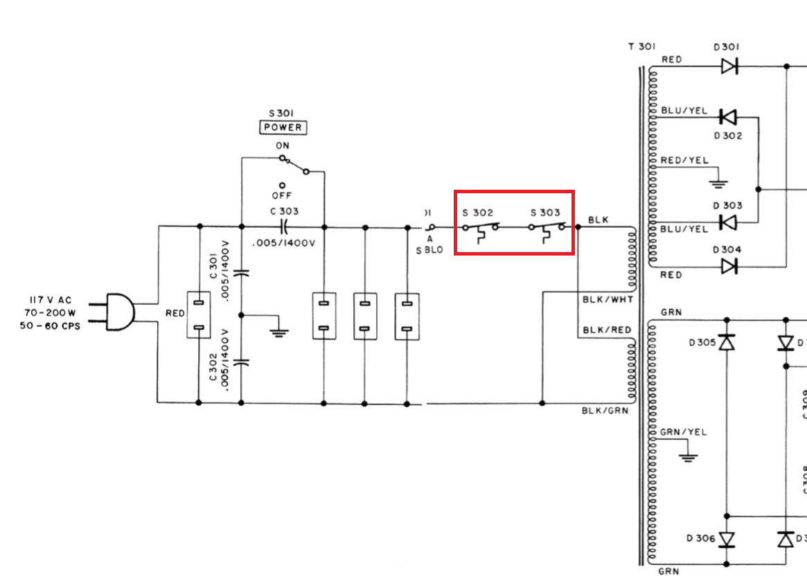

Hello,
Does anyone know the specifications of the thermal cut out S302 and S303 (part number 153-007)?
I ask because I recently bought a unit to restore that is 117V and in Europe we have 230V so to test it I had to use a step down transfomer but it comes out of the speakers a sound very similar to a transformer and I don't know if this can be because of the step down transformer or the amplifier transformer. I have seen the schematic and I see that I could connect the primaries of the transformer in series but I don't know the specifications of the thermal cut out. The only information on them is the following and I can't find anything on the internet: Elmwood Sensors L180 87-5
